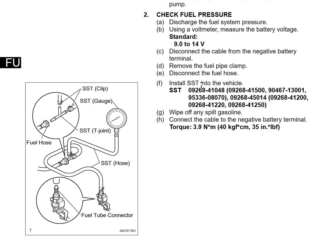

    Make sure you tee into the fuel supply line and do not dead head the pump. The pressure regulation is at the other end of the fuel rail where the excess is dumped back to the tank. If dead headed you will get a false high pressure.

    @Jimmyh Thank you - does anyone have any suggestions for a kit that will fit the fuel line? The nipple on the T is to big to get to secure into the fuel line that has the snap on clap. I didnt want to force it in there but no way it was going to fit. I went and looked at 3 other kits from Napa and Autozone and all had same exact T joint. I must be missing something.

    The below T is on every pressure test kit I looked to rent. It will not fit the fuel line that has the adapter. Also, maybe Im just an idiot and there is another way to get them to securely sit together. Thanks again!
