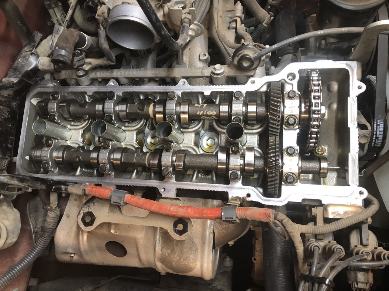

    Valve cover has never been off (until now) and the noise is loud enough for you to make a weird face like “whoa you sure you got oil in it?”. I can’t find anything wrong. Even removed the crank pulley, totally fine.

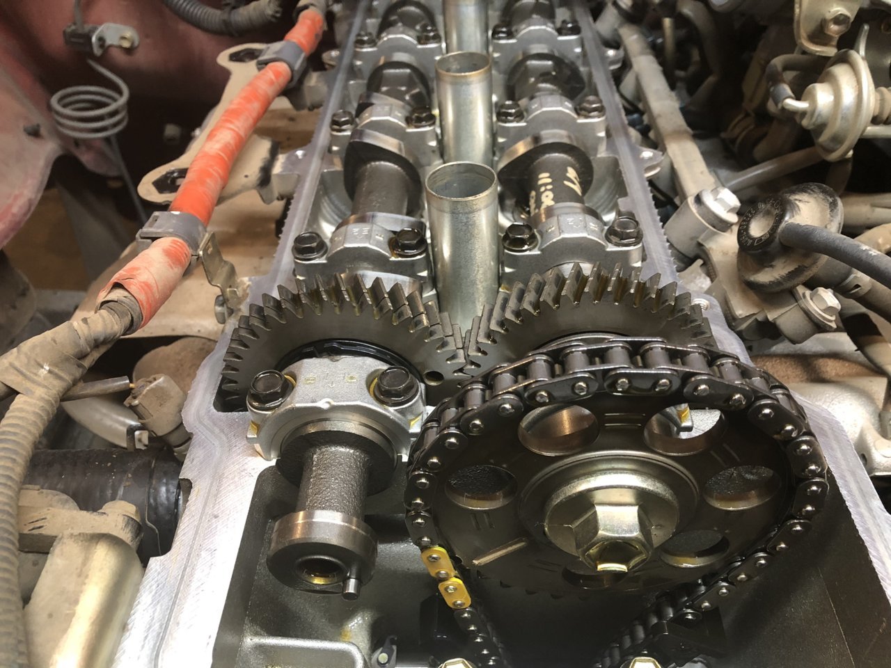

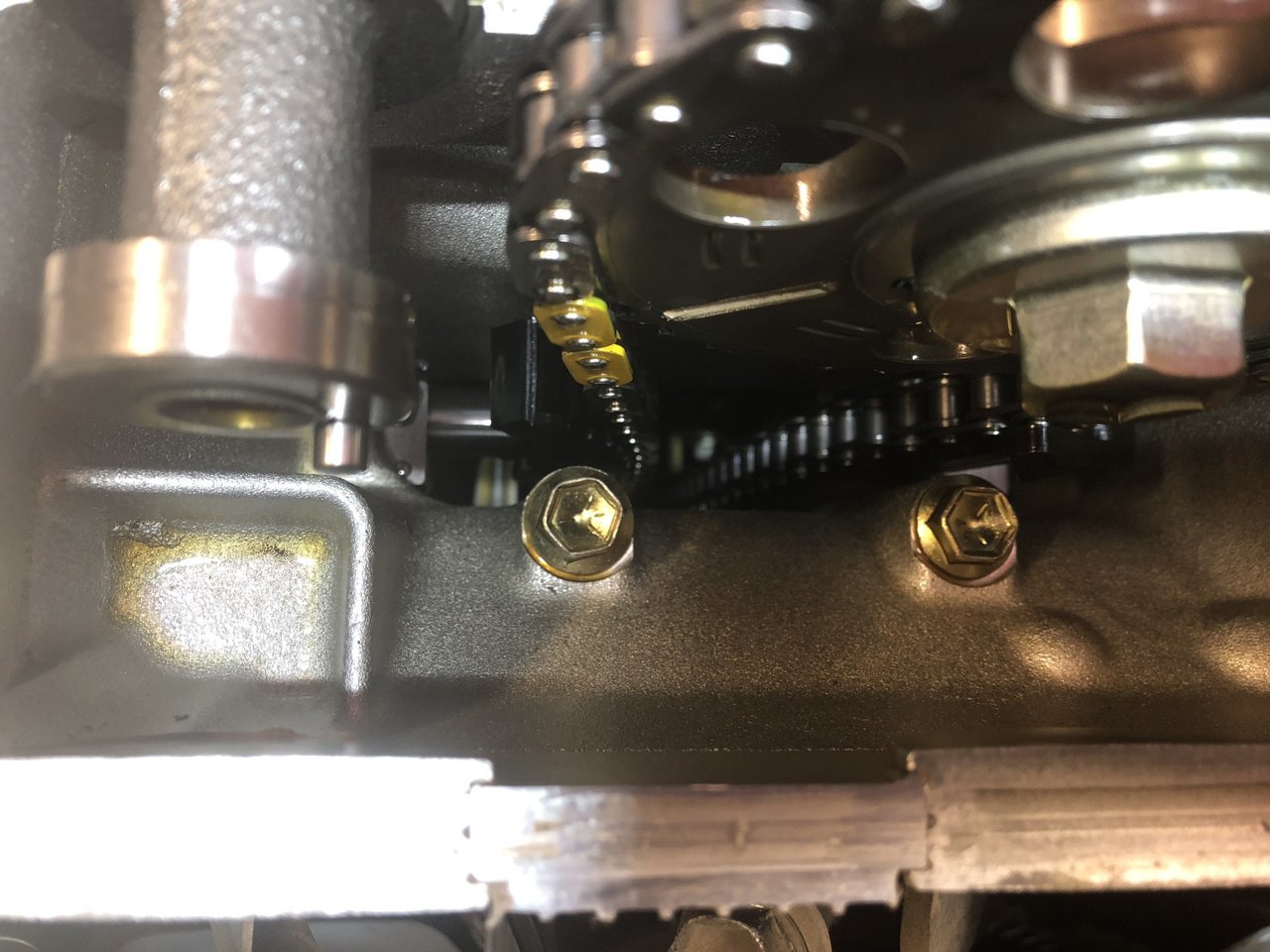

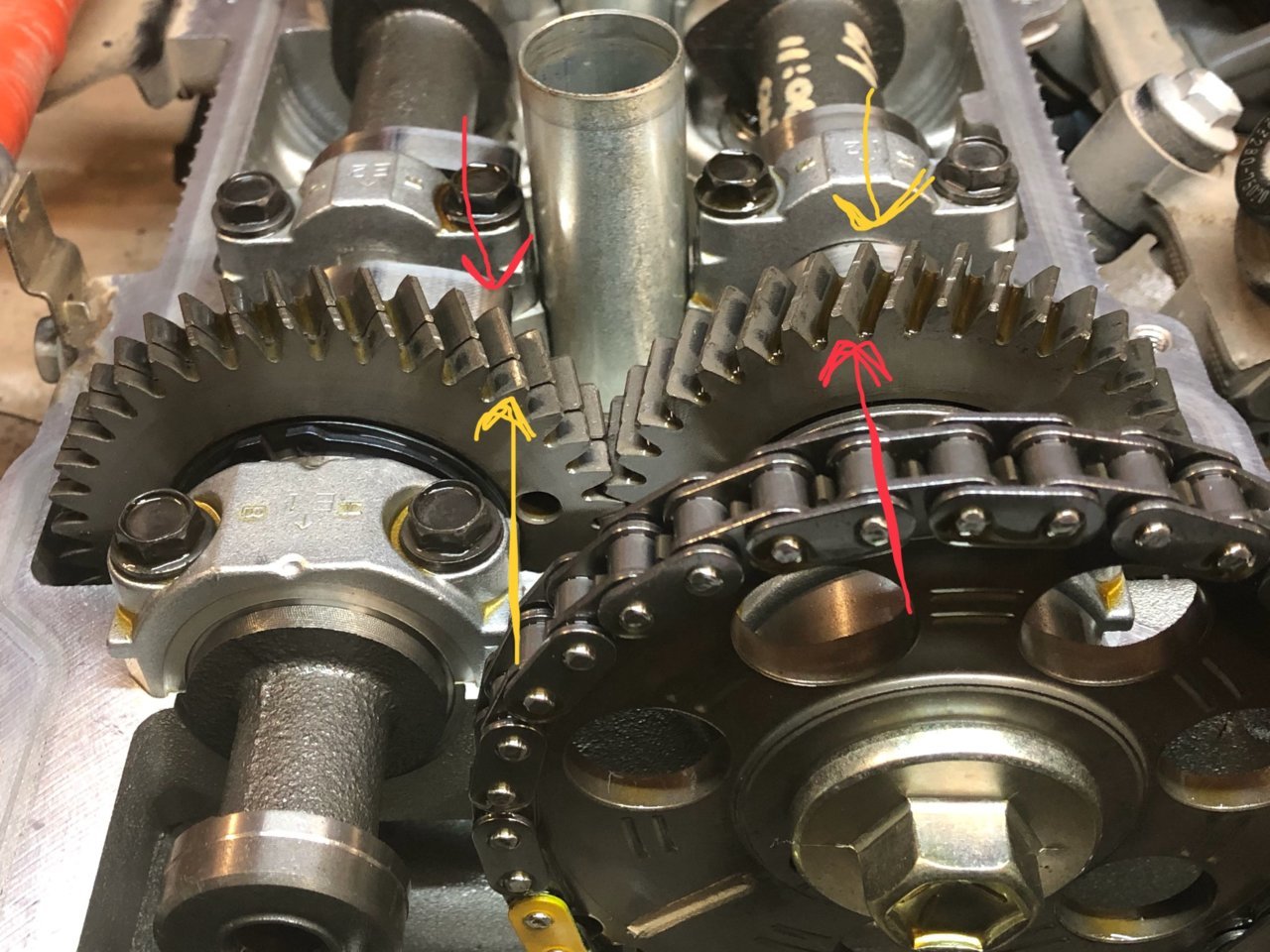

    I did buy (about a month ago) Toyota oem scissor gear spring washer, wave washer and snap ring thinking that was causing it. I didn’t take the exhaust cam out, maybe I should have? But with the valve cover off I tried to move the split gears independently and see how much lash, didn’t notice any, couldn’t move them at all. Now looking at the pictures from the other day I’m thinking I should’ve taken the exh cam out and removed the spring to see if it was cracked/broken. You can see in the picture where there seems to be more noticeable wear like a “heel/toe” on one gear more than the other. Didn’t catch on to that when the valve cover was off.5A405A96-58FB-4B8F-B5B0-259829B2207C.jpg
