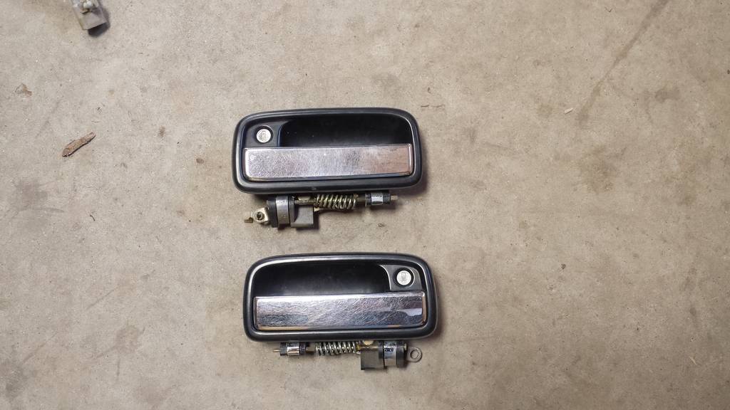

    I have these of 95.5 [​IMG]
    25.00ea plus 5.00 if it's right. No lock cyl. OEM
