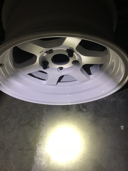

    I went back to 15 from 16 and bought 15x8 +0 offset. Had 16x7 +42 . I didn't like how they tucked so far back in the fender. And the 15" are 100 bucks less each tire. The 15x31" bfg at ko2 is 160ish. The 16" 275/70/16 are 240ish so in the future my tire cost will be less and I have more rubber to help with the quality of ride. Here is a pic of new. Ya there white. I will paint to match truck . They only came in white with the +0 offset. Black is the old. Same style just have a nice lip.
