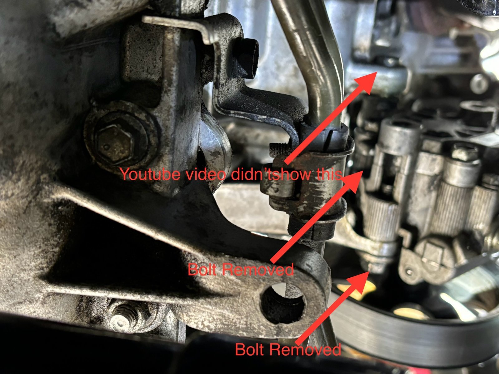

    Hi guys,
    I need your help again!
    I am trying to unbolt and move the power steering pump out of the way so I can see the oil leak behind it. I watched the video below many times and it looks so easy, but the pump wouldn't move at all after removing the two 14mm bolts. I am not replacing the pump so I didn't remove the two hoses. What am I missing?
    https://youtu.be/7GO3os1NQTc?si=a4IxHPYSqjrqPcrD

    This is a picture taken from the bottom looking up before I removed anything.
    The service manual also lists all the steps to remove the pump, but I don't want to disconnect the hoses if I don't have to.

    Thanks for checking, but those two bolts are part of the pump itself and the aren't bolted onto any brackets on the frame.

    @Bishop84 @Nalex I was able to take a clear picture of the BACK of the steering pump. The arrow is pointing to the piece that is holding the pump even after removing the long bolt. Do I supposed to tap that piece with the long bolt just enough to allow the pump to slide out? What's killing me is that the factory service manual didn't mention this step at all.

    This piece is the slider, so its threaded and slides outwards/towards the rad to clamp on the pump.
    So with the pump removed, you thread the bolt in, and tap that slider rear wards to allow clearance for the pump.

    Thank you for the arrows. Tell your kid I said thanks :). The big arrow is pointing to something that’s impeding the pump from getting loose, I can’t tell if that is part of the pump or if it should fall off after the pump is removed. Any idea?

    That part is pressed into pump bracket. With 2 bolts removed grab the power steering hose and rock the pump back and forth until it comes out. Use a little hammer or bolt and tap that sleeve back so when you install the pump there will be more clearance. When you tighten the top bolt it will pull that sleeve in tight. Just grab the pump and start rocking it

    Yes, I initially thought, where the arrow is pointing, there is a nut and tried to grab it with a wrench but there is non. As they said above remove the two bolts and the wire connector and rock the pump up and down while pulling it straight. Keep in mind it inserts there tight. It can get jammed if pulled sideways.

    Thank you everyone for your help. There’s no way I could have gotten it out without your help. Once I understood what needs to be done, I used a long socket extension and tap it from the top down, and finally got it out. Now the real fun begins by cleaning everything (so nasty in there).
