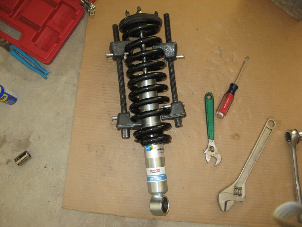

    So I am trying to assemble my stock coil onto a bilstein 5100 shock set at the medium height. I am stuck because Im having trouble compressing the spring since it's off the coil, and since it the bilstein coil is setting it higher, in need to compress it more to get it on the shock and put the top plate on...

    Okay... What kind of compressor do you have? I used the ones you can rent from autozone.

    Maybe its me but ya kinda seem to be all over the map with what your trying to accomplish,ok I see your adjusting. So your coils are off now? If so how'd they get that way ? Spring compressor. The autozone by my house basically let me use it for free just left a $50 deposit, assuming you have it on safely & correctly you need to crank it down somemore to move the clip up to the next groove (or whichever one your trying to do)
    If your asking which sequence the shock grommett goes, pretty sure its retainer (I just call it a washer) grommett,retainer,grommett,retainer So to recap :
    1-retainer
    2-rubber grommet
    3-retainer
    4-rubber grommet
    5-retainer
    6- Big Nut that goes on the top of shock that HOLDS PRELOAD !!

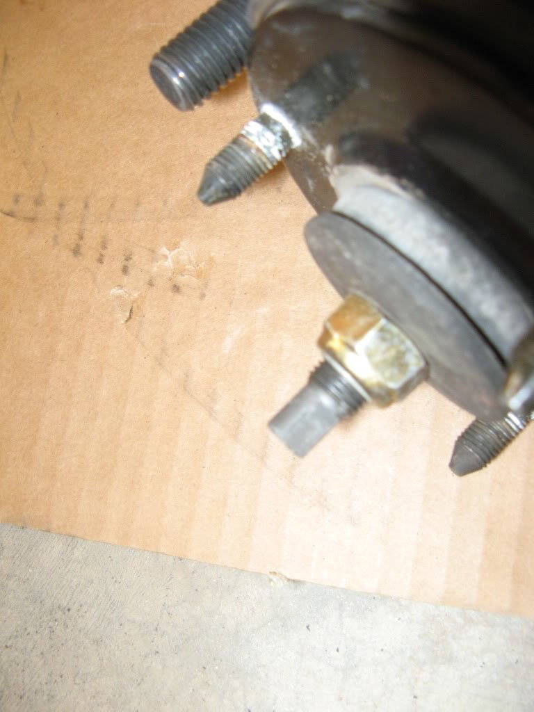

    heres the only pic I have of the top

    I did it! thanks for all of your help, I was having some issues with the plate that sits on the top, somehow dirt had gotten stuck to it, and then it caked a layer ion there so it wasnt sitting flush will post pics soong.
