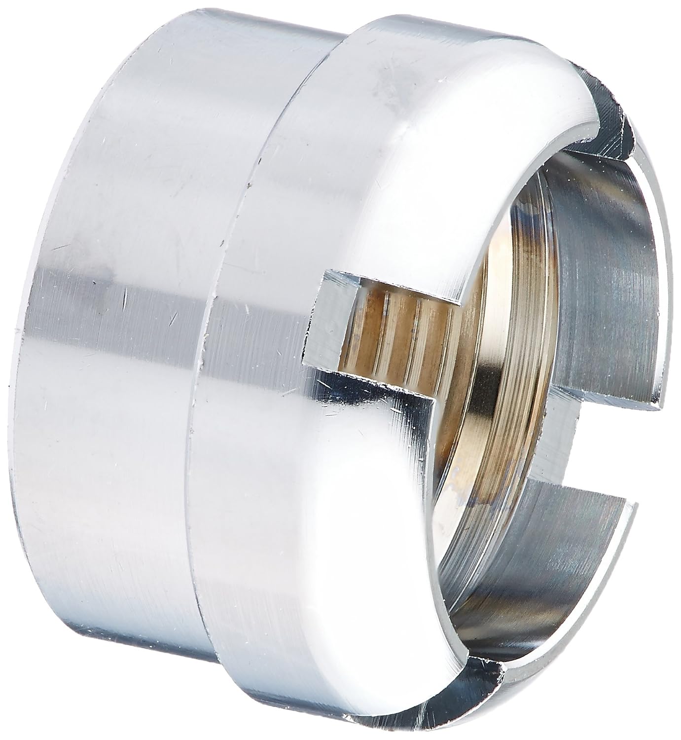

    I was wrong, it sheared off my antenna. the nub of the antenna was stuck in there, so i tried an ez out. My cheap easy out's threads were already beat up from using it a few times (with success). Does anyone have any idea of what I can can do? This is what I am left with now:
    Is the next step to try to remove or replace this nut?
    [​IMG] [​IMG]
    https://www.amazon.com/Genuine-Toyo...id=1521063418&sr=8-39&keywords=tacoma+antenna

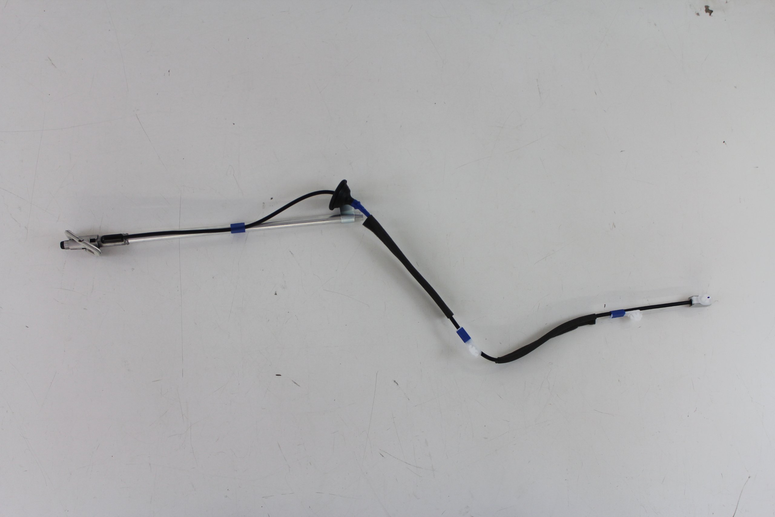

    or do i need to replace all of this?
    https://www.amazon.com/Genuine-Toyo...id=1521153531&sr=1-25&keywords=tacoma+antenna

    Use a new easy out or go ahead with your idea of replacing the nut. It's one of those things that I wouldn't waste a whole lot of time on. Either way you go, let me know if you need/want another antenna. I think I have one somewhere in my garage. If I do, I'll send it to you for free.

    Easiest way, get new nut, new mast, and new mast base (part with wiring). Drill it all out with a bigger drill bit and replace it all. Replacing the base is super easy. The radio connection is in the interior a pillar. So much easier than older trucks where it plugged straight into the radio.

    Hey man sounds like shitty luck!!! So I am an auto body. Almost every Tacoma that I have to work on passenger fender antenna nut strips and splits. So that requires replacing the nut, base, and antenna going to back of radio. The best way I have found to do this is just cutting it off since you have to replace anyway. If you try to get off by turning you will just damage fender. Remove fender liner retainers will probably break aveco part # 14267 cheaper than oem. Then from top of fender start at base about 1/4 up. Angle up cut all they way through. Becareful not to hit fender have done probably 20 times never hit fender. Once it's all the way cut remove 10 mm bolt under fender and pull antenna down. Antenna connects inside cab under passenger upper pillar trim.

    I picked up a generic antenna kit that had a bunch of different threads for different vehicles and tried to tap new threads... didn't work either. It looks like I will be needing the wiring kit and following Tacocat's walkthrough. The big question is when.
