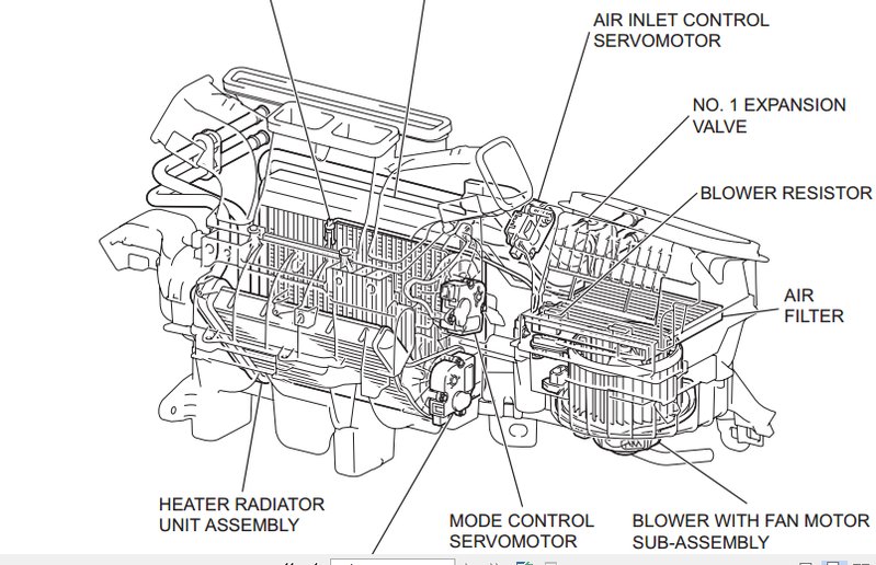

    Hey all, first post, hope you can help. I need to change my expansion valve and cannot for the life of me find it. I assume it is behind the blow assembly, but I can get it out from under the dash. What am I missing?

    It is a monster to get to. It is here between the Evaporator Coil and the firewall:

    Its looking like the whole dash has to come out. How the heck do you get the top dash out of there.

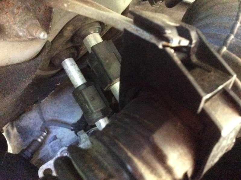

    Expansion valve can be removed thru the firewall. Evaporator is another story.

    That is good to know. Is there a bolted cover over the opening where the lines go to the AC System or what? Or is it just an opening with a seal?

    Just behind the rubber seal is the expansion valve. The valve to connector tube part shown in your cut is what is going thru that boot.

    Well that makes life a lot easier if I ever need an expansion valve.
    Thanks for the picture. I was going to look today, but it is raining.
