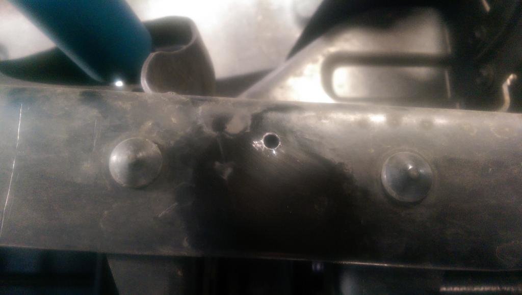

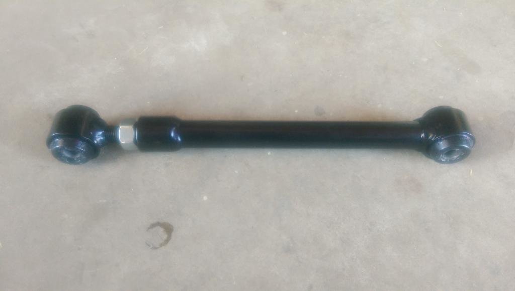

    I installed the hellwig rear sway bar today. I believe the part # is 7887 for those looking for this on a 2014. Install took me about 2 hours, but I wasn't rushing at all; took my time. Couple things that may help with install:
    1)Take the spare off. This allowed me to sit cross legged under my truck to work. I put the spare in the bed so that the suspension is under a normal load during fitting.
    2) Screw the arms all the way together before attaching to the bar. This is where they will sit when you are all finished. Its a pain if you bolt them on and then have to screw them together under the truck.
    3) Drill a pilot hole first for the arm brace into the frame. Its kinda a funny angle to lay and drill a 1/2" hole, so start small and then go for the full 1/2".
    The truck handles much better in turns, but that is what a sway bar if for after all. Overall opinion is that this was a well worth it mod for a S/C taco that is used for 98% street. The responsiveness in recovering out of a turn is really crisp and quick, while through the turn the truck maintains a very flat stance.
