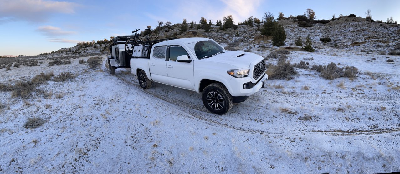

    I respectfully disagree. My rig is completely stock outside of a Hellwig 981 helper and a few other minor upgrades like a catch can and rear seat delete. I regularly carry 300 - 600 in gear (and hardware - leitner rack + pods as well as the decked. drawers), and tow a 2900# off-road trailer without issue. Completely stock save for the helpers. I don't like that the 3.5 V6 has more horsepower than torque and peak numbers are just over 5k but under powered? No. The 3.5 is plenty of motor. Under geared is more like it.
    @LukeLifts you can certainly run a helper, sumo spring, AAL, or stiffer leaf pack and you should be good. You will be working your 3.5L V6 and you need to get comfortable running 4K+ RPMs in S3 over mountain passes. A consideration: you will be limited in what you can upgrade to in the future though which is when I would start thinking about upgrading the tow vehicle. I find that campers are like boaters, many tend to upgrade to larger more substantial models with more amenities in a 5 to ten year period. If you want that flexibility you will need to upgrade the tow rig first.
    In the pic below I am fully loaded with water, gear in the drawers and pods, about 300# on the tongue and 2800# in the back since I was dry camping. I will hit the bumps at speed going over railroad crossings or if I hit a rut too fast but otherwise performance is nominal. It is possible running just a helper or air bags or sumos at your weight... it all depends on how the ride feels. For me I'll be upgrading to a heavier leaf pack just because I like a stiffer ride and want to put 285 on which means 2.5 lift.
    Jhongalz and LukeLifts[OP] like this.
