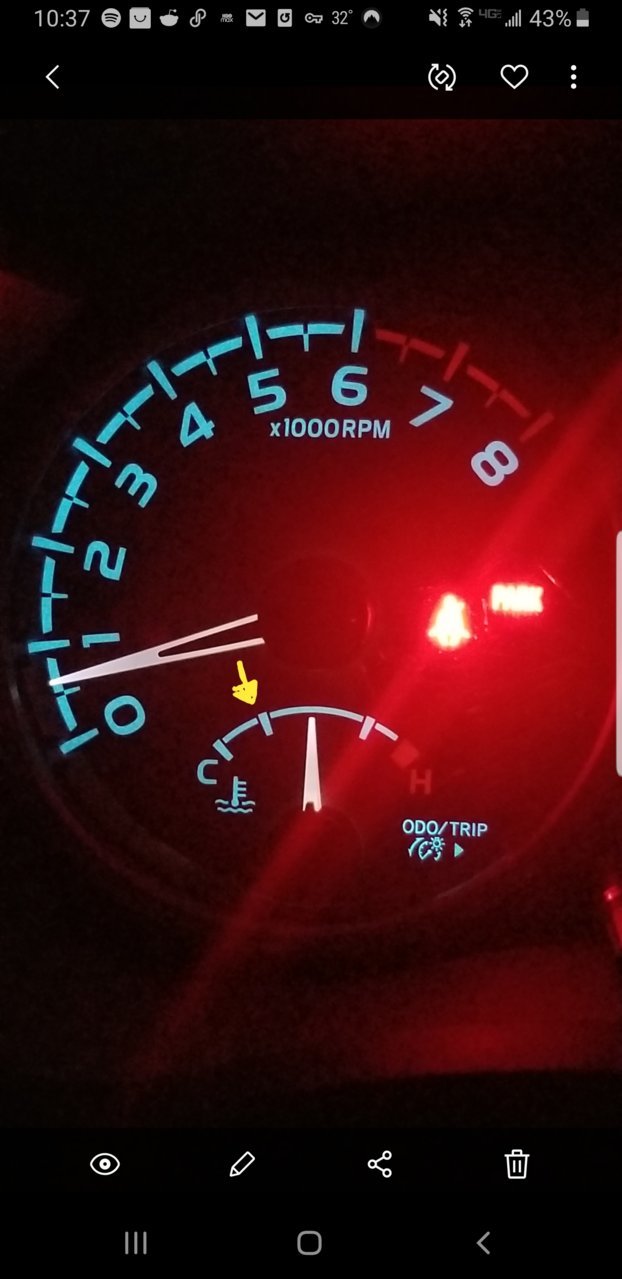

    It's fine driving, then I'll park it, motor temp drops, heater quits. I like the idea covering part of the radiator but I also don't want to be zip-tieing cardboard under my truck in sub zero temps.

    You say "when I'm not driving the motor cools down". Do you know that because you see the engine heat gauge drop in temperature? Or because your heater stops outputting heat? If it's the first one, post#3 could be the solution. If not, off to the dealer. You shouldn't have to put cardboard in front of your rad. Your not driving a 20 year old diesel.

    Everything is fine driving and it seems to blow hot while it's warming up too. Then I'll park and the motor temp will drop to the yellow arrow, and it will start blowing cold. It could be blowing 60 to 70 but when it's -20 outside it feels like the ac is on.
