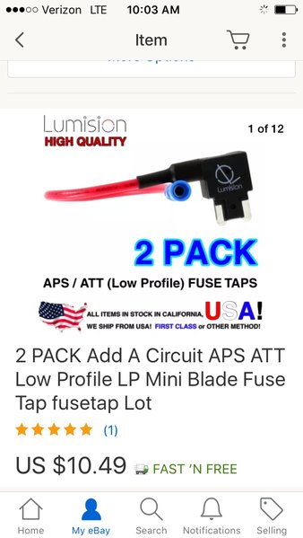

    I used the Empty Fuse slot next to the tail light Fuse for the switch light on my Aux light push switch, and used a low profile-Mini Fuse Tap with two 5amp Fuses I purchased on eBay.

    This circuit only has power when the headlight switch is turned on. I used the 4WD fuse for 12v power to the switch witch is only activated when the Key is On.

    Does it matter if I tap into a fuse with a 10A vs a 30A rating? Each front seat has an in-line 15A fuse then another 5A fuse where the "night light" and "On wire" are attached to.

    I just want to make sure I won't be overloading anything by tying both seat heaters together and then using 3 add a fuses (1 for both main power, 1 for both "on wire" and 1 for both "night light")

    So for the wiring. The simplest way to do it is definitely add a fuses. The ground is self explanatory. The yellow wire needs to tie into any green wire from a factory switch. That will control the switch lighting when you turn your dash lights on or off. You can tie the yellows together and only run one wire to the green wire if you have two switches. The red wire with a fuse is constant 12v. I would run both of those to the interior fuse panel and use an add a fuse. You can connect one to the DR LOCK spot and one to the PWR OUTLET. I wouldn't combine these just to be safe with amperage rating. Then the red with a yellow stripe is switched power. Basically it gives a signal to the heater to only be able to turn on when the truck is on. You could combine these and run one add a fuse to almost any other occupied fuse spot in your panel. The IGN spot would be a good choice. Also here's a good diagram for fuse placement for add a fuses.
