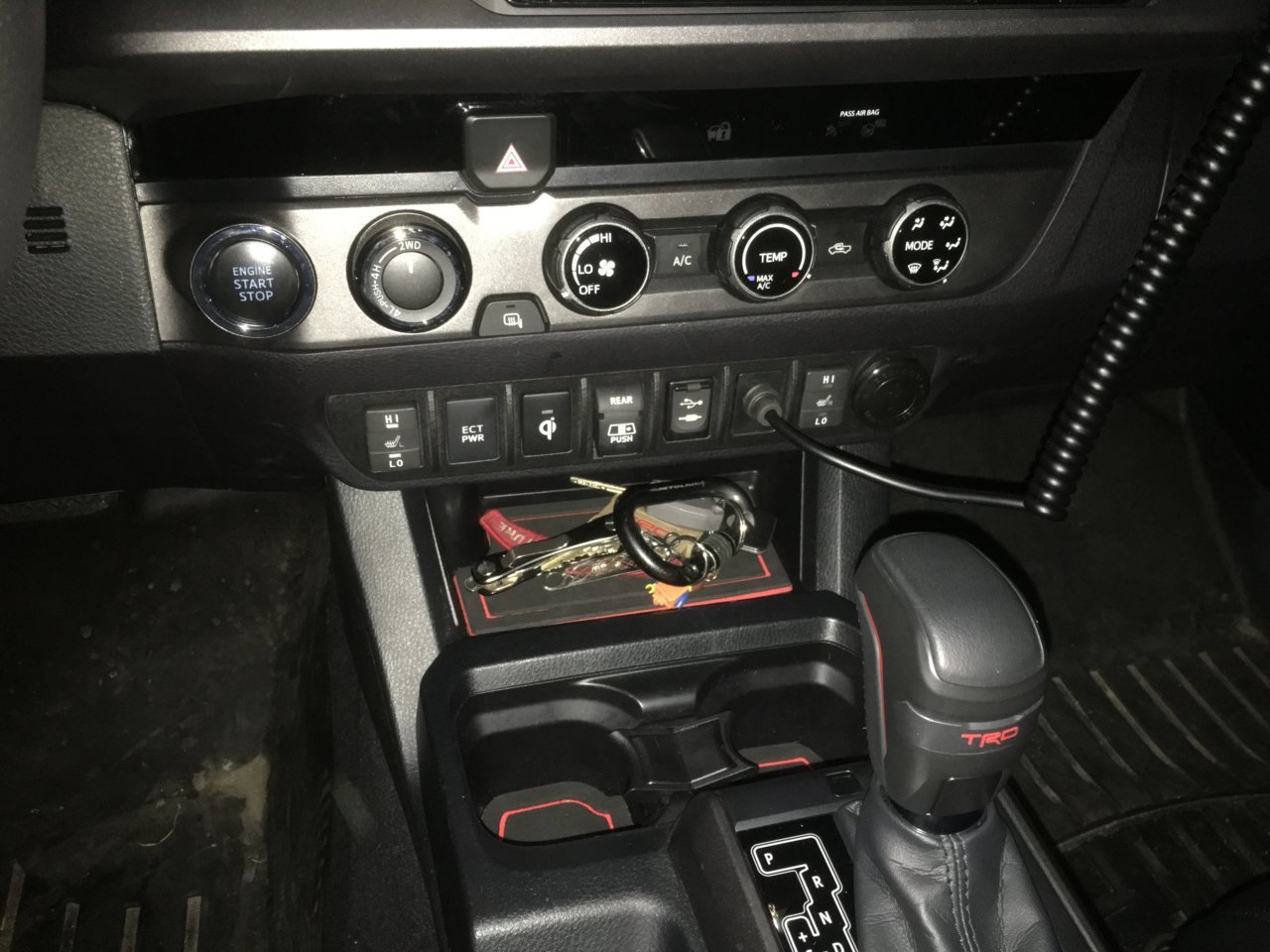

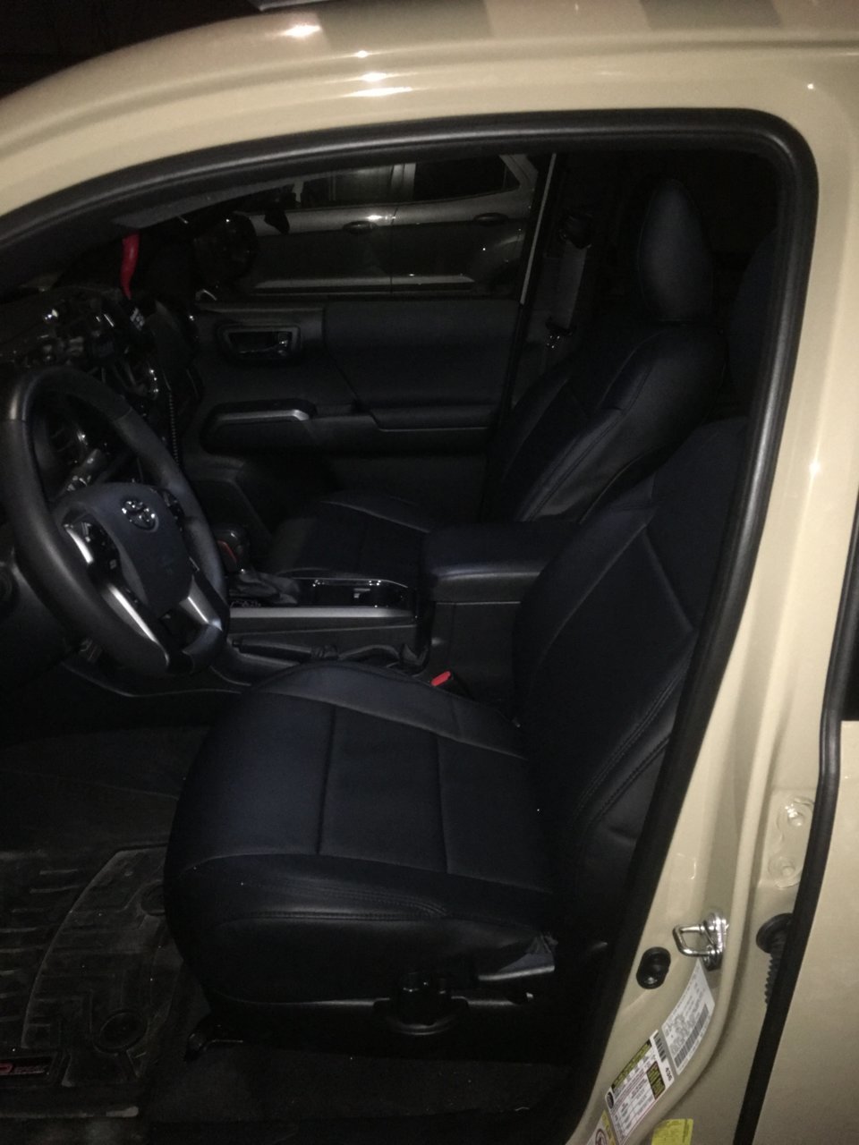

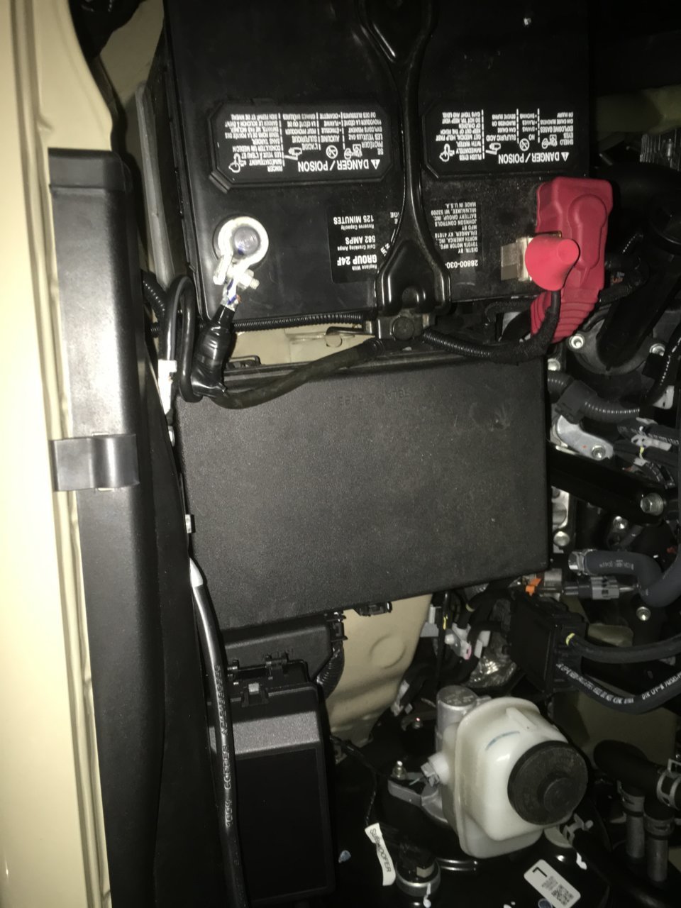

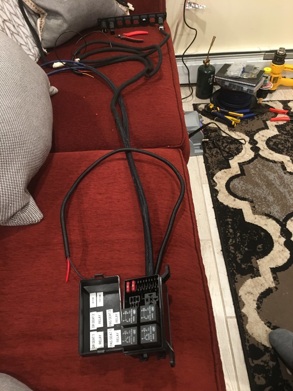

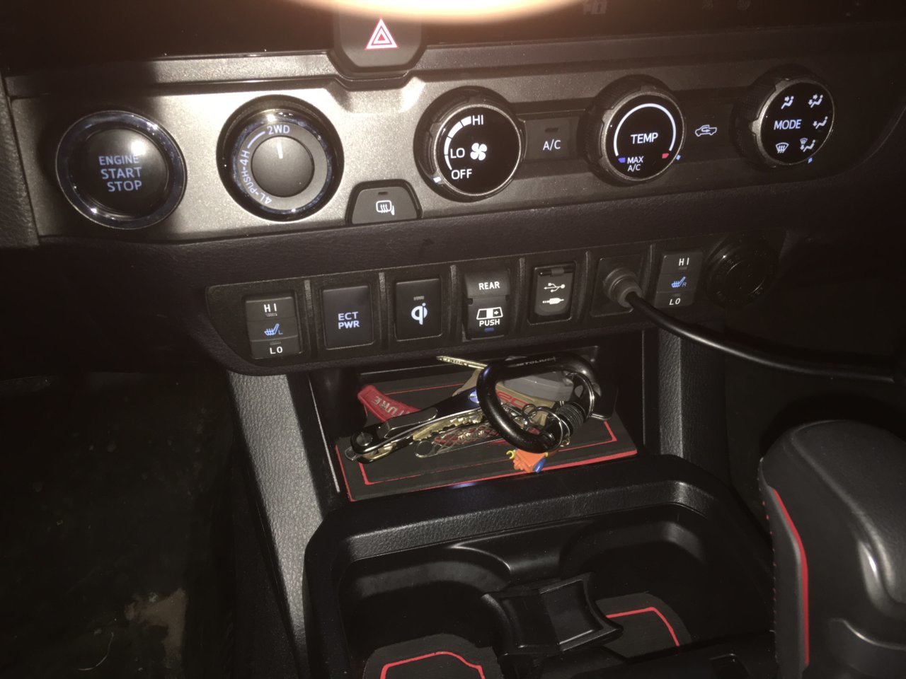

    Just got finished installing my heated seats and Clazzio Seat Covers. I took apart the included wiring harnesses and ran the relays and fuses to an auxiliary fuse box. Drilled a hole in the firewall and used a daystar firewall grommet. I cut out the old switch panel in the dash and replaced it with the MESO 7 switch panel and replaced the 12v outlet with a blue sea usb charger.
    **************UPDATE****************
    Here’s a list of the major materials I used for the install. not including the wire loom, zip tires , waterproof connector and misc wire connectors.

    '18 TRD Sport 4x4 AC 6MT/ '04 TJ Rubicon
    Did you pull up the cloth covers to place the heating elements or lay them on top of the cloth?

    2018 Quicksand DCSB TRD Sport
    I layed them on top of the original cloth

    2016 Tacoma OR 6MT
    Did you cut out the switch panel in place or take apart the dash to pull the panel out? If in place, how difficult was it?
  11. Feb 3, 2019 at 8:48 PM
    murdy81
    murdy81 [OP] Active Member
    Apr 5, 2018
    #249485
    32
    I took the whole dash apart. I used a dermal with a rotozip bit. It would have made a mess. Plus you need to glue it in place so I don’t think you would be able do that with it still in. It wasent to bad. Taking the dash apart takes the longest. I glued it in with black hot glue. It hardens up tough

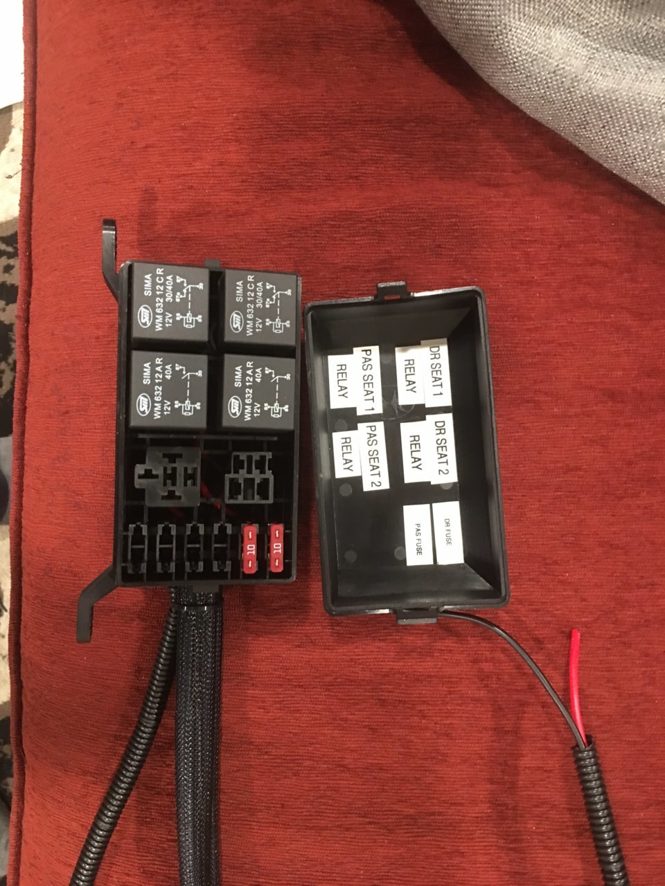

  12. Feb 3, 2019 at 8:51 PM
    murdy81
    Apr 5, 2018
    #249485
    32

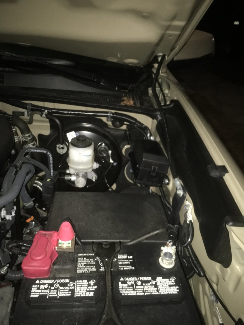

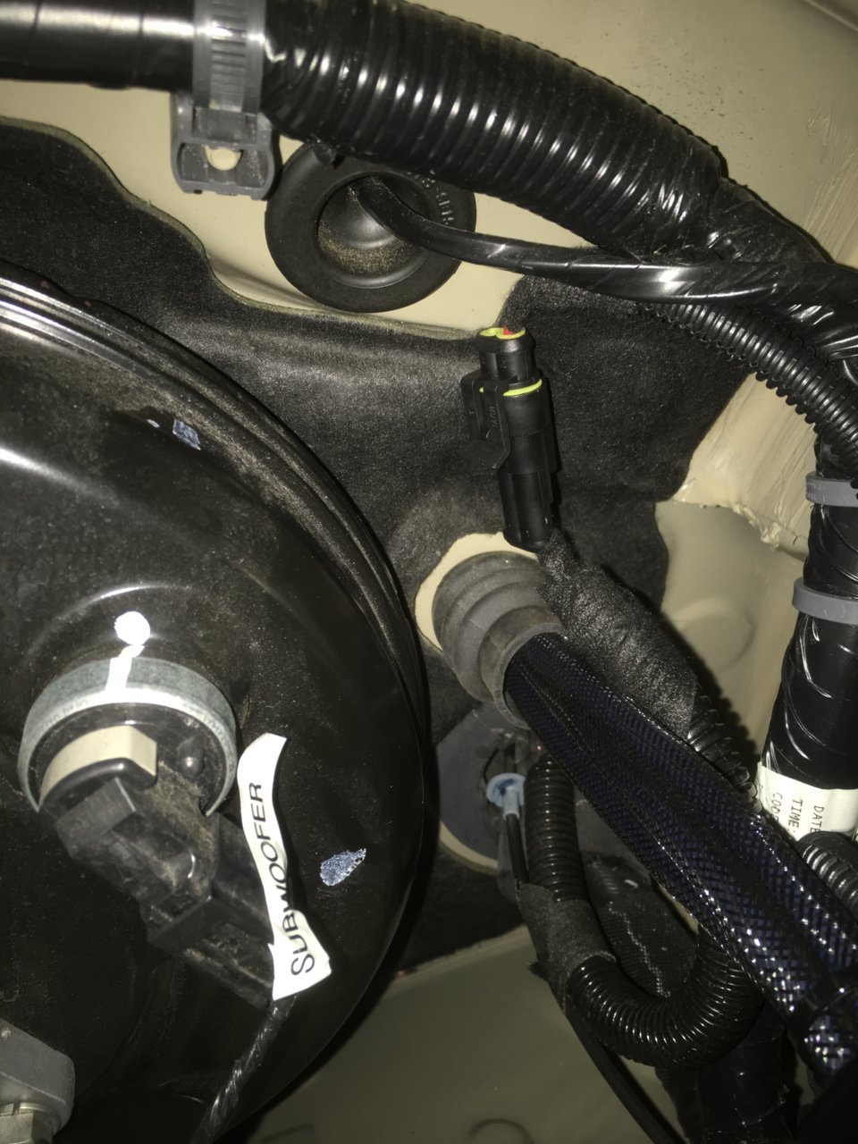

    I forgot to add pictures of the fuse box
    0818DD9B-8EEE-49FE-B26F-00EAC9E6A411.jpg 9C925C54-391F-4273-B199-DB4D4663DED5.jpg

  13. Feb 4, 2019 at 6:48 PM
    VicNic3
    VicNic3 Well-Known Member
    May 5, 2018
    #252619
    748
    GA
    2018 Toyota Tacoma Sport 4x4 DCSB Silver Sky Metallic
    Nice work for sure. Where did you get the fuse box assy from ?
  14. Feb 4, 2019 at 7:03 PM
    murdy81
    Apr 5, 2018
    #249485
    32
    ONLINE LED STORE 12-Slot Relay Box [6 Relays] [6 Blade Fuses] [Bosch Style Relays] [Easy Installation] [OEM Factory Look] - Fuse Relay Box for Automotive and Marine Use https://www.amazon.com/dp/B072KJNPHJ/ref=cm_sw_r_cp_api_i_EXpwCb9CPF5K9
    It comes with all the pins you just have to pin it out yourself
  15. Feb 5, 2019 at 4:10 AM
