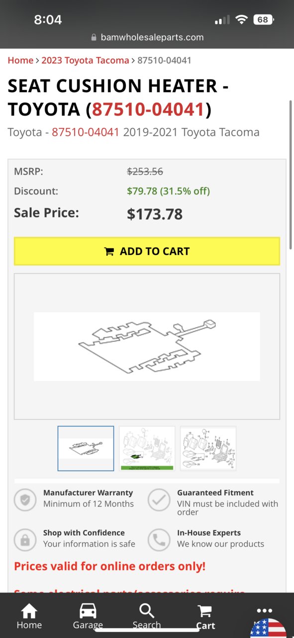

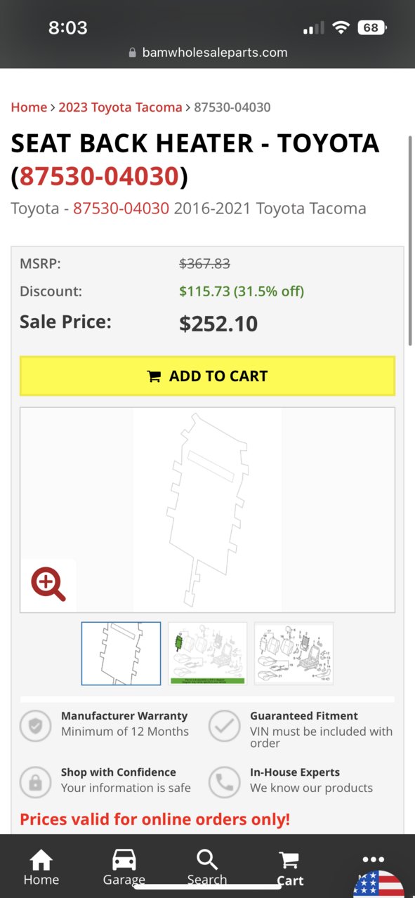

    Okay so I’ve located all but I believe the last component needed.
    - Heating pads both back and bottom that include the wiring harness for the pads.
    - Climate control panel that also looks like the same back wiring of non heated seat model
    - ?? I think all is needed is the wiring harness that goes from climate control panel head unit to the heat pad wiring harness. Anyone know the part number or if that is already pre wired?

    The pads come with a wiring harness, I am still not sure if there is wiring from the climate control unit that runs to the seats though. I haven't received my truck yet I am getting it in late January just doing my research so I am prepped and ready. Also i did read somewhere that it will require a relay switch on the left side dash. I don't have a part number for that yet plan to find a salvaged or used unit unable to find on the toyota parts store.

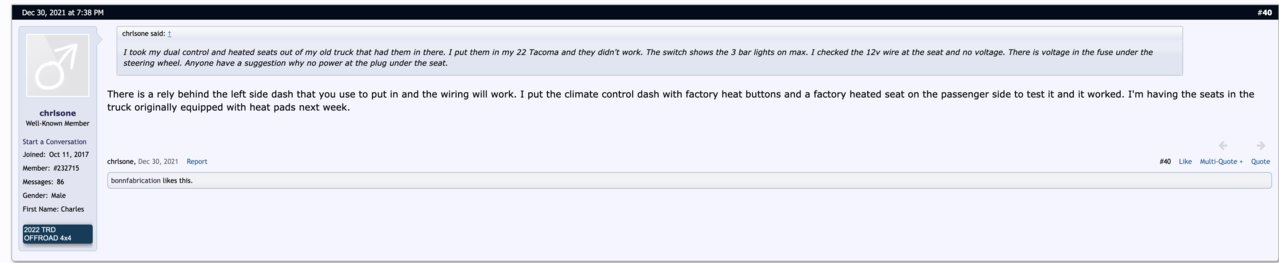

    here is a screenshot of that conversation. Lucky on the premium package its a little out of budget and very hard to come by with the chip shortages going on for these 2023 models. I was very lucky to find a longbox with just the basic tech package.
    https://www.tacomaworld.com/threads/oem-heated-seat-upgrade.622086/page-2

    It wont have the heat pads in there if that is what you are asking. The heat pads do come with wiring harness as for the wiring from there to the climate control dash I do not know. I cant find information on that but the conversation above seems like that might already be wired.
