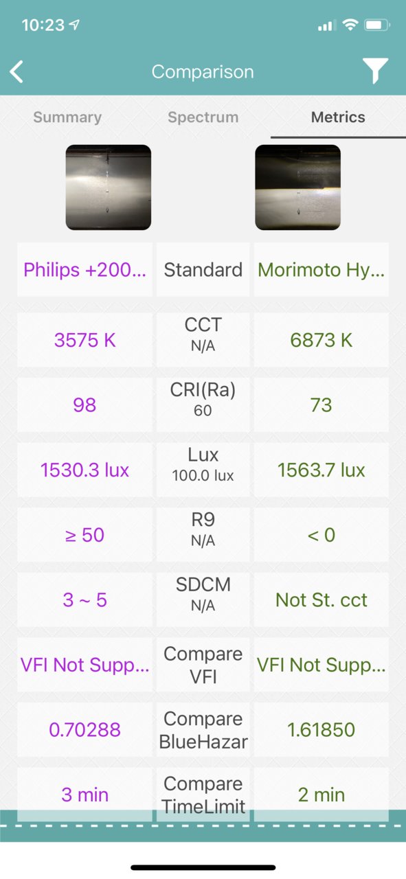

    All the info is in that thread, including stock wattage performance bulbs.
    Osram Night Breaker +200 post #4066 vs Philips Racing Vision +200 post #3169.
    Osram vs Philips
    The Philips bulbs are whiter and higher output.
    The Morimoto assemblies have an excellent high beam, but the Philips Racing Visions will get you pretty close to the low beam performance, while saving you $800+.
