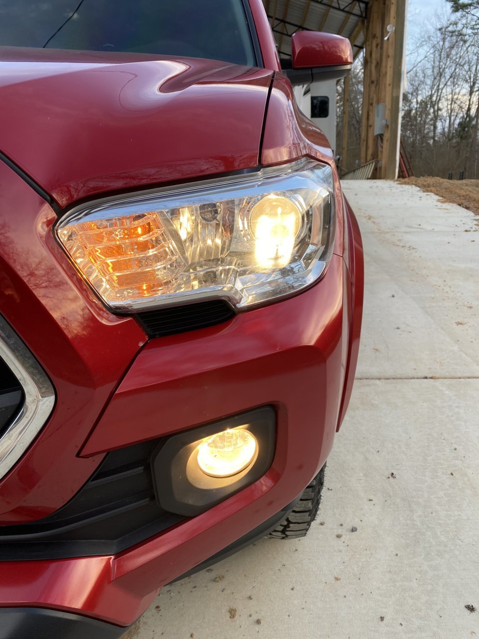

    These are what I have now. Will the ones in the video work for my truck?

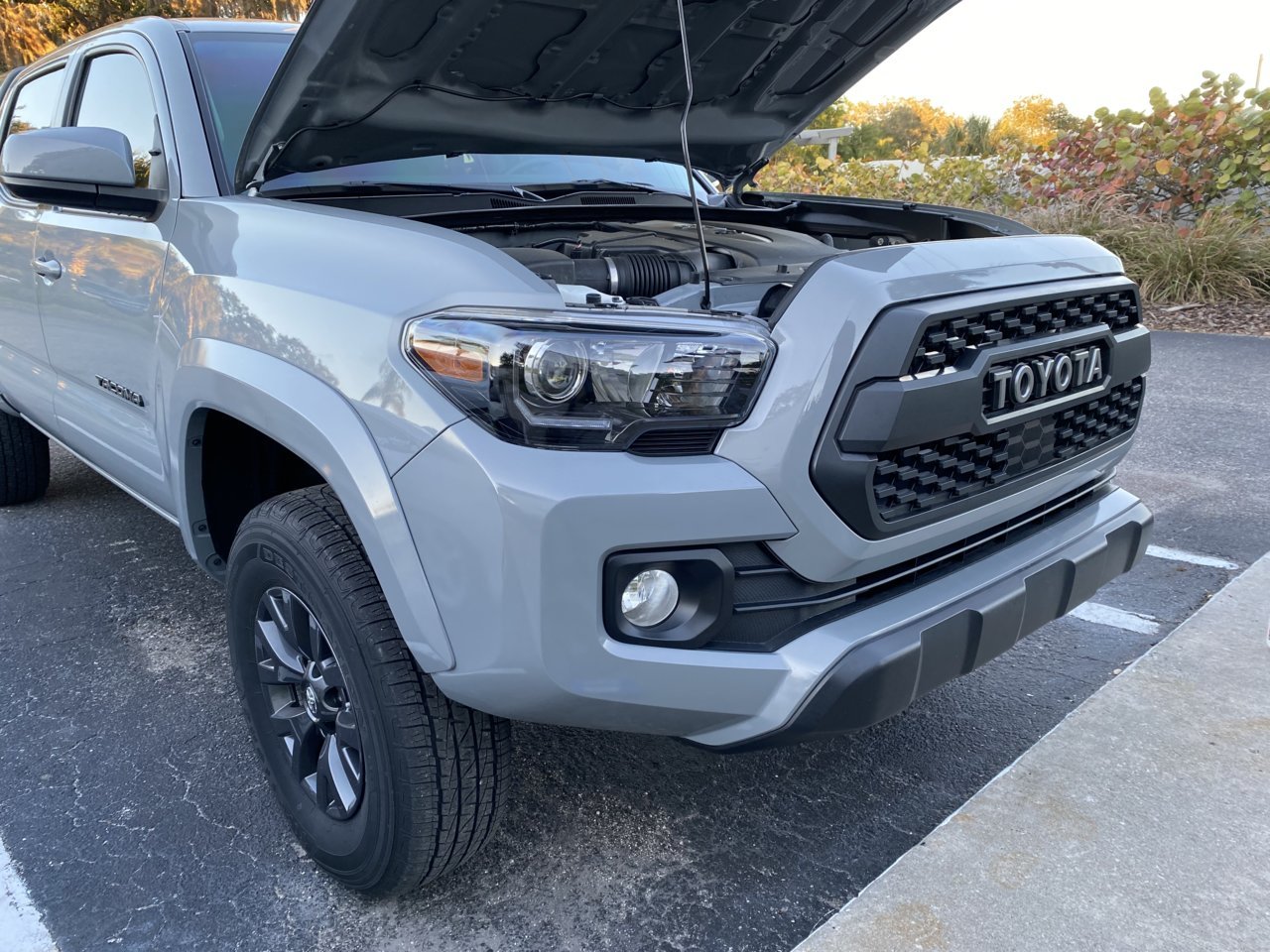

    I have a 2020 SR5 and did not want to convert from Halogen to LED so I ended up picking up a set of 2019 OEM TRD Pro headlights for $300 with a set of $100 LED high beam bulbs he threw in for free. Had to wire up the LED DRL strip which was pretty simple and slightly modify my turn signal bulb socket because it didn’t come with the sockets. By modify I mean cut off one of the 4 small tabs so no big deal. Just installed them this weekend and they look amazing compared to stock.
    Not sure how to upload pictures but I will put a before and after if I figure out how.

    Before and After

    Yep, that’s a major improvement in my book. Those Pro headlights look so much cleaner.

    What are you looking to do; upgrade the light output, upgrade the looks, or both? Adding PRO or OR headlights to your SR5 won't improve the light output. You would also need to make modifications to make them work since the SR5 has the DRL and turn signals together.
    Just don't use the OEM halogen headlights with LEDs. Do it right by going with the OEM LED headlights or a proper retrofit with HID or LED projectors.
