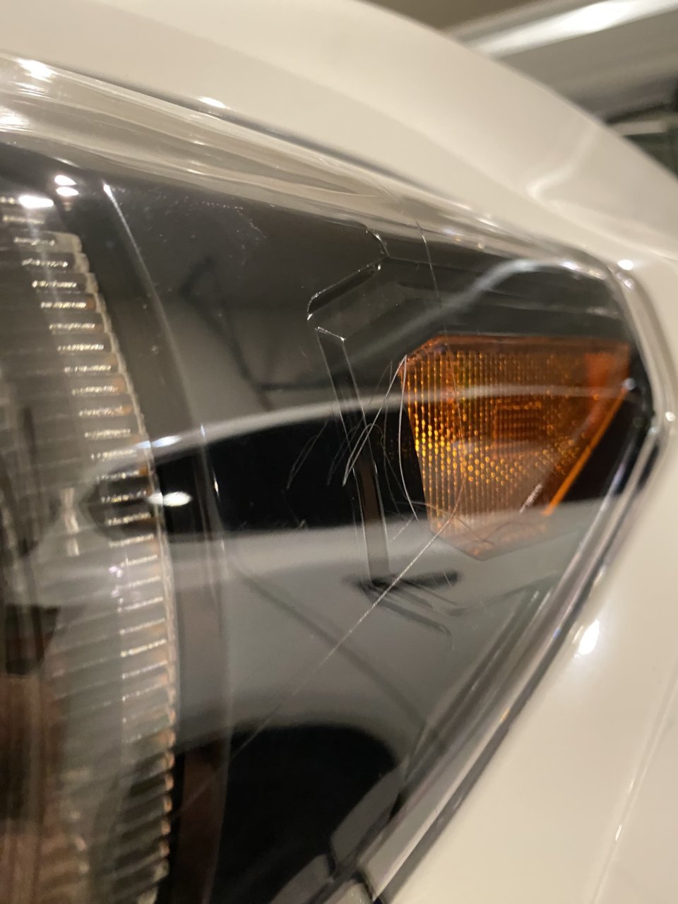

    I got careless during install last night and ended up scratching my new (used) headlights while fitting them back on the truck.
    Granted i got them lightly used for a really good deal so it doesnt hurt bad, but any good tips on repairs/ touch ups?
    i ordered some resin to apply and leave outside in the sun, but any better idea/input will be appreciated.
    i'm sure a lot of you off-roading peeps dealt with scratched headlights more than countless amount of times, and wanted to know if there's a secret formula
    sorry in advance if this was covered already. i did my research but couldn't pull up any

    Wet sand with 2000 grit then buff. Or take it to a body shop and let them fix it.

    There was no protective film on my Toyota LEDs when I unboxed them. Maybe some third party vendors to that. Since the scratch is on the side, I'd just leave it alone until it finally becomes the cancer that destroys your light. Trying to sand that out would just ruin the rest of the light and hasten its demise, unless you've got a way to anneal the surface to re-harden it and re-incorporate the factory UV protections, assuming there are any. These are not Toyota brand lights, right?

    that's true. thanks for the reminder that i may end up doing more damage than good!
    Correct, they're aftermarket morimoto headlights!

    Sometimes toothpaste, the actual paste, in a tube, will smooth out scratches. Try it first on a small area.

    Wet sand it with some 1200, 1500 then 2500, lightly polish. It will sand out. Try in out on your old light first if your nervous. I have sanded many headlights and recleared them, you will be fine. Don't just use polish and not wet sand as your just going to be polishing the scratch. You need to level it, that plastic is pretty thick, it will sand out!

    Don't wet sand and buff. You will remove UV protection. Also if you do just that smsll area, you will have a halo around it. Ask me how I know. ‍♂️

    How do you know? Seems like you did something wrong. Tell me about this UV protection on these lights. I have wet sanded, polished and buffed many headlights without an issue. Sometimes they need reclearing but in this case a little leveling, feathering the scratch and buffing will take care of it 100%. OP take it to a good detail shop and let them work the magic, its not hard. Wooooo!

    i tried wet sanding and it left like a smear so i just ordered this kit and will see how it goes.
    i dont have any compound or sealants to apply on top of sanded area so i stopped for now :p
    general consensus seems to be sanding it down, so im going to return the resin i ordered from Amazon

    Sand it down, polish with some mild polishing compound with a high speed buffer with a lambs wool pad, then a foam finess pad. Maybe a detail shop in your area is best. A coat of spray way ever so often is all you need to seal it from the elements.

    the mfg might sell parts for them or....
    dont try to fix that by polishing/sanding, live with it
