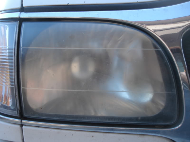

    I tried this expensive kit and found it to be a gimmik it worked for a week.... :( so the question is how do i restore my headlights to the norm and get rid of the milky chalky flim arround them. My blue hids would sure appreciate it.... and i would too:D. so if you have had problems like me and fixed it, i sure would appreciate it! Thanks everyone. JV

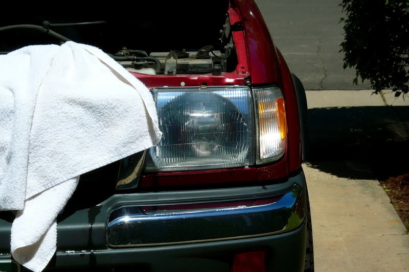

    Here's the day I restored mine with the 3M kit (didn't know about the clear coat finisher)
    8 months later they looked exactly like they did before I restored it.
