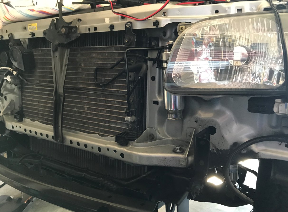

    They're crazy easy to break so thats probably it. They are held on by a bolt towards the inside, once you get the grill off, which also has some very brittle clips of its own, but those are an easy find

    Yeah, I've currently got the front end off my truck because I'm repainting the lower valance and replacing the bumper cushions, etc. While I'm here, I'm hoping to get the filler being lose resolved.
    https://www.tacomaworld.com/threads/polishing-a-turd.682274/page-7
    Passengers side
    Drivers side
