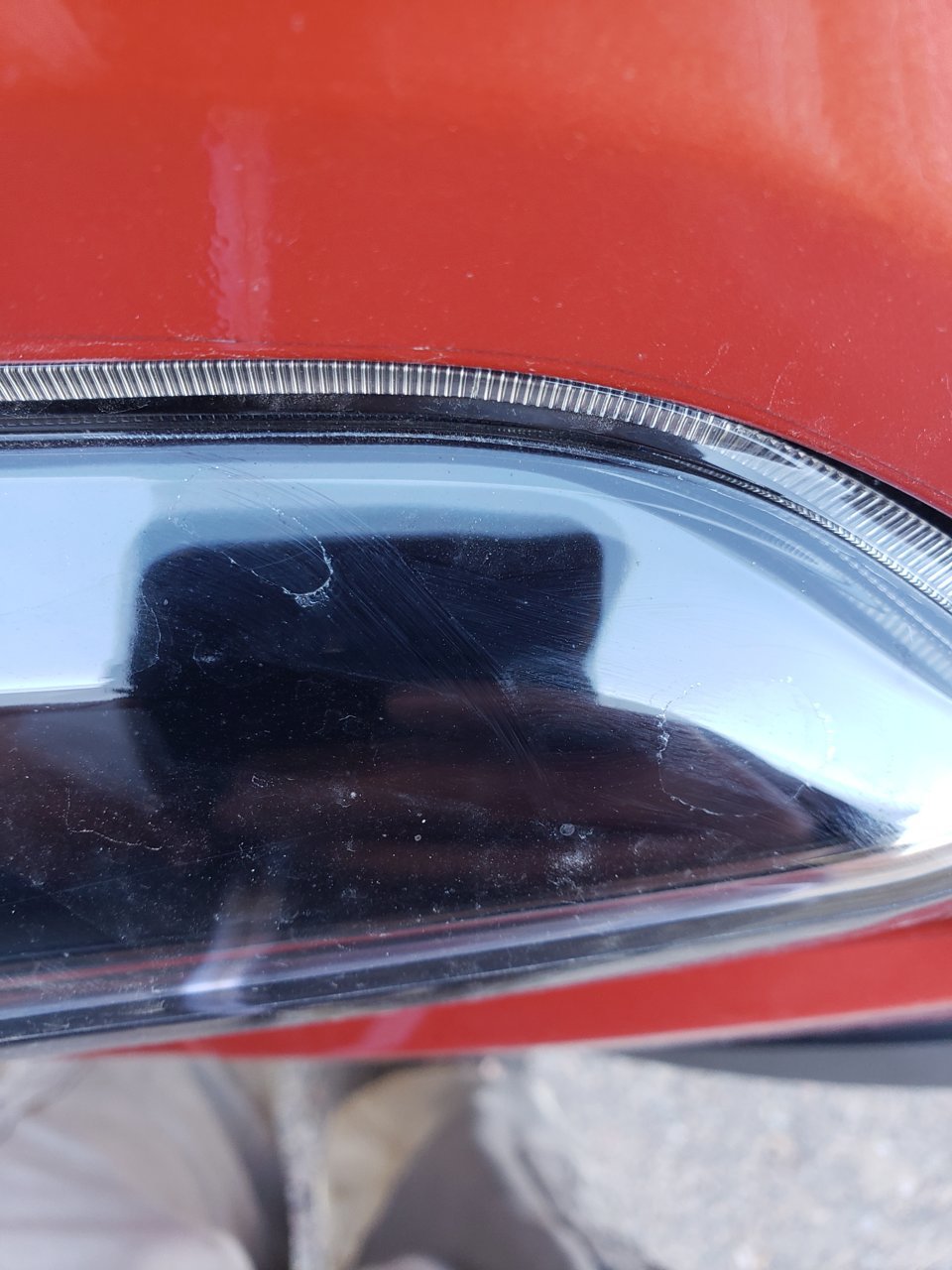

    Hi guys, so I just noticed the factory film on my Headlights are starting to peel off. Is this normal? Anyway to stop it from peeling even more?

    I would say not normal. My left headlight had weird spots on the inside and was replaced by my dealer no questions asked. Just go to your dealer if you still have the warranty.
    You can always protect your headlights by applying a coating on them.

    Unfortunately "normal". Also in San Diego, and I had a 2015 Tundra... same thing at just 1 year old. If you're under warranty, take it in. On my Tacoma, I put Chemical Guys Jet Seal every few months.

    Whenever I get a new car, I have the headlights wrapped in clear bra (as well as the mirrors, or other high-impact areas). On my truck I get the tailgate wrapped. My headlights on my 08 still looked brand spanking new 12 years later.

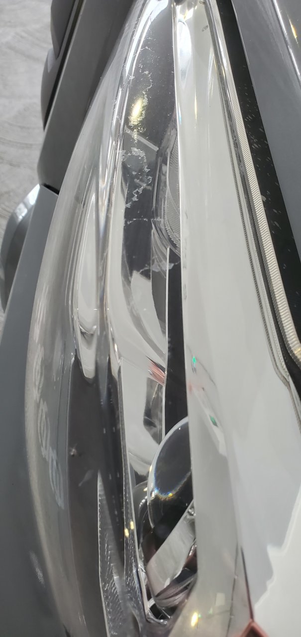

    Seems like most of you guys who are experiencing this are in hotter climates. Wonder if this has anything to do with it.

    UV is a huge contributor to this kind of deterioration, as is heat (both from bulb and sun). So yes hotter climates do play a large factor.

    All headlights will do this just a question of when. Doesn’t hurt anything just looks shitty. You can sand it and seal/clearcoat it or replace them.

    Glass headlights won’t do this, but the days of glass headlights on your average vehicle are long gone.
    The real problem is that film that’s coming off on the OP, is actually the UV protective film that stops the headlight from discoloration. So once that’s gone, it’s a constant sanding / polishing battle and any clear coat from your average rattle can or wax sealer really won’t do shit. It’s a 2 part clear coat or clear protective film that will help.
