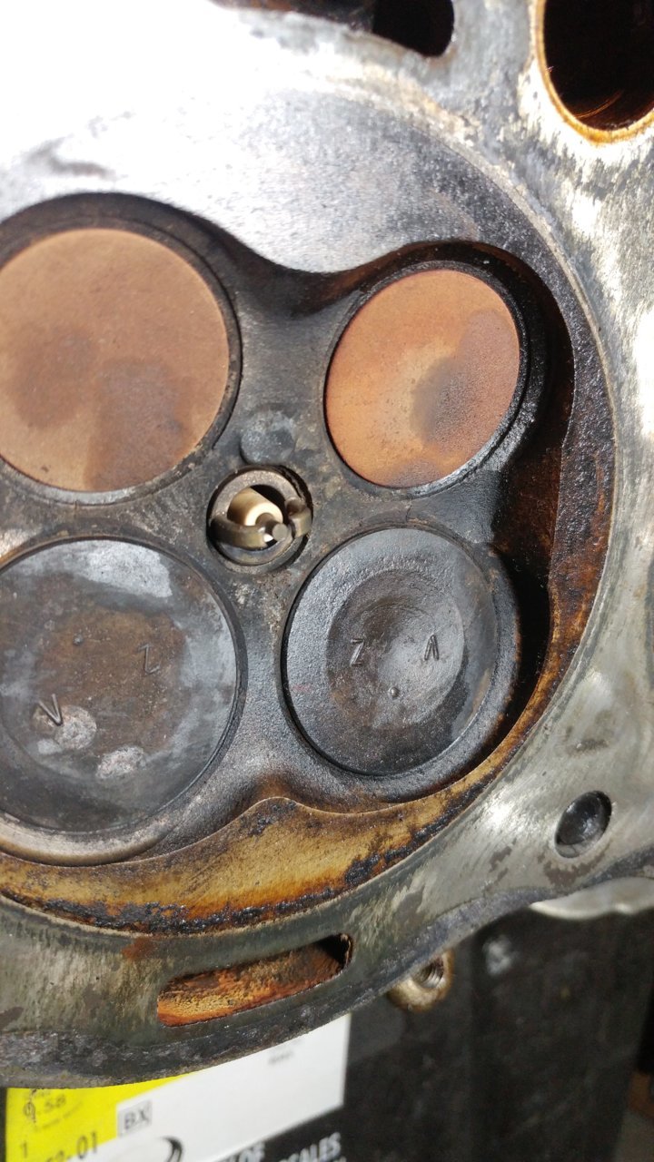

    Hi everyone, I'm seeking opinions for my repair.
    I have a 5vz with 190k that blew a head gasket on the passenger side. Upon inspection of the heads, my buddy and I realized there's a small crack in the head between 2 of the valves. The same cylinder has chafing on the walls and appears to have leaked coolant through the head gasket. Is this tiny crack in the head the reason for the head gasket failure? Or is it a possible threat to the engine ever running correct again? Would i be better off sourcing a used engine? From what I've read, nobody trusts any aftermarket head gaskets or kits, only trust OEM Toyota, correct? Should i forget about doing a head gasket and start looking for a engine? I have it torn apart in my friend's garage so I'm also trying to make this happen asap. Thanks!

    There's no physical gouges or scratches in the cylinder. I'll send pics when i get off work. It feels more like a residue. I would think a honing would clean the cylinder up good. My concern is primarily the crack in the head. I'll send pics of that also when i get out of work.

    How do you repair a head with a crack between 2 of the valves?

    it can be welded but most shops dont want to deal with cracked and warped heads. Try and source a used one and have it rebuilt with new valve seats, valves. Like new!

    Do the prep work weld the crack re machine the valve seats as needed .

    Hence the reason i ask if anyone on here has personal experience with repairing a head or using a head with a crack in it. I'm tempted to put a cheap head gasket on it to see if it holds up. 100 dollar option. If it holds, hell yeah! If not, it was only 100 bucks wasted.

    I wouldn't recommend just slapping a gasket on and trying to run. It'll make things worse if the crack worsens. Replace the whole head or replace the engine.
