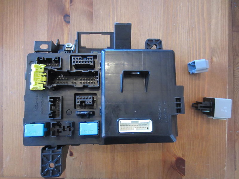

  11. Nov 7, 2018 at 10:36 AM
    Ndp302
    Ndp302 [OP] Member
    Nov 6, 2018
    #271870
    10
    Here's the part I just picked up.
  12. Nov 7, 2018 at 10:39 AM

  13. Nov 7, 2018 at 10:41 AM
    Ndp302
    Ndp302 [OP] Member
    Nov 6, 2018
    #271870
    10

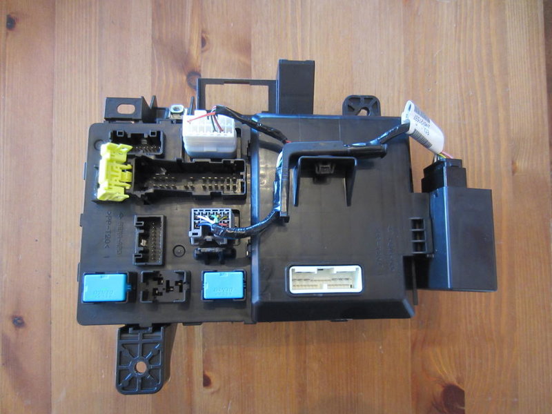

    Thanks! Think this is the right one. I managed to stick my phone up behind the fuse panel and snap a picture of the existing one. They look identical other than this one is black and the existing is white. The text on the block itself looks to be the same.
  14. Nov 7, 2018 at 10:43 AM
    Muddinfun
    Muddinfun Well-Known Member
    Apr 17, 2017
    #216500
    7,489
    This is a pic of the flasher with DTRL. It's that box on the right side with the wires plugged onto it.
    TireFire likes this.
  15. Nov 7, 2018 at 10:48 AM
    Muddinfun
    Apr 17, 2017
    #216500
    7,489
    This is the non DTRL flasher. The finger is pointing to it.

  17. Nov 7, 2018 at 10:53 AM
    #17
    Muddinfun
    Apr 17, 2017
    #216500
    7,489
    Then I'm pretty sure you bought the wrong flasher. You should have 1 that looks like this. Lower is the flasher. Upper is the grey plastic jumper block needed for non DTRL[​IMG]
    Rick's 2012 likes this.
  18. Nov 7, 2018 at 10:56 AM
    #18
    Ndp302
    Ndp302 [OP] Member
    Nov 6, 2018
    #271870
    10
    Ahh. Damn.
    Well, the flasher looks the same as the one I have - but it didn't come with this jumper block.
  19. Nov 7, 2018 at 10:58 AM
    #19
    Muddinfun
    Apr 17, 2017
    #216500
    7,489
    The jumper block will be there. You don't need to replace it. Does the connector on the flasher you bought look like that connector on the fuse block? 8 pins?
  20. Nov 7, 2018 at 11:03 AM
    #20
    Ndp302
    Ndp302 [OP] Member
    Nov 6, 2018
    #271870
    10
    It has 8 pins, yes.
    I'm about to start taking apart the dash/knee panel so I can get to the damn thing.
