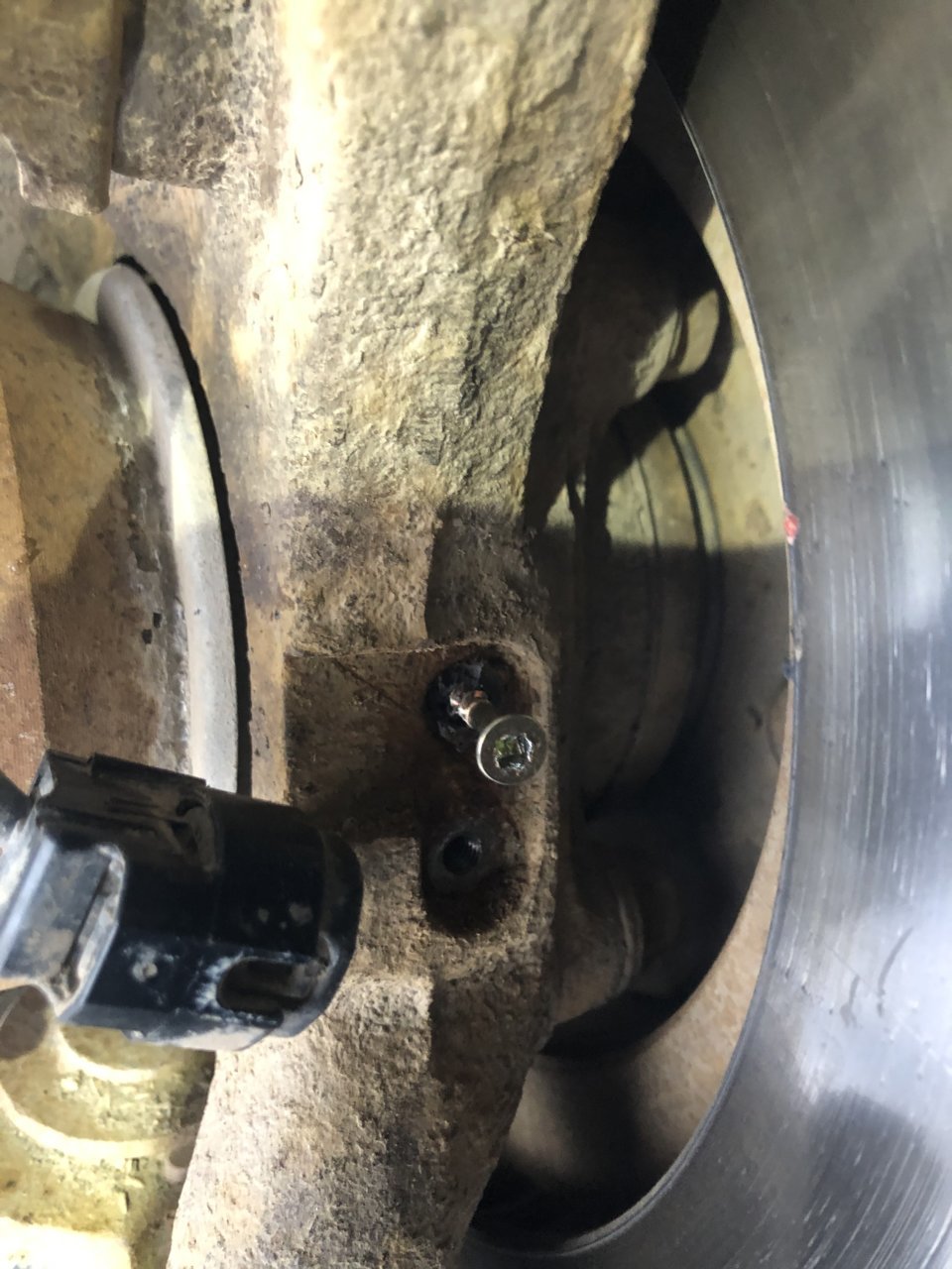

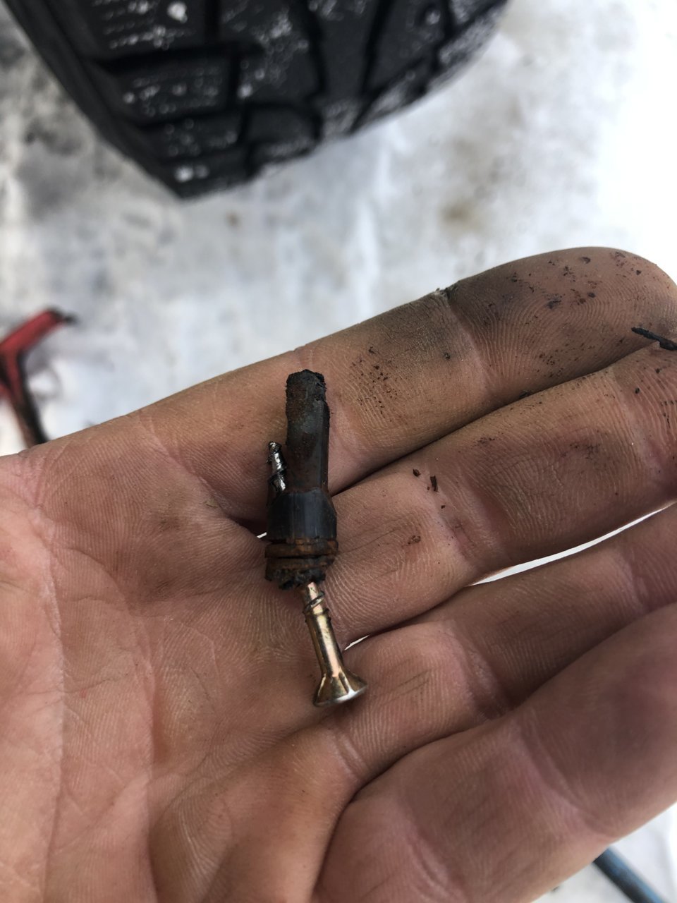

    32F5C8C3-F639-413E-BAC2-DDB0E52F8ED4.jpg I used a 1-1/2” wood screw and screwed it into the broken sensor. The. I used a claw hammer to pull it outEAF91250-1D05-4AA3-BE67-5AFE6F8D3964.jpg
    ghardy and YOTA LOVER like this.
