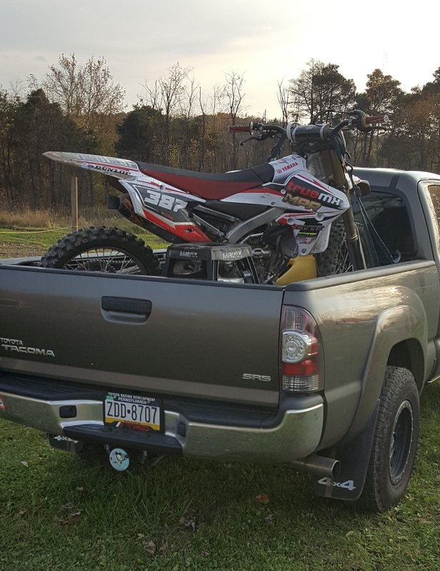

    Ya, try to move them in a little closer, maybe. I don't have a good pic handy with both bikes in. But I do have 1 of just my 250F strapped down, just to see how I do the straps. It's pretty standard, nothing fancy. Soft ties from the bars to the front bed D-rings. For 2 bikes, just imagine the rear kicked straight. And all 4 straps (2 on each bike) go from the handlebars to the front 2 D-rings.

    That looks like you have a long bed. I was about to say how the hell did you get a full size dirt bike in the bed with the tailgate shut

    Ya. But when I haul 2, I have to run the tailgate down.
