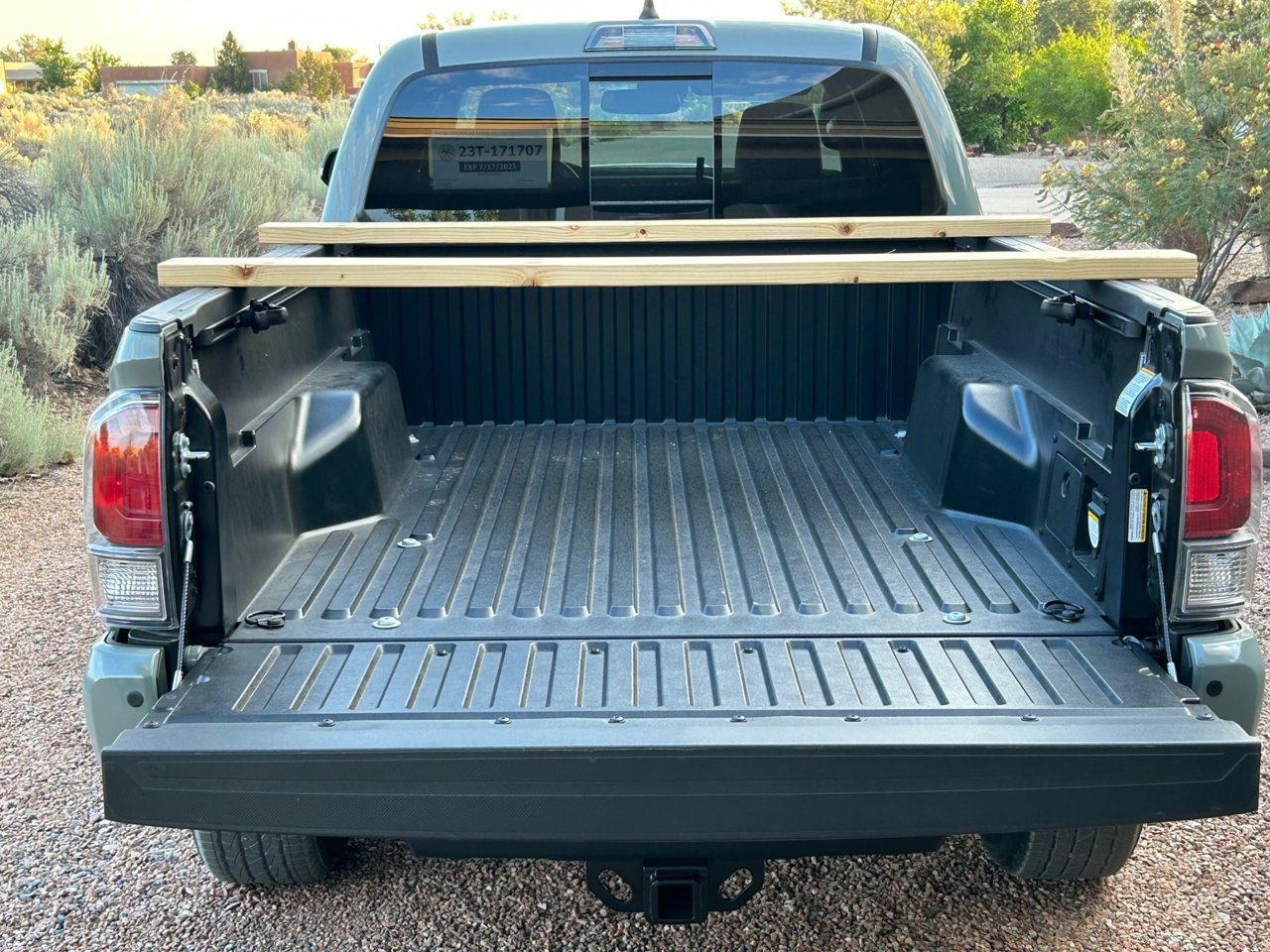

    I just replaced my 25 year old full size pickup with a '23 Tacoma and have a need to haul some 5'x5' plywood sheets. This may be a recurring need as I am a woodworking hobbyist. I am interested in seeing how other Tacoma owners have managed this while keeping the plywood sheets flat. I have a well equipped wood shop so I can easily build something out of wood. Please share your design ideas with me.

    BlueberryBCtaco: Your solution will work great for a 4'x8' plywood sheet and I will likely implement something like that. My immediate need is to haul 5'x5' Baltic birch plywood so I will need something that rests on the side walls of the PU bed.

    I see, if you want it to lay flat.
    You can do something like this.
    Two of these, front and rear. And instead of pipe you can use 2x6 and ubolt.
    I’m not sure on how strict wide vehicles are in your area, but something to bear in mind.

    BlueberryBCtaco: Here is my adaptation of your suggestion. The attached drawing worked for me but you better double check the dimensions for your specific Tacoma. The ends of each 2"x6" have 2 each 1/4"-20 Tee nuts (in my case, Propell nuts). For a 5'x5' sheet, space the two 2"x6" boards roughly 30 inches apart. I have not actually used it yet but am optimistic that it will work. Of course, you need at least two tie down straps.BB 5x5 plywood rack.jpg BB drawing for plywood rack.jpg

    Looks good.
    I would not worry too much about adding that 5in x 5in vertical piece.
    Once you strap them in it won’t shift passenger to driver.
    to attach the timber to the OEM bed rails. You can buy some T-nuts or you can use 1/2 in spring nuts for unistrut. Works just as well and you can buy a pack of 15 or more for the price of 4 T-nuts off scam-azon. But your call.
    Even if you don’t attach to the bed rails , once you strap them in you are still good.
    see attached.

    I like your idea, but have two comments / suggestions.
    I would add the side pieces for load stability. I'm not sure how much you plan to haul at once, but I don't to solely rely on cargo tie downs.
    I would also add those pieces or a full width piece to the front of the forward board to protect the back window (an potentially you as well) during a sudden stop.
    I added D-ring tie downs to the side of the bed just above the floor, between the wheel well and the front wall as an additional low anchor point.
