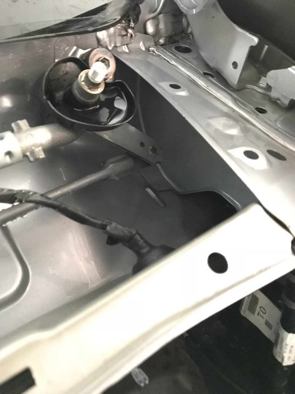

    hi! It’s been 2 years of dry leaves and shit piled on the wiper arms holes...
    Has anyone removed the plastic piece that is under the hood that covers that area?
    Is it difficult? I would like to vacuum all the debris accumulated under it..-
    Thanks!!!

    the cowl is pretty easy on the tacos to remove, take the wipers off (14mm) then theres a push pin (clip) on each side, remove those. then start to lift it up until you see small black plastic tabs that clip into the frame the cowl sits on. all you need to do is take a flat head screwdriver or something small to push those in to release them. once released the cowl will remove. you may need to remove the corners to get it out but those just pop in and out.If need be, I can take some pics in the morning of the removal.

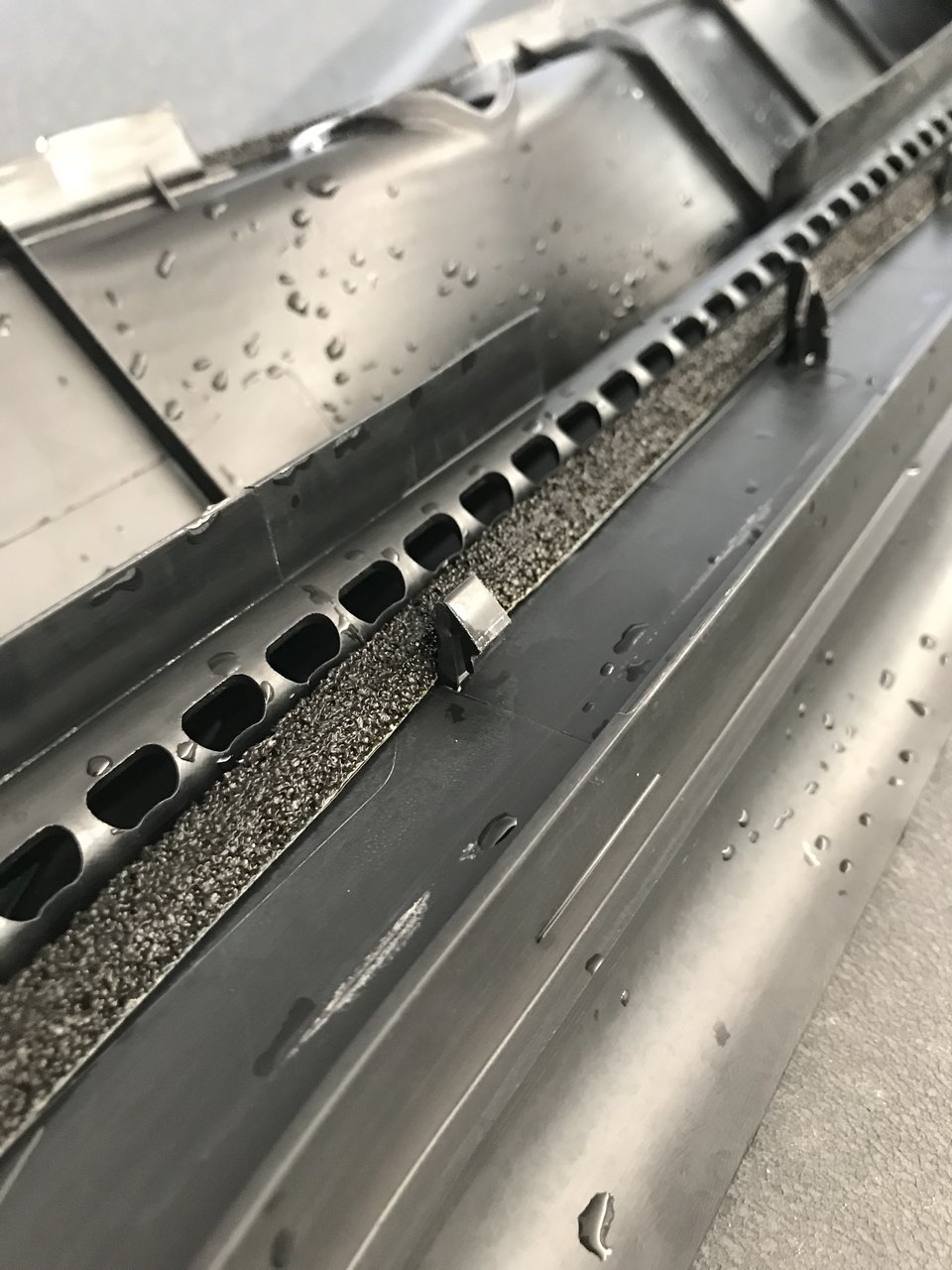

    So I did remove the cowl piece on my truck.. it wasn’t that bad.. actually I was surprised that it was so clean.. mostly dust.. of course with my ocd I had to clean the entire area...
    My 2cents:
    - DO NOT do mechanical stuff wearing khakis and nice white shirt UNLESS you just washed your truck....................
    -DO NOT PULL JUST FOR PULLING IT.. I broke one tab......
    -This is a pic of one tab.. is designed to be pushed lightly in and it will come loose easily.
    -that plastic tab plugs here... if I remember correctly there are 4 tabs in total. Put your finger under the front edge of the cowl piece where it rest with the frame.. you will feel them.. pull up the front of the cowl and press lightly the tabs and it would not brake..
    - forgot to take pics of the two easiest tabs that are visible on both ends of the cowl (front edge towards the fenders)
    -This is the edge of the cowl that meets the windshield
    Pull up the front of the cowl and the back part of it (windshield) will come loose.. no tabs..
    God bless!

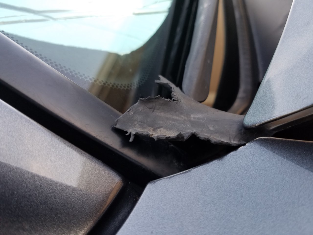

    So glad I decided to join this website. You guys are awesome. I have a new problem with this cowling. I believe a bird ate part of my cowl. Suspect the young Crested Kara Kara which as been around my yard for a few days now. Had to be a strong bird. Now where can a get a new one for a 2017 double cab TRD sport? Thank you for all your help.
