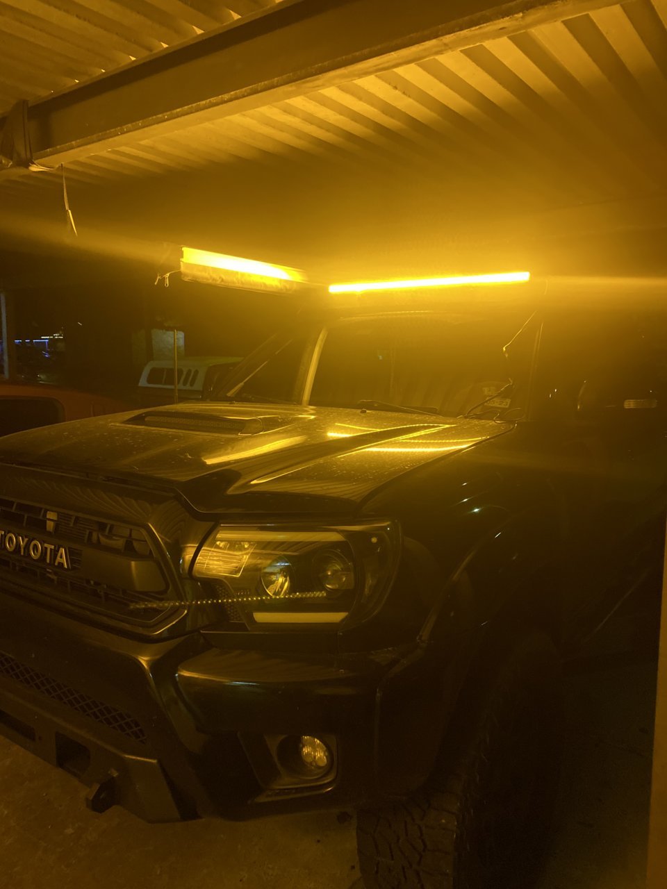

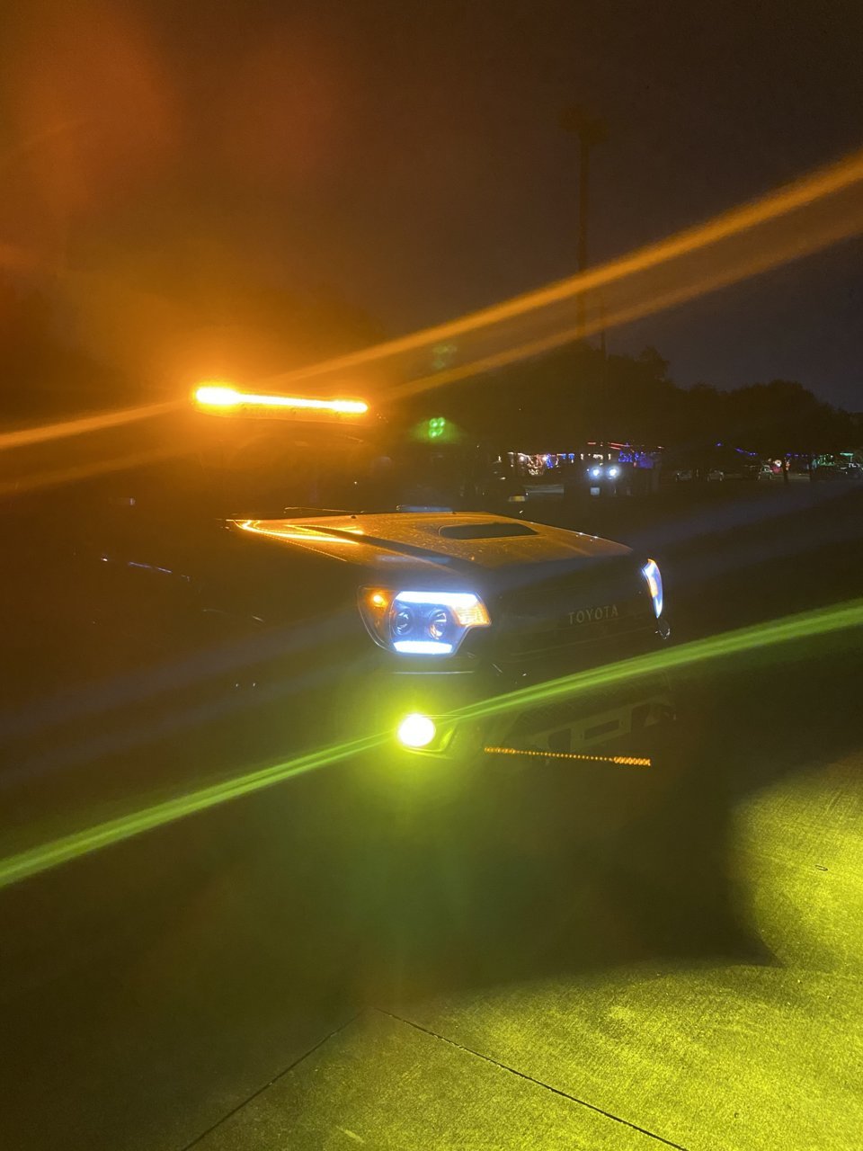

    I just installed the amber Cali raised led bar on my prinsu rack.
    I Mainly got it for looks and didn’t have high expectations however I’m curious if anyone has made a jump to the better led bar like baja design or heretic and seen a major difference .
    I couldn’t justify the price right now but can maybe convince myself later down the road.
    Comments of brand or pics would be great

    Ouch. The open bucket reflector glare off the hood is just awful, greatly reducing night distance vision which is counter to the entire purpose of having a light bar. Exactly why that kind of product should never be roof mounted. CaliRaised is low quality and low performance, any name brand product will be significantly better. However, the only products you should roof mount are ones with focus to eliminate hood glare, so you are not blinded by your own lights and can actually see better, since that is what you are paying for. The only type of products that can do that use TIR optics, or reverse reflector optics, aka Diode Dynamics, Morimoto, or KC Gravity. Anything else that puts out significantly more light like Baja, is just going to blast your hood with that much more light, further limiting your vision, despite having more light output than your cheap china bar.
    Just for fun, you might find post #362 interesting, comparing a cheap Chinese bar (similar to CaliRaised) to a real name brand.
