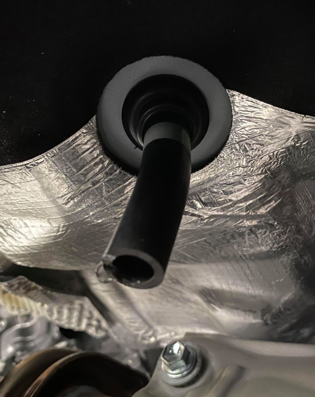

    Seeing as I've got a second shot at a 3rd gen Taco, I've decided to do the recommended mods I neglected the first time.
    First up, AC drain tube extension. Home Depot was out of 1-1 3/8ths adapters so I used a T connect and ran two tubes for maximum condensation flow. :curls:
    See? (Why Toyota opted to put this short hose draining straight onto sensor wires, exhaust and steel frame I will never know)
    Probably overkill. Oh well. :notsure:
    Clamped in.
    We'll see how it holds up like this. I may just redo it with fuel line or something if I don't like the way this functions.

    There have been other ways to 'skin a 'Cat" including this thread https://www.tacomaworld.com/threads/rust-on-frame-with-a-c-drain-mod-fix.444138/#post-12942289 I'll go this route with 5/8 heater hose after looking for the drip hanging on the end of the hose that was the source of the wet spot on concrete at the rear of the right front door. AC gets a workout on long summer drives... Good time to do this between NHOU frame treatments... The oil is food grade so it wipes off my skin after working under the truck.

    I just used a section of garden hose, a few zip ties, and a screen to keep the critters out. Been on for around 13 years with zero issues.
