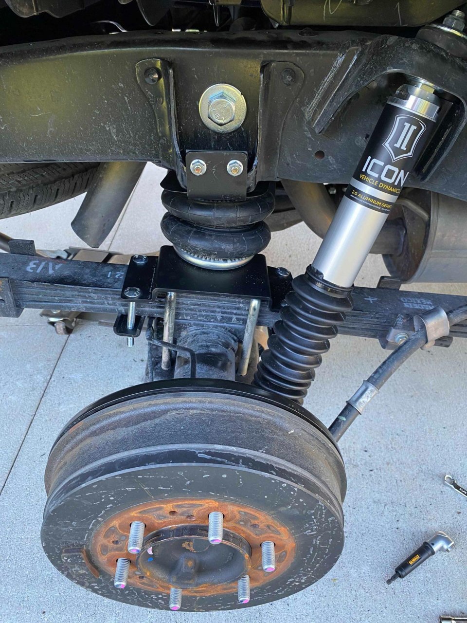

    Hey guys, got another one for you since I was sick of seeing my Tacoma riding completely flat all the time.
    Decided to throw a pair of Icons in there as the stock Hitachis are softer than baby shit.
    All torn down:
    Icon popped in:
    Airbag assembly mounted in the correct direction (bag on the inside of the frame closer to the differential):
    Bag attached and ready to be aired up. I elected to reverse the bolts on the bump stop tower because it makes a little easier to zip tight with a power tool.
    Had to go to the hardware store for a monster socket to torque this bad boy. I think its like a 30mm:
    And here she is. Aired up to 20psi. Parked next to lifted Taco for reference.
    Any questions, let me know. This job was a big pain in the ass. ha

    Basically you cut the bump stop > attach the lower assembly with carriage bolts and torque to spec > bolt the lower portion of the bag to the lower assembly > attach the upper assembly with finger tightened bolts > maneuver the upper portion of the bag into the upper assembly and torque the jam nut down on the bag to attach the lower and upper assembly > from here its a long and arduous process of tightening all the finger tightened bolts, the angles are terrible

    I've got an awesome Kobalt air inflator. The bags are fairly small and don't need to be tweaked much once you decide where you wanna be at. They do make air compressor kits for this if people have onboard air. I don't need to be that fancy.

    I've got a few hundred pounds in the back so 20psi isn't too stiff, but if I had an empty bed I would advise something more like 5-10.
    Overall, I have noticed less body roll when turning and I think the Icon's help dampen bumps a bit as well.
