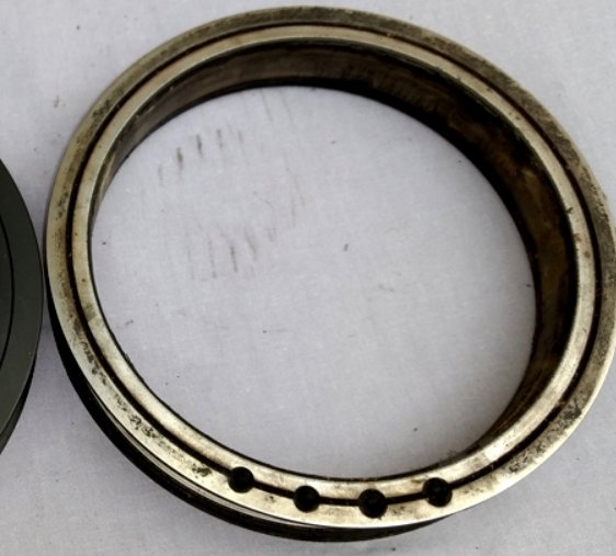

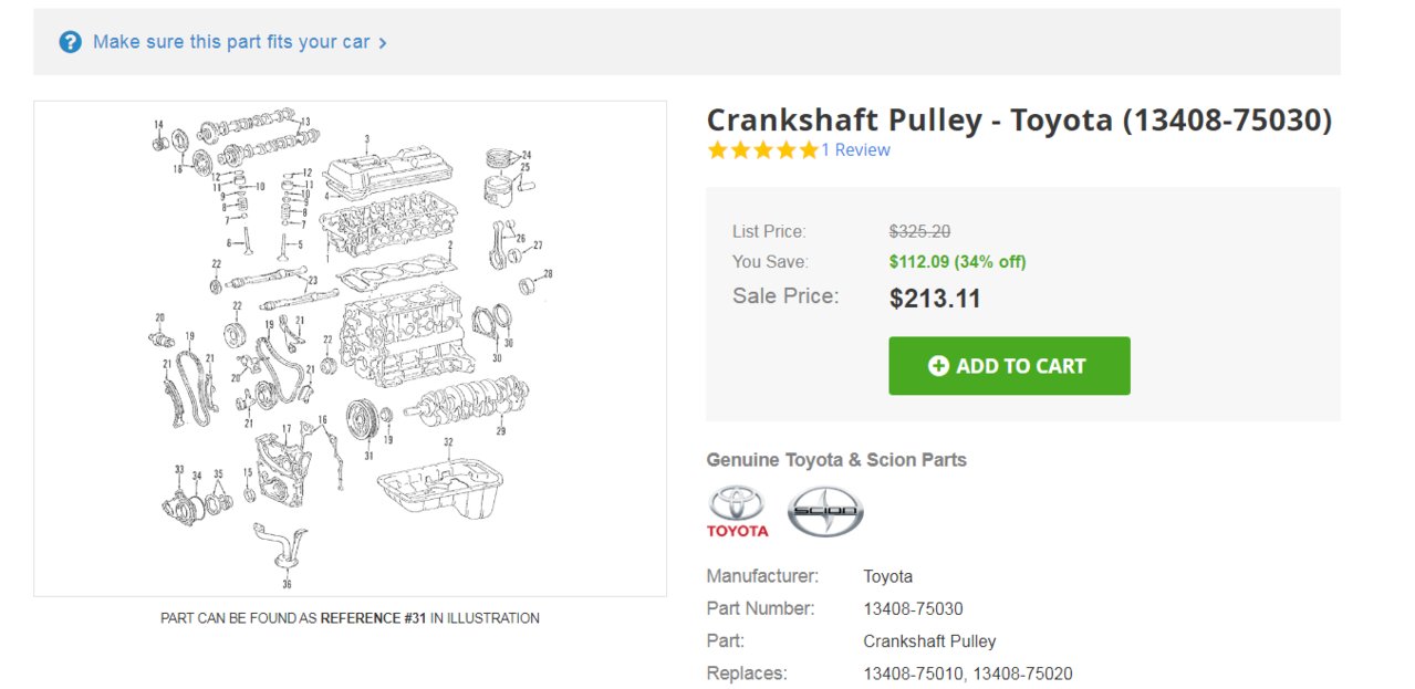

    The going online price for a new OEM 2.7L pulley is $213.11. The rubber damper will deteriorate over time just like hoses, belts, and tires. The dampers usually start making a squealing sound on acceleration like a loose belt -- but its not a lose belt. The noise comes from the inner pulley spinning inside the outer pulley.
    I've replaced a couple on my other vehicles that use this rubber damper approach. One was preventative maintenance since I could see the rubber starting to crack during a front main seal replacement.
    Be sure the FRONT MAIN SEAL is replaced along with the new pulley. Eventually, I will need to replace the one on my Tacoma 3.4L. Its just one of those rubber parts that doesn't last forever.
    Here's a picture of an outer pulley ring after it separated from the rubber damper.

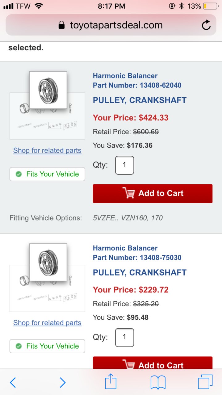

    Thanks for the help! So are harmonic balancer, crankshaft pully, and crankshaft damper all the same thing? And are the two parts in this photo interchangeable?

    I see the terms used loosely and often to describe the same part when all come in a single unit. Though, on one on my vehicles that does not use a rubber damper, the belt pulley and harmonic balancer are completely separate parts. It's best to verify the part with your vehicles VIN to get the exact part number.
