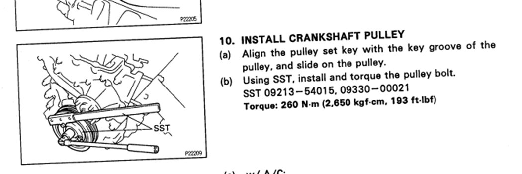

    Joined this group because I've been coming here from time to time reading taking notes throughout the years fixing up my old truck never signed up though until now so hello to all! I'm replacing my harmonic balancer and I just seen after looking for a installer tool that there is a seal after the harmonic balancer is removed but I don't recall seeing any seal after i got it off? Thanks for any help.

    Wsidr1
    Wsidr1 Well-Known Member
    Jul 11, 2018
    #259004
    3,078
    Indiana
    2 x 95.5 Ext 2.7L & 3.4L A/T 4x4
    crazytacoman likes this.
  4. Dec 15, 2021 at 6:22 AM
    Drebel
    Drebel [OP] Member
    Dec 15, 2021
    #384675
    7
    Dakota
    1996 Toyota Tacoma Ext 2.4l
    Thank you for the help! You don't want to know how far I would have gotten without the info! We'll see if it holds up after I put it all together. Have a good day to whomever helped.

    Got the correct part today and got everything in line but I can't seem to find the part in proper description that will finish my job maybe somebody can point me to a finish here with this.

    Need a tool to stop the pulley from moving so I can tighten the bolt. Don't want to get the wrong product again.
