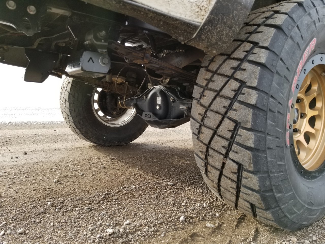

    Thanks man, yes they are bolted into factory holes. With the Archive Leaf pack and Hammer Hangers alone I'm pulling 15" of travel.:thumbsup:

    Thanks man, yeah I'm super stoked with the Hammers and Leaf pack that Eric offers. I would recommend installing everything minus the shocks and measure full droop. Bolt in some limit straps if needed to save the shock from bottoming out.

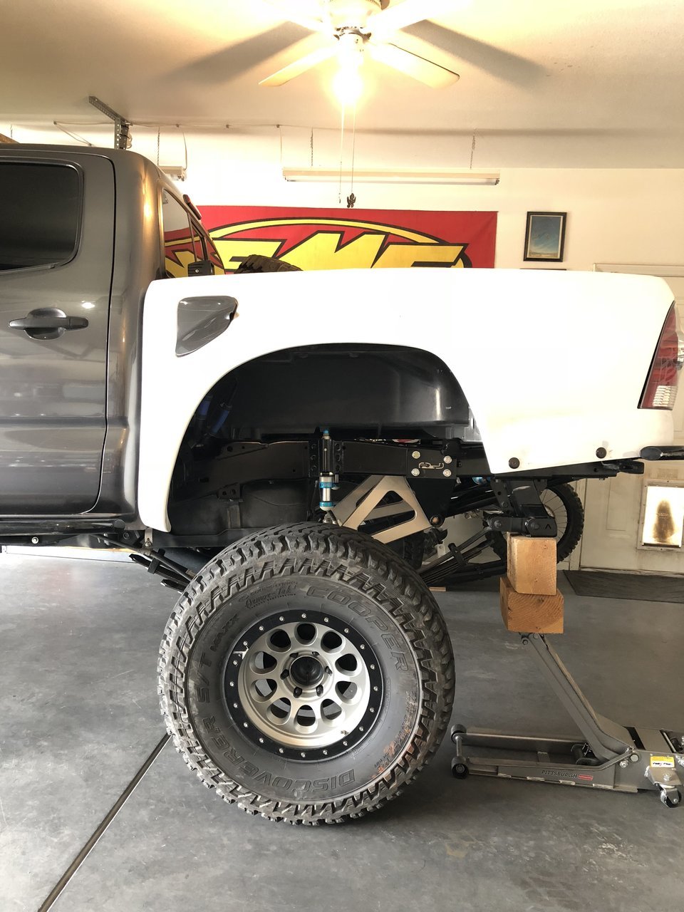

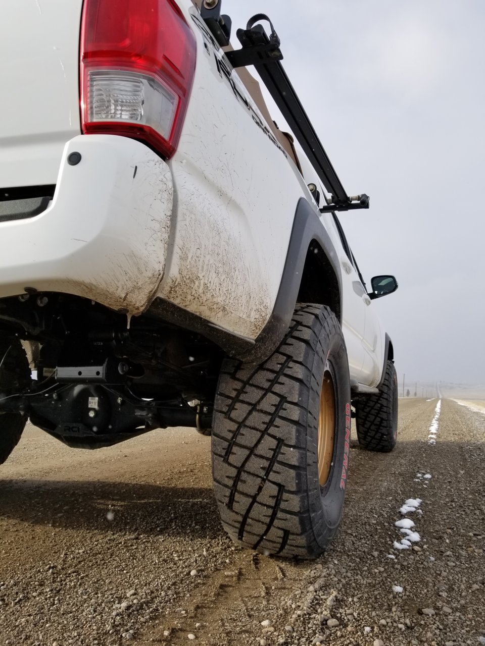

    Sorry work pulled me away. Just like Eric said, I'm at around 4-5" overstock. With my Bed cage, spare tire(37") and jack I'm over 200lbs in my bed everyday with almost zero drop. The pictures posted is with weight in bed and you can see how big the arch is still. This pack is perfect for performance and mild expo. For the 600-700lbs Daily driver guys defiantly go U402HD...Just let Eric know what daily weight you will carry and he will take care of you.

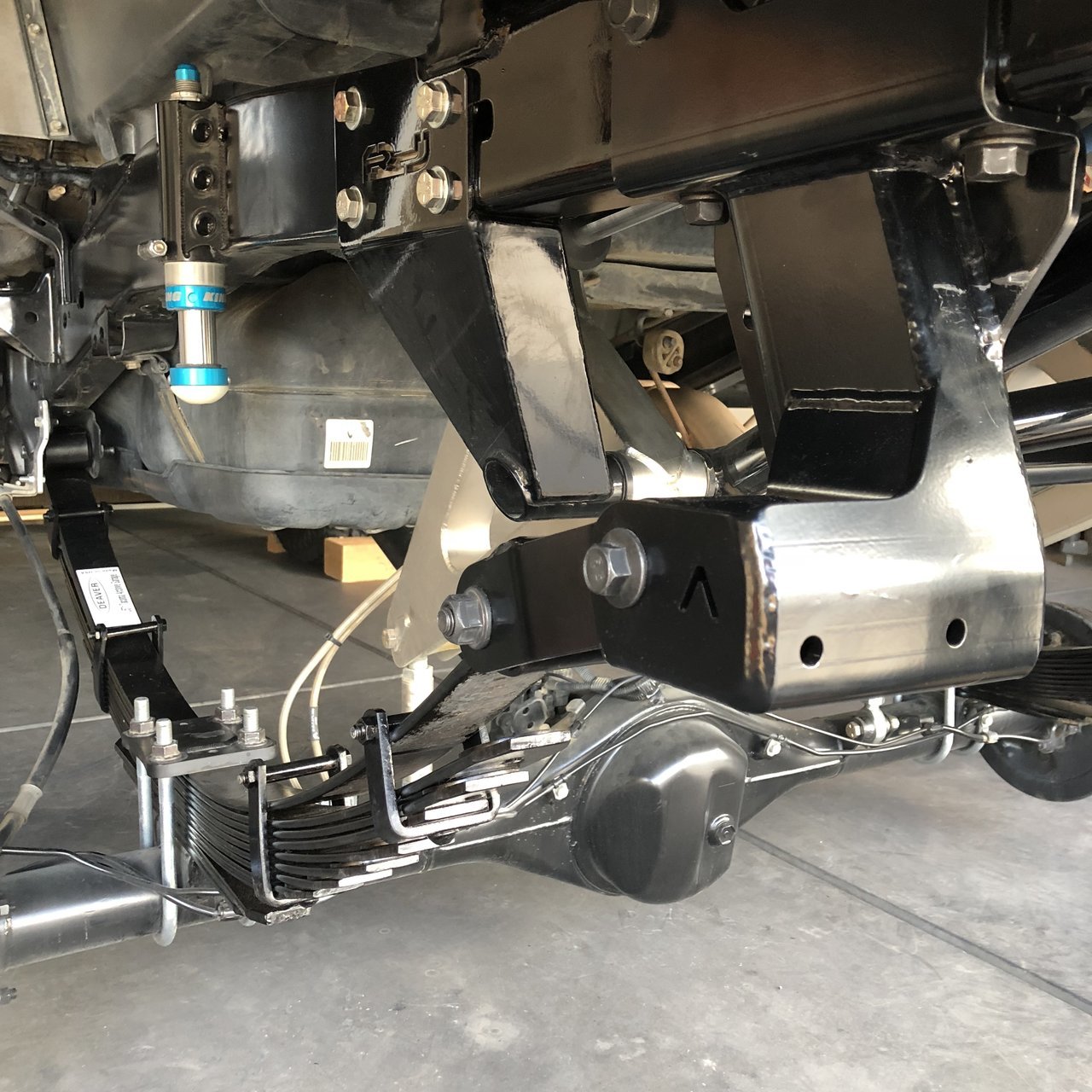

    I almost pulled the trigger on the Archive shackle flip kit, but now I'm really glad I waited for these Hammer Hangers. No measurements or flex shots yet, but here are some quick shots from the install and the end result on my 07 DCSB running OME CS047R Dakars.
    Crazy how flimsy and thin the stock hangers look, especially in comparison to the Hammer Hangers:
    I was somewhat worried about the clearance of the Hammer Hangers and the mounting brackets of my 4x Innovations HC bumper, but there is plenty of room:
    My OME Nitrocharger shocks are (as Eric predicted) definitely now the limiting factor in terms of droop travel, and so I'm looking forward to getting some longer shocks and continuing to test out these hangers. So far so good! :thumbsup:

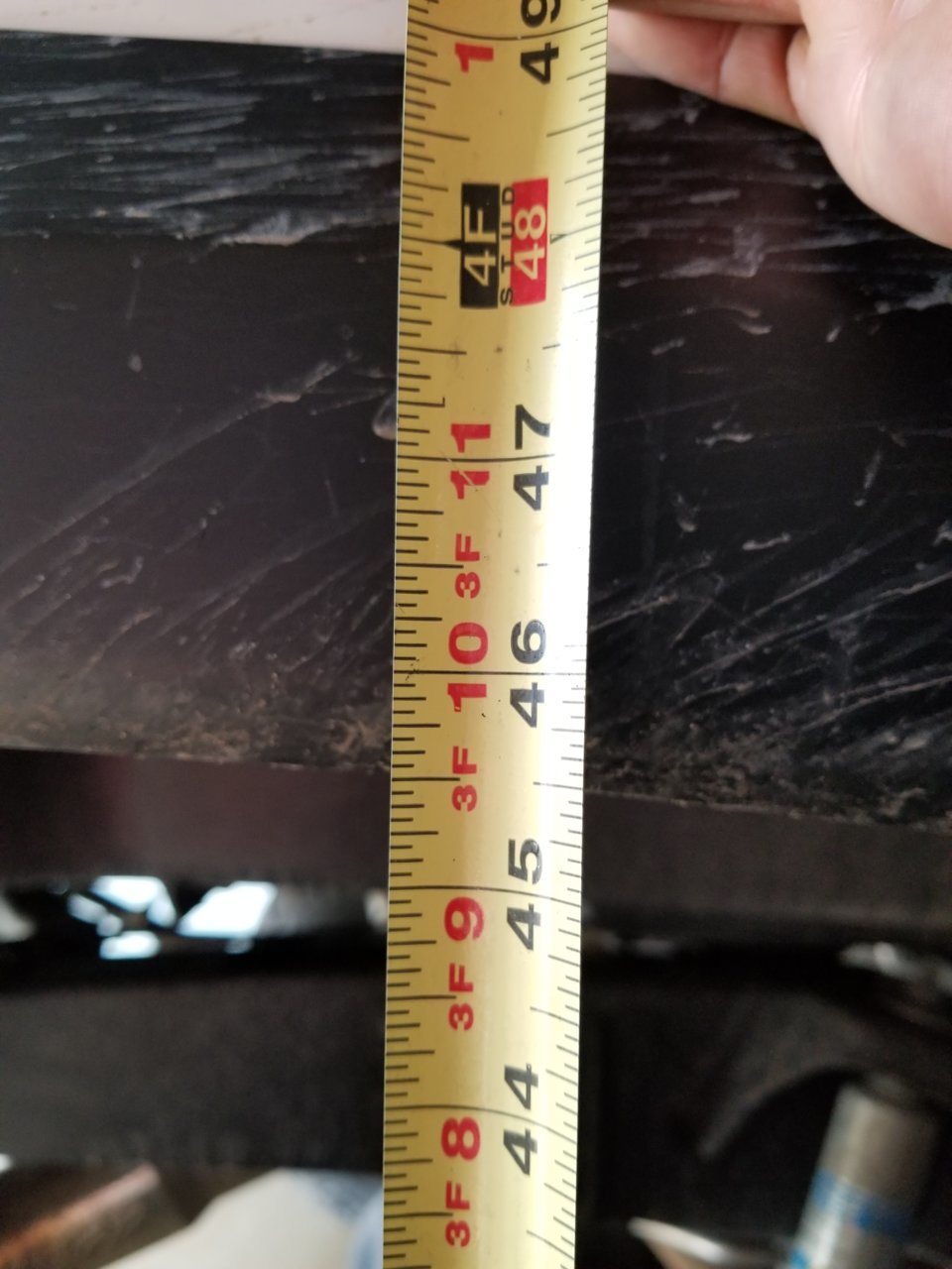

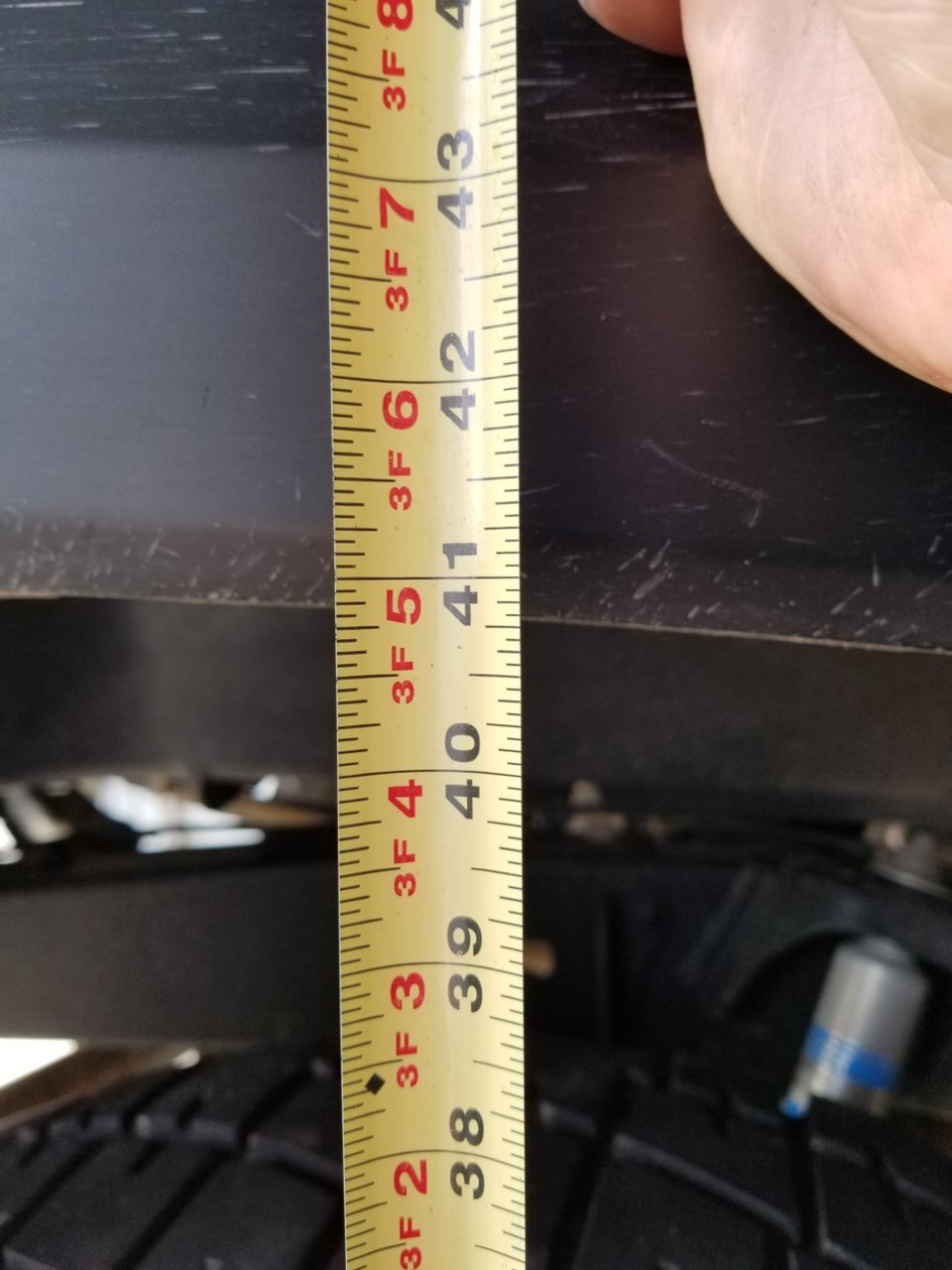

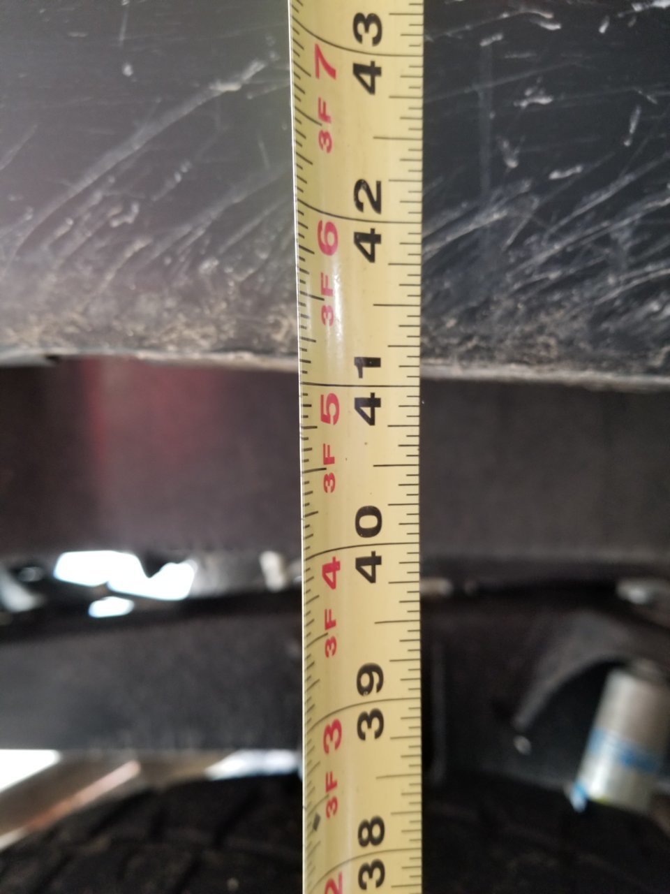

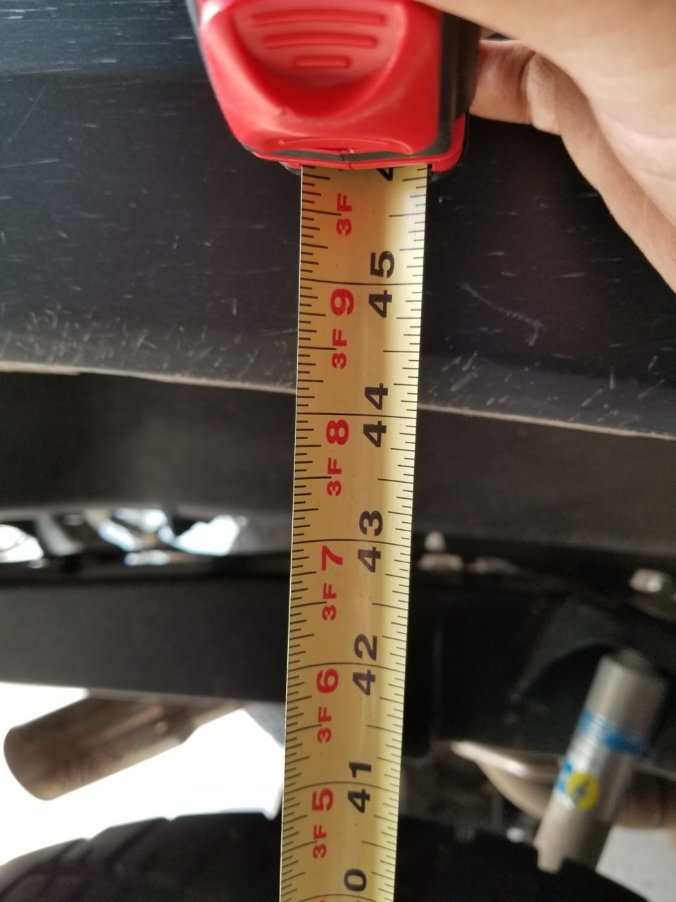

    Archive Hammer Hangers are on and what a difference. I didn't think it would be as good as it rides and that was just from a quick 10 minute drive. My setup is bilstien 5125 with Allpro Expos and archive hangers w/stock shackle. Will be paired with some 12" kings soon. Gained 1/4" lift and 1 1/2" of droop. Now my shocks are the limiting factor. Thanks @ARCHIVE
    First two pics are before and the rest are after.
    Before
    Ride height 40 3/4"
    Droop 43"
    After
    Ride height 41"
    Droop 45 1/2"

    Thanks for your support and choosing Archive! I'm thrilled that you noticed the ride quality difference, preach it! The droop gain is a nice improvement as well. I appreciate your taking the time to post results here -Eric
