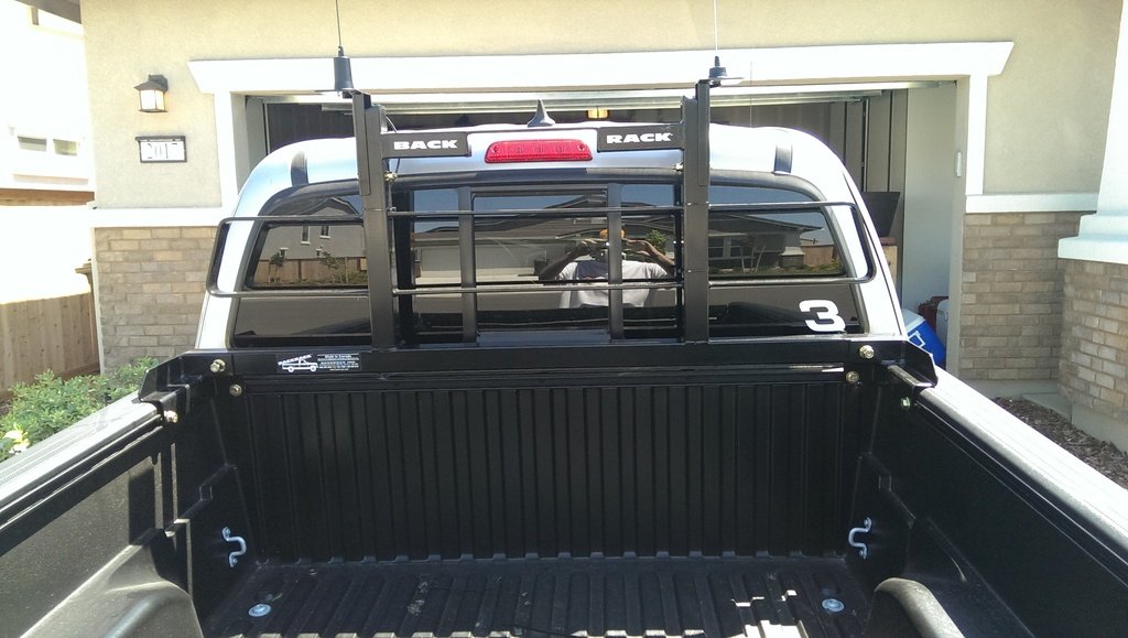

    I was going to roof mount my antennas (2m and a 2m/70cm) but I do not have enough room for the proper distance apart and to make it look right in my mind.
    For those who have mounted an antenna on their truck, other than roof mounted, where did you run the coax to the outside of the cab?
    Just curious before I start me install in a couple of weeks.

    Minimum of 18". the farther the better too. Thinking I am going with a headache rack.

    I ordered a Backrack Headack Rack. I decided I did not want to drill any holes in the roof.

    Thanks for the advice. I found a plug behind the drivers and passenger seats. I used a hole punch for the hole in the grommet. and also sprayed flex seal on it.

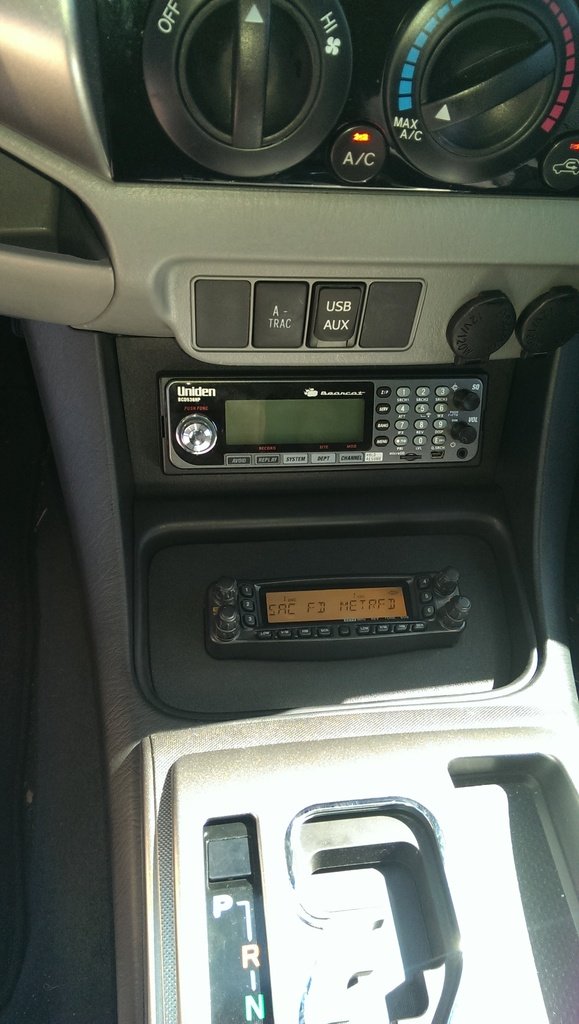

    Radios are now in.

    :eek: Oh my god that looks so clean. Good job :thumbsup: Any write up on the one mounted directly underneath the dash?

    I will confess that I have no skills in this area. I could not ever in my whole life do something this good so I had it done. I bought a DIN sleeve for the scanner to make it look a lot better. Also, you need special tools to remove the scanner since the DIN sleeve was used. I did do the antenna stuff myself.
