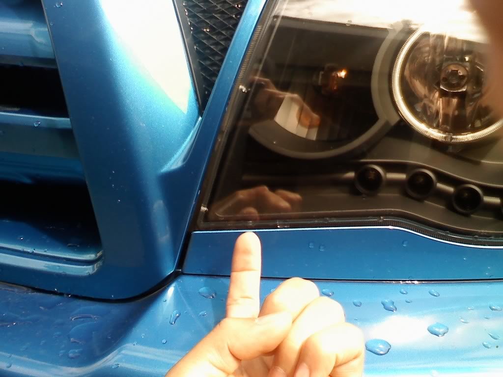

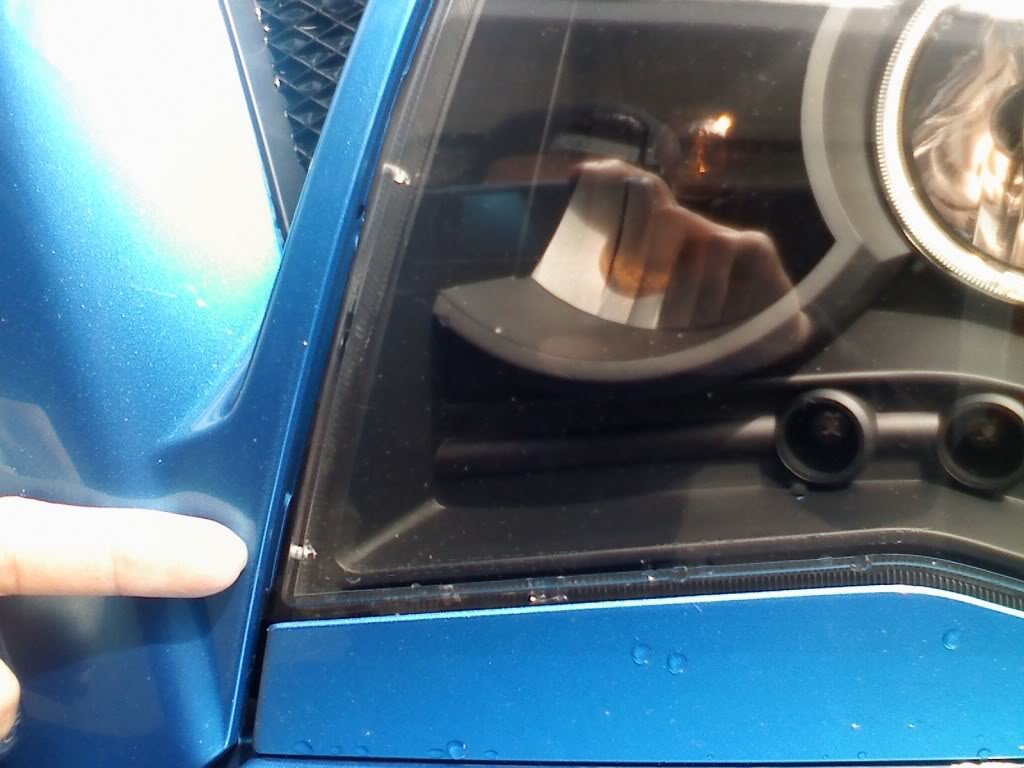

    Okay everyone we finally have a fix and it's very simple if you haven't done it already.
    Pictures were taken by Dizzle and it was his idea for the fix so I can't really take the credit.
    First take off grill and drill one hole using a 1/8 drill bit from the side.
    Second take off the plastic piece under the headlight and drill a hole from the bottom.
    Very easy
