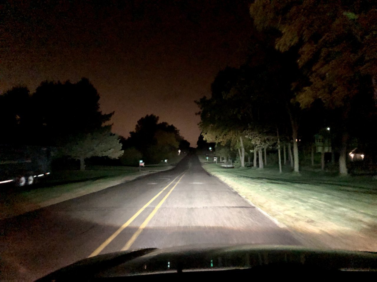

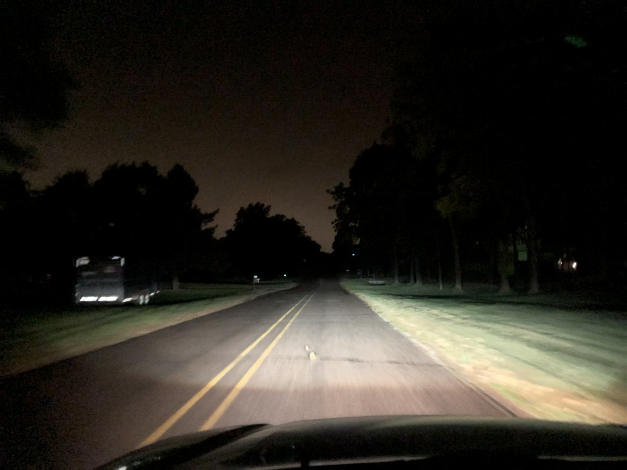

    LEDs perform very poorly in smaller housings like an H1. You will have a significant lack of focus and major loss of distance projection. An LED will perform worse than stock. Instead I would suggest Osram Nightbreaker Laser +150, which is the highest efficiency H1 halogen on the market and perform significantly better than stock.
    Edit: I should add aftermarket housings have very poor optics to start with and are a significant downgrade from stock. Unfortunately a good bulb cannot fix a bad headlight, and Eagle Eyes headlights would be a bad headlight.

    If set on LED though, the Hikari Ultras are the only one I’ve tested in an OEM 3rd Gen H11 projector that tested better than a stock bulb. However they were easily outperformed by a performance halogen. While you are using a poor quality projector and won’t get the same results, and running an H1 vs H11, you might consider these:

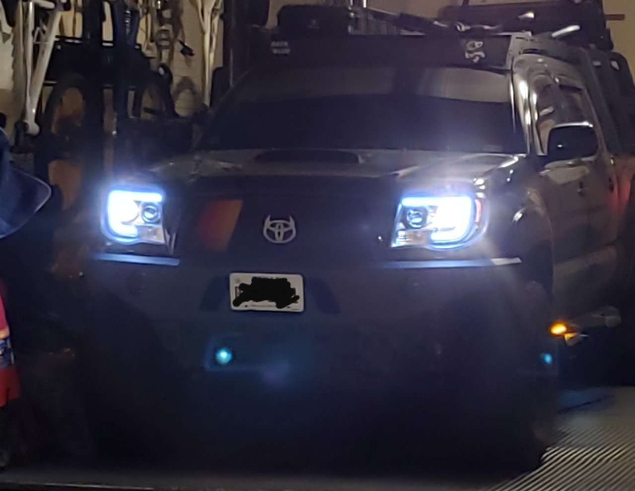

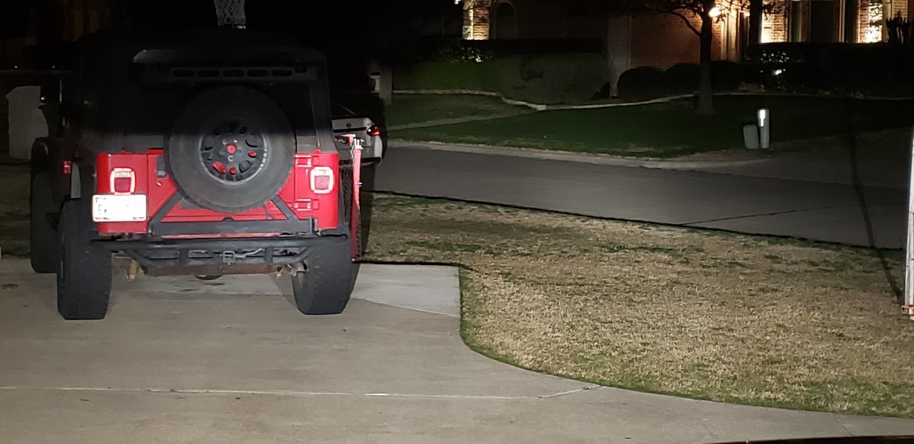

    This is my beater Subaru with that kit and 5500k bulbs. 5500k is the highest kelvin rating you want to go, any higher the color is too blue/dark to work well in poor weather. Also the higher you go in the kelvin rating the lower lumen output you have. 4500k would be best, but most like a little whiter light for style points. Granted this is a cell phone picture, keep that in mind.
