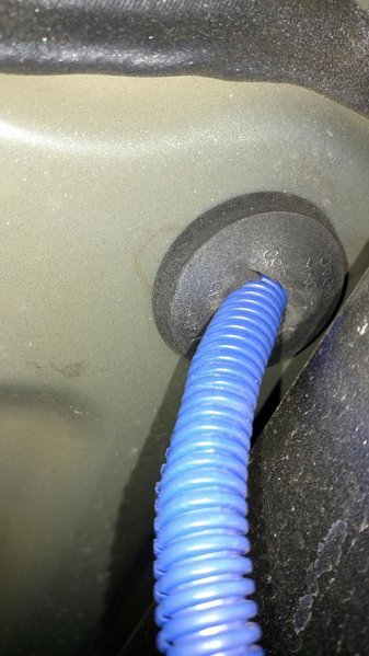

  10. Jun 8, 2016 at 4:19 AM
    2016BBP
    2016BBP Well-Known Member
    Feb 25, 2016
    #179323
    831
    Southeast
    SR5 V6 Auto
    Method Wheels, WxTechGuards, TowPkg, KNDropn, 3M-Tint
    There is a rubber grommet in the passenger side rear floor board just to the rear of the seat bolt for the front seat.
    As you can see in the pic below, the grommet is just above the frame on the passenger side.
    Cut a slit in the grommet and only make the hole just big enough so that what ever size cable you put through it that it still takes a little force to get it through the hole and you will know it is not too big of a hole.
    Removing the passenger seat bolts makes it easier to raise up the carpet on the side. Depending on where you route your cable from there will depend on if you need to remove both seats, carpet etc.
    There are several other grommets to choose from but this was the biggest grommet that I found and it is the easiest to get to without removing seats etc.
