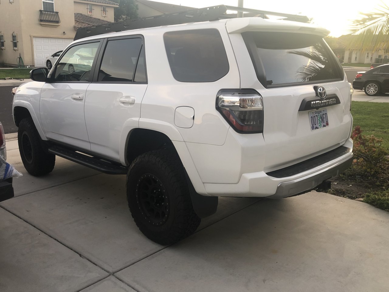

    05DFBCC9-3172-42D0-9092-4DC7187EDCEE.jpg Hey how’s it going everyone. Just recently got a Super White OR (wife’s) that we’re planning on building for general camping and exploring. I’m just documenting what I have in mind to keep me on track and hopefully get some feedback as well.
    The wife and I are planning on doing a lot of exploring/camping on the West Coast and are looking to build it to suit our needs. Lots of plans for this build so we’ll see what it ends up looking like.

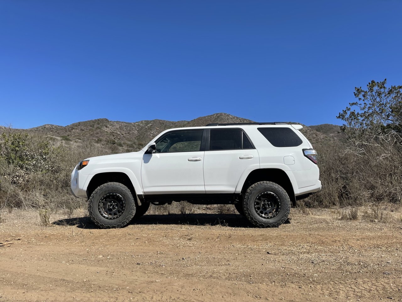

    How it currently sits.

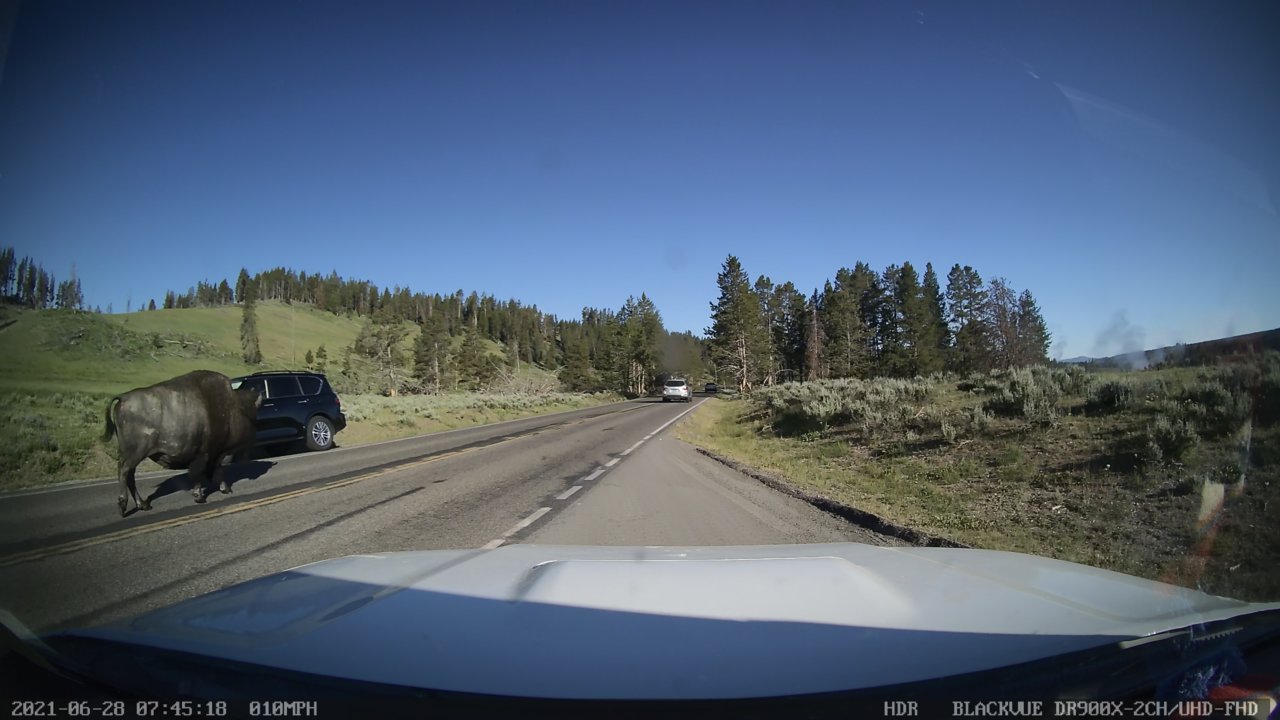

    ED65F7E8-37F8-4F95-97BB-5B4CBEF40FA2.jpg So far I have no complaints with the Blackvue camera.

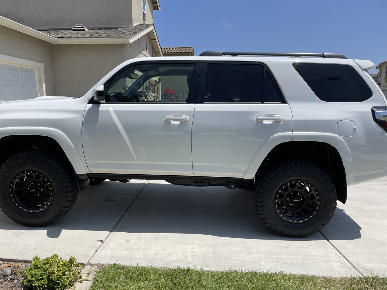

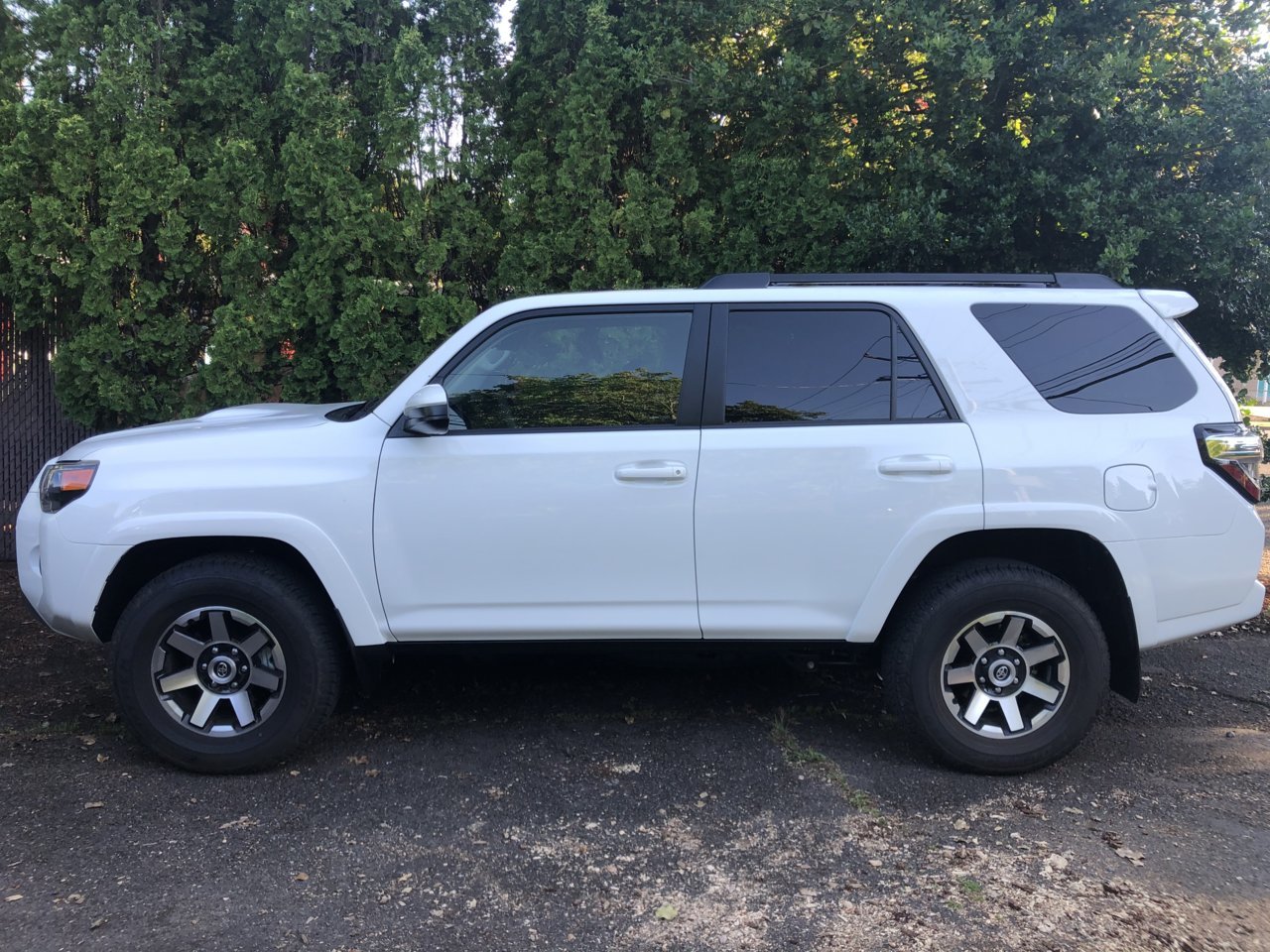

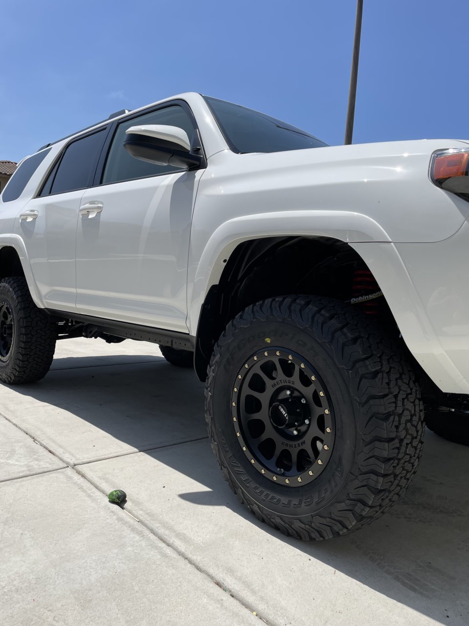

    70D294BB-E196-4190-A091-C2C9954ECDEA.jpg 4857D1FC-F9A7-4645-8AFA-323DFC2E9CD4.jpg
    It’s going to sit a little bit lower once all the extra weight is added on. So far I like how it’s looking.

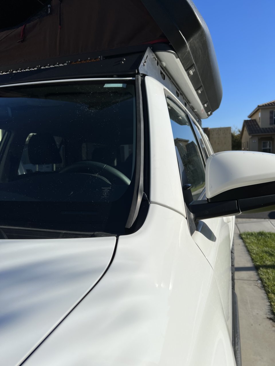

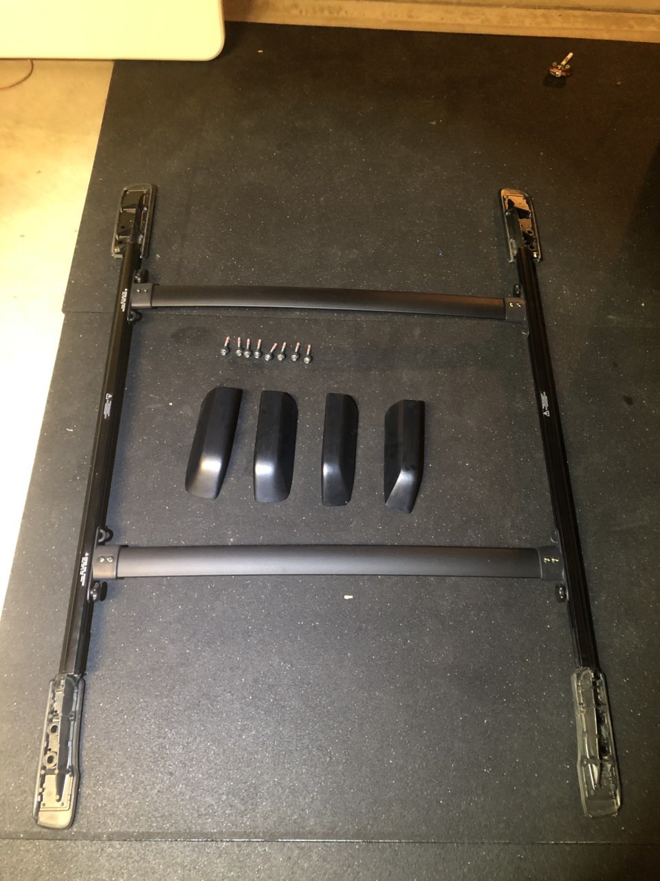

    Ordered a Sherpa Crestone roof rack through C4 Fab and one of the crossbars showed up untapped. I called Sherpa and they shipped me another crossbar the same day. Pretty solid customer service. It was a pretty easy install overall though. Feels sturdy and makes it look a lot cleaner. F09B24A6-4643-4C8D-96B5-997DFCC36955.jpg
    Is anyone in the market for an OEM roof rack? I posted up OEM wheels/tires, and suspension parts but there doesn’t seem to be much demand for any stock parts. All these parts are just taking up precious garage space.B3A8E501-2575-455B-A773-D6F376E1BE0E.jpgC43532CB-0A53-405B-96EC-898060AE0C8C.jpg

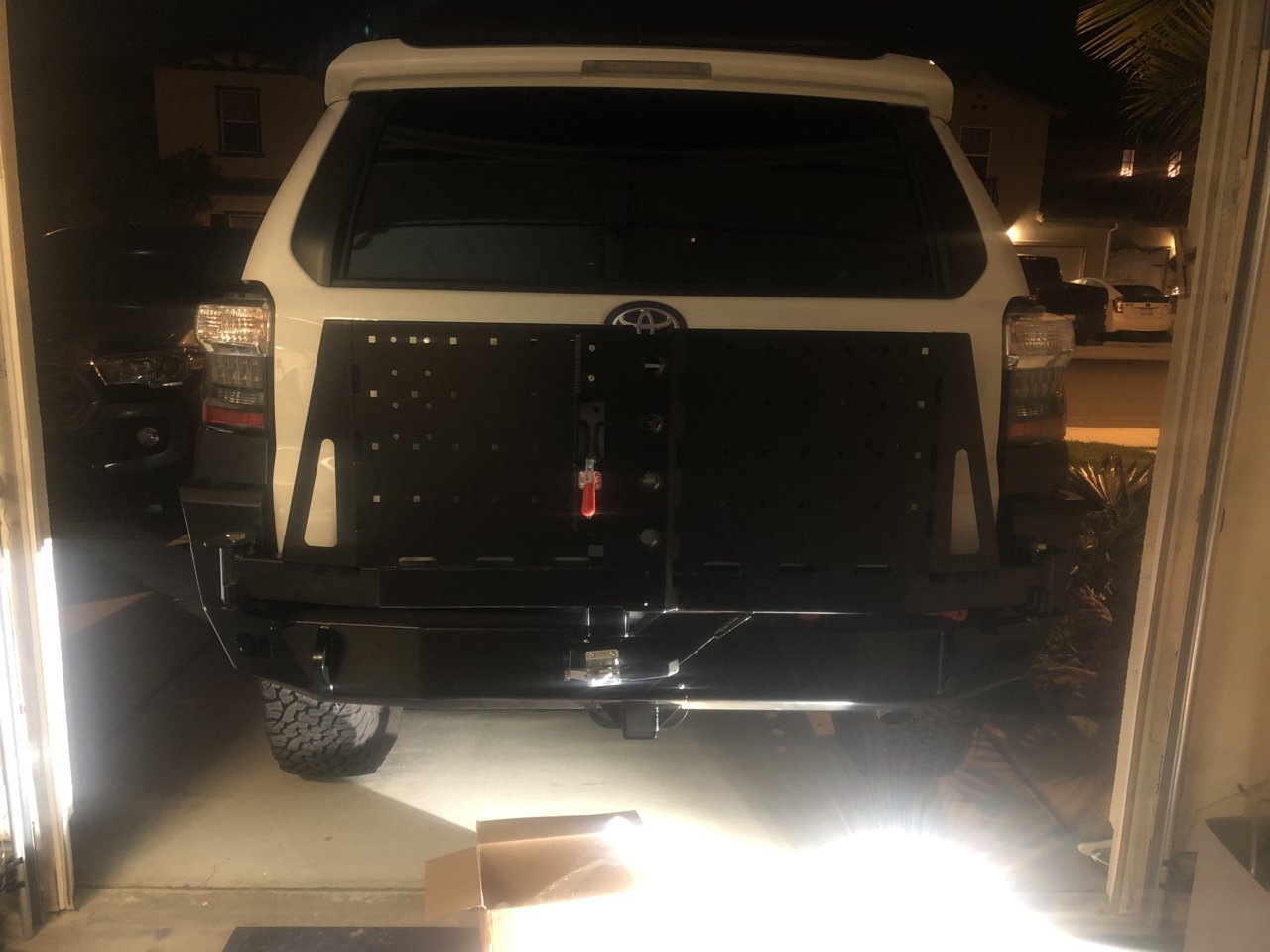

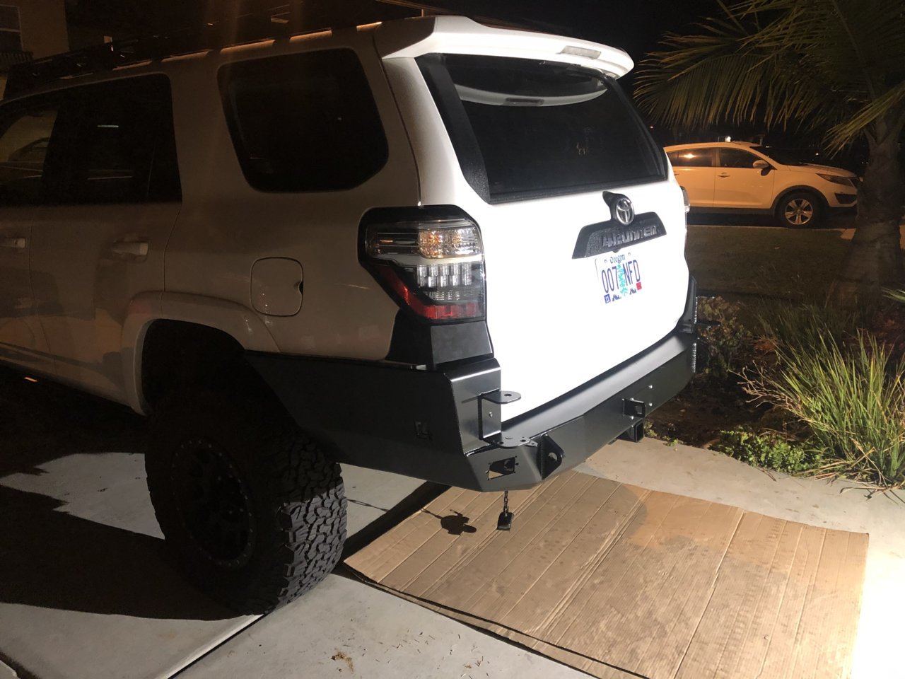

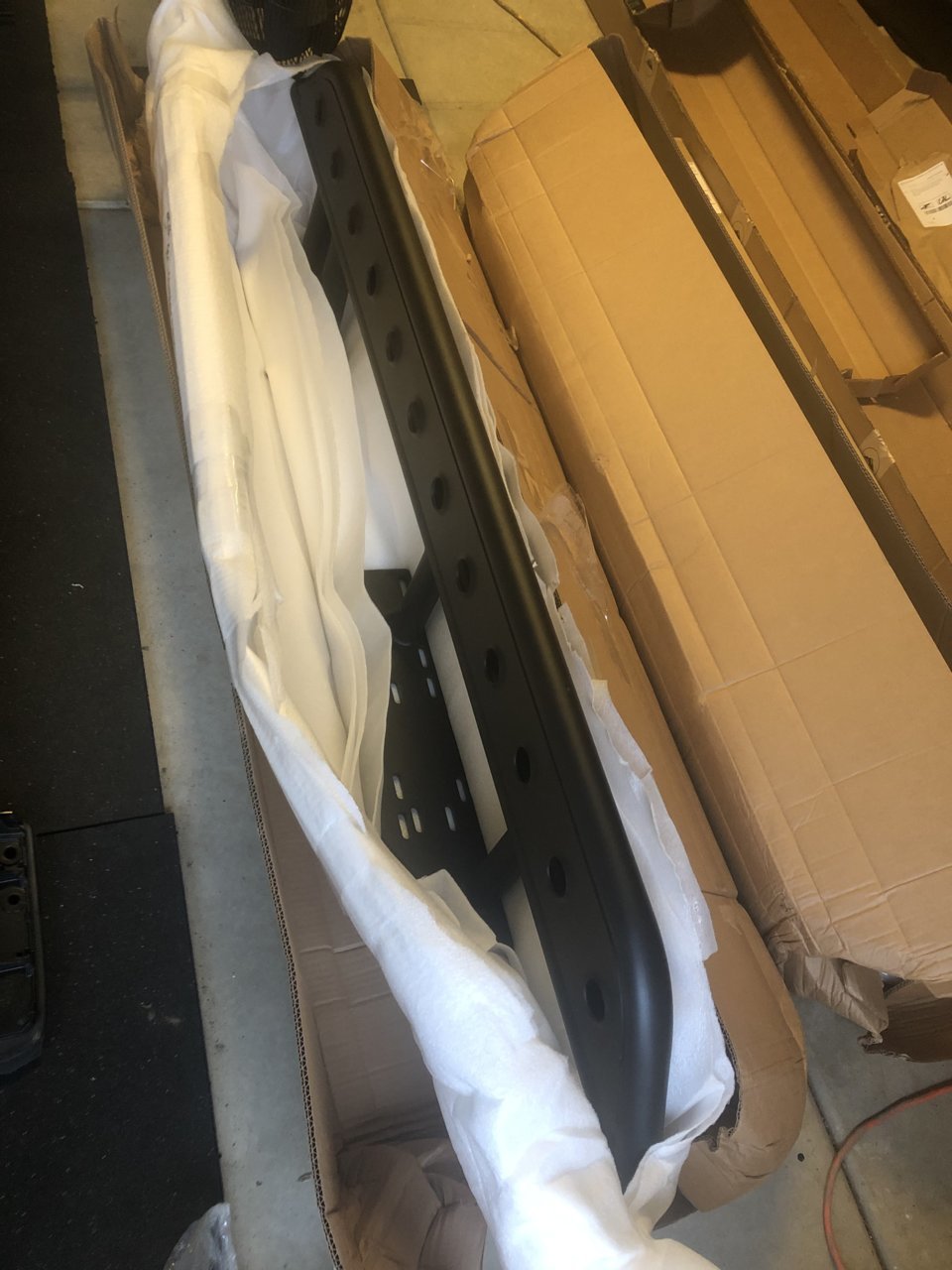

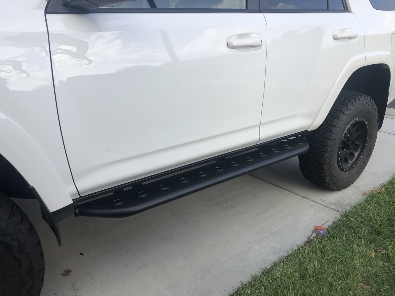

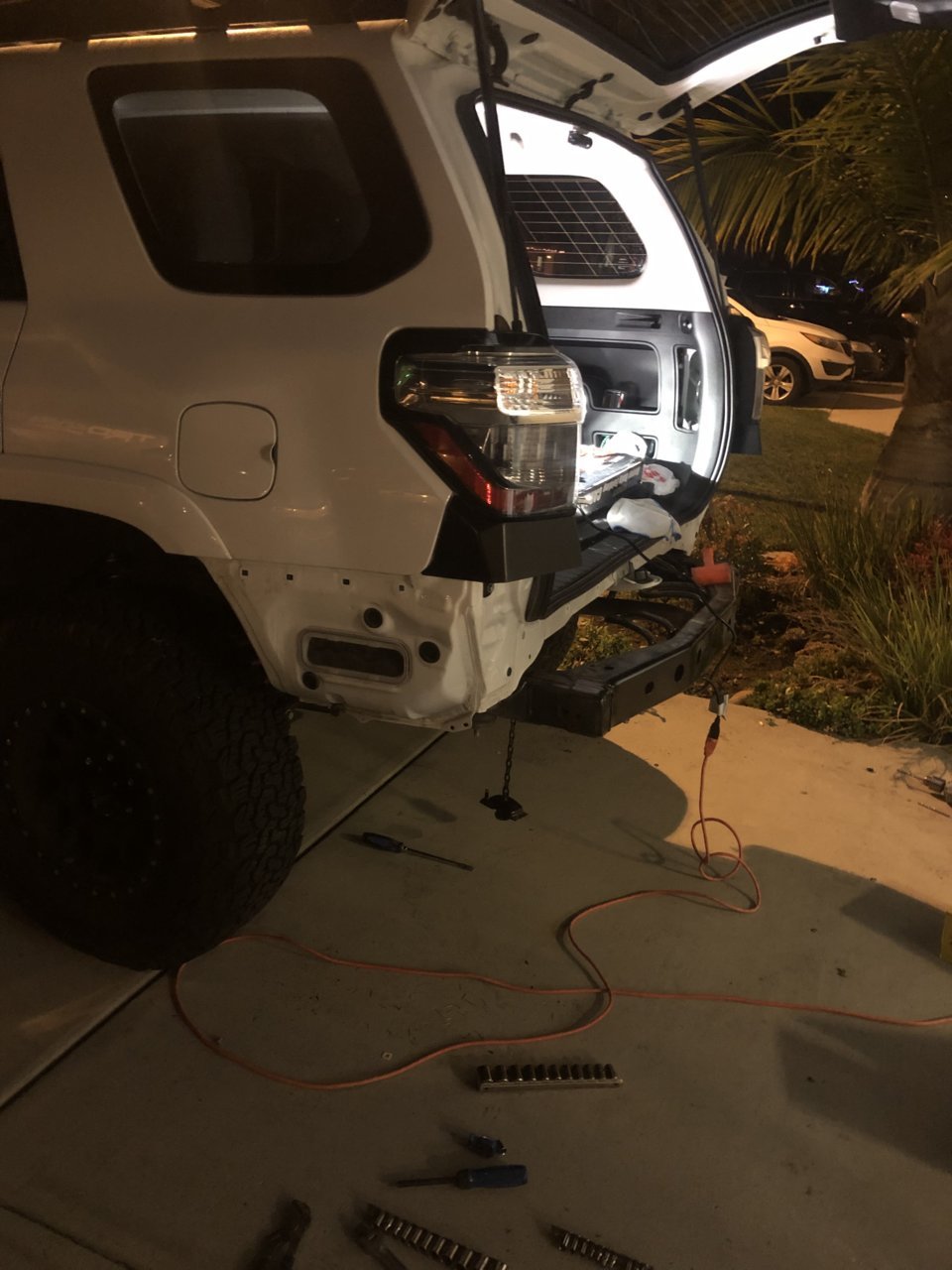

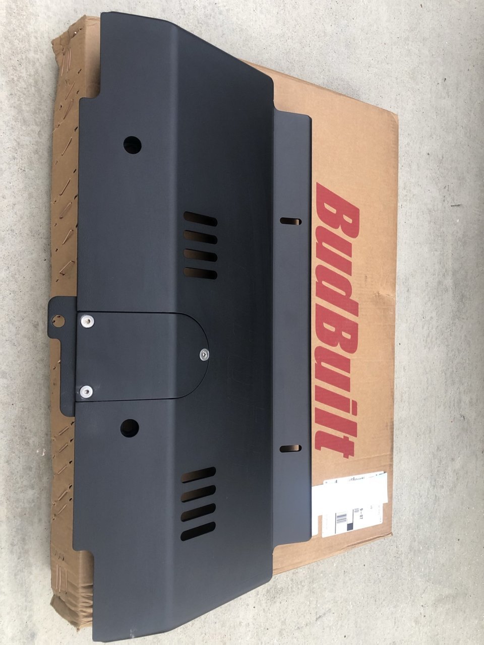

    I kept hearing about Budbuilt armor and the quality of their armor and was not disappointed when I unboxed them. The welds are beautiful and they bolted right on to the frame. C6A3DDE9-2B8D-4D23-8F7E-B134D3E2EC63.jpg 10A23530-50E7-40A2-8DD6-D46DE494C195.jpg
    A4ACC813-8EFE-49E6-8DED-9ABB6BB9FFDA.jpg This is the only picture of the skids that I took and it was another easy install. I started the install in the front and the only issue that i had was due to my previously installed diff drop kit from Exit Off-road. A quick run to the hardware store and i was back on track. The armor also connects to the next piece As seen in the picture. I do wish they were a little more active on their Instagram/YouTube so I could get a slightly better visual on how it looked installed. C8CFFDE6-EBB8-4794-84C3-86E2D51FF451.jpgA1C7109E-2A04-4AFA-A487-B5C5B4F1228D.jpg

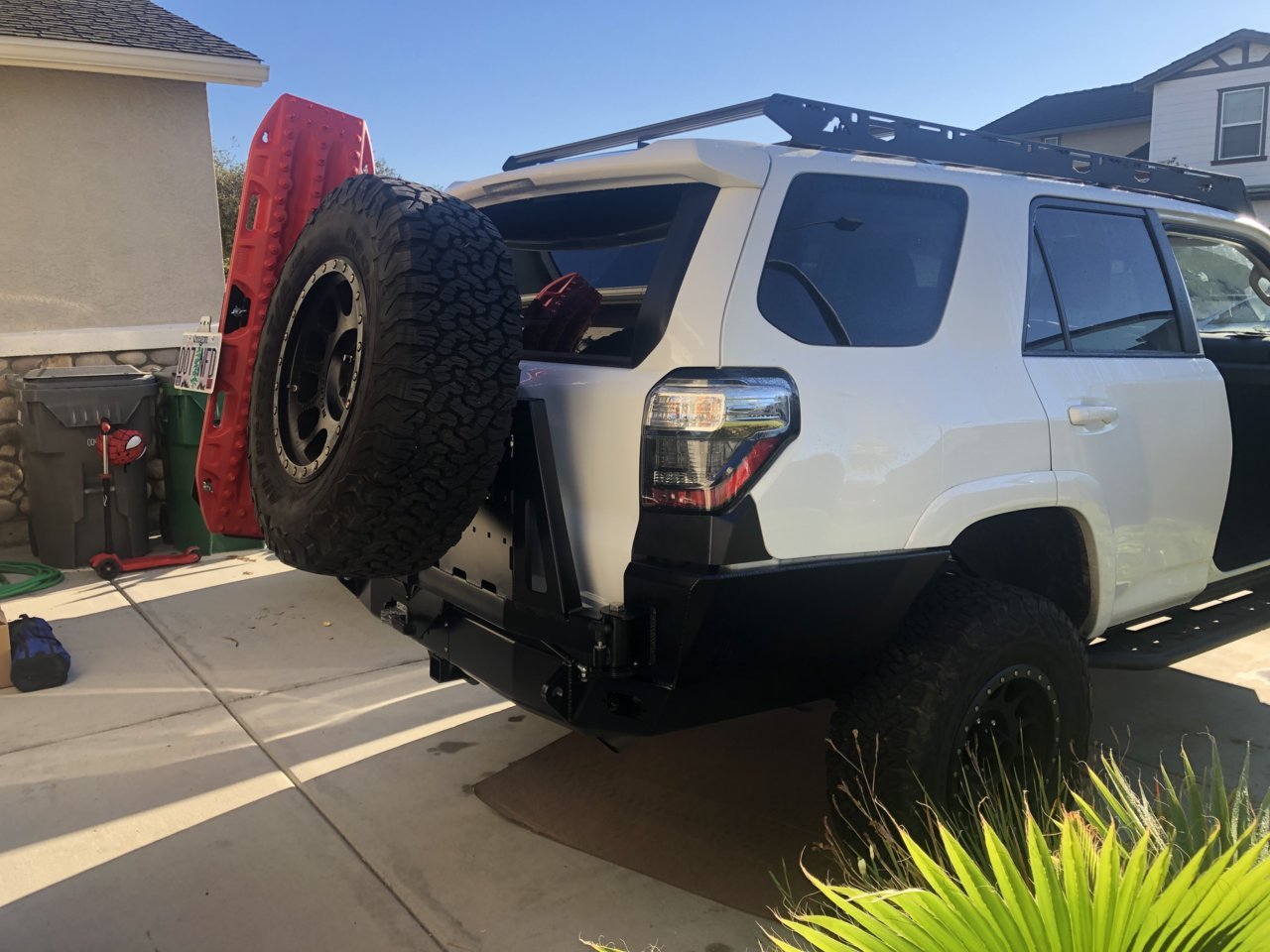

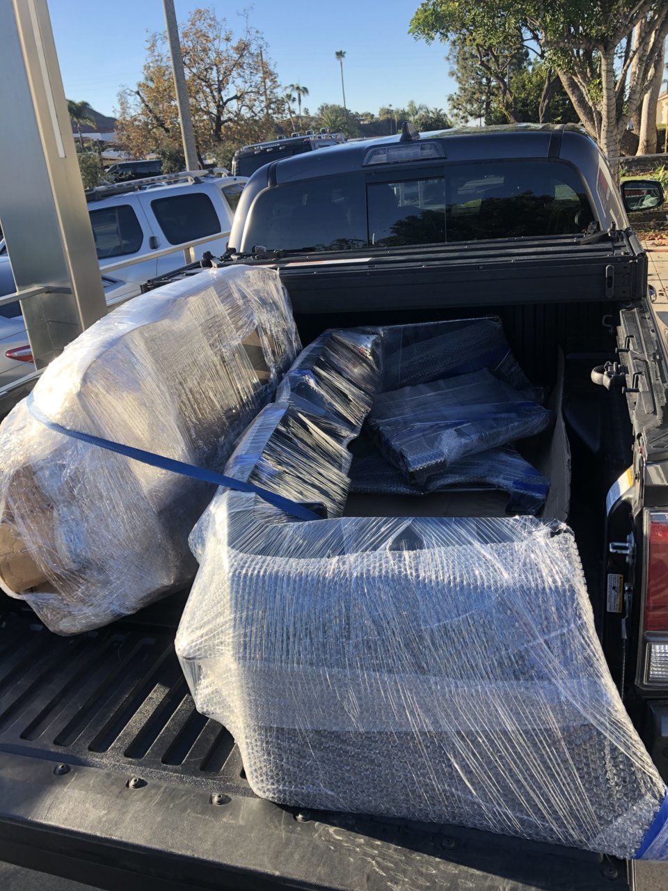

    Picking up the bumpers after powder coating. I’m still a little upset that there was no powder coating option straight from C4. Quick reminder for everyone to secure your tonneau in a way that it can’t fly open on the freeway. (Ask me how I know…)BCC71255-8275-49BF-B3D6-0FE832D6A344.jpg

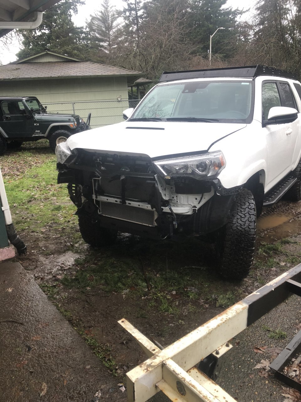

    The only thing I would do differently if i had more time/patience is prep and paint where the bumper would cover. Only reason for this would be simply aesthetics.
    A few hours later of awkward lifting.
    Forgot that I would need more lug nuts to keep the tire on..so another Autozone run for me.E0DC94AF-A47B-46D3-A161-ADCD53B4E59F.jpg

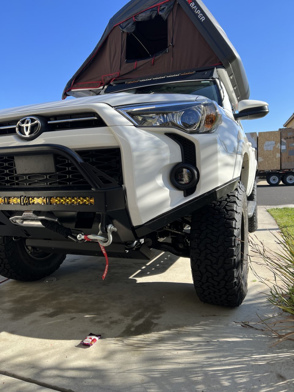

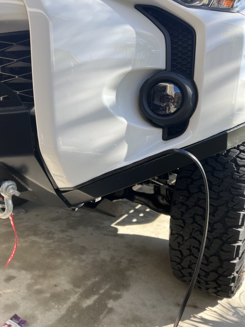

    I didn’t take enough pictures of the front bumper but it was also raining quite a bit the entire time and I was too worried about cutting the bumper. I definitely think I could have ended with a cleaner fit but I ran out of time and mainly patience. Installing the winch was very straight forward but I don’t have any pictures for that. 5656F25D-B22B-48E2-BDBE-96D6E2F73CBC.jpg
    Skycamp 2.0 came in so that needed to go on too. Install went by as smooth as it can when you’re lifting a lot of weight over a lifted 4Runner..53EBA900-84A9-4C9D-9540-B04C3C1DB70A.jpg

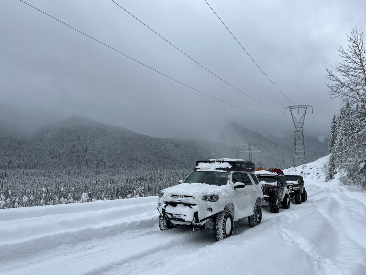

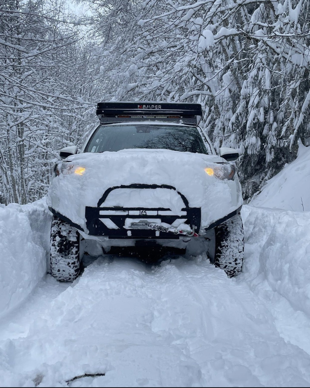

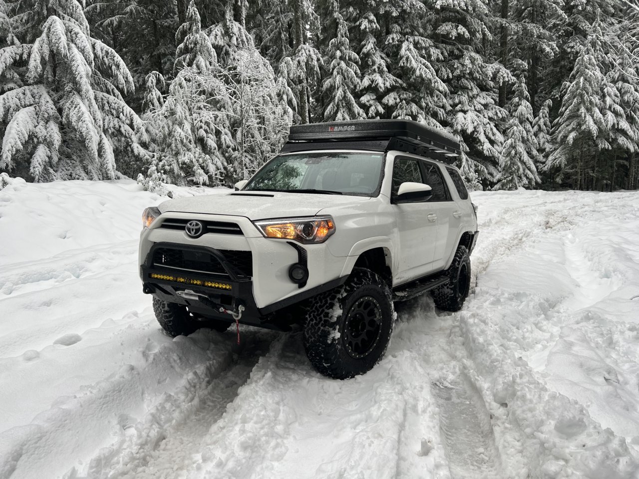

    Got to play in some snow near Mt Hood National Forest. Actually got a chance to use the winch to pull out an older Dodge who’s clutch went out!2A7E69C0-5612-49BD-BA6D-17936926377E.jpg

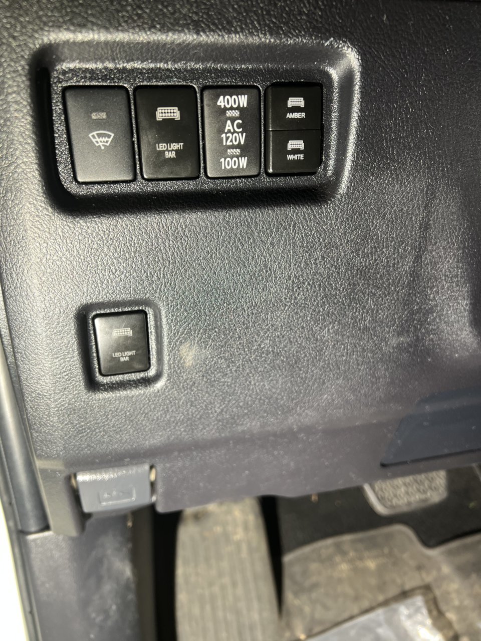

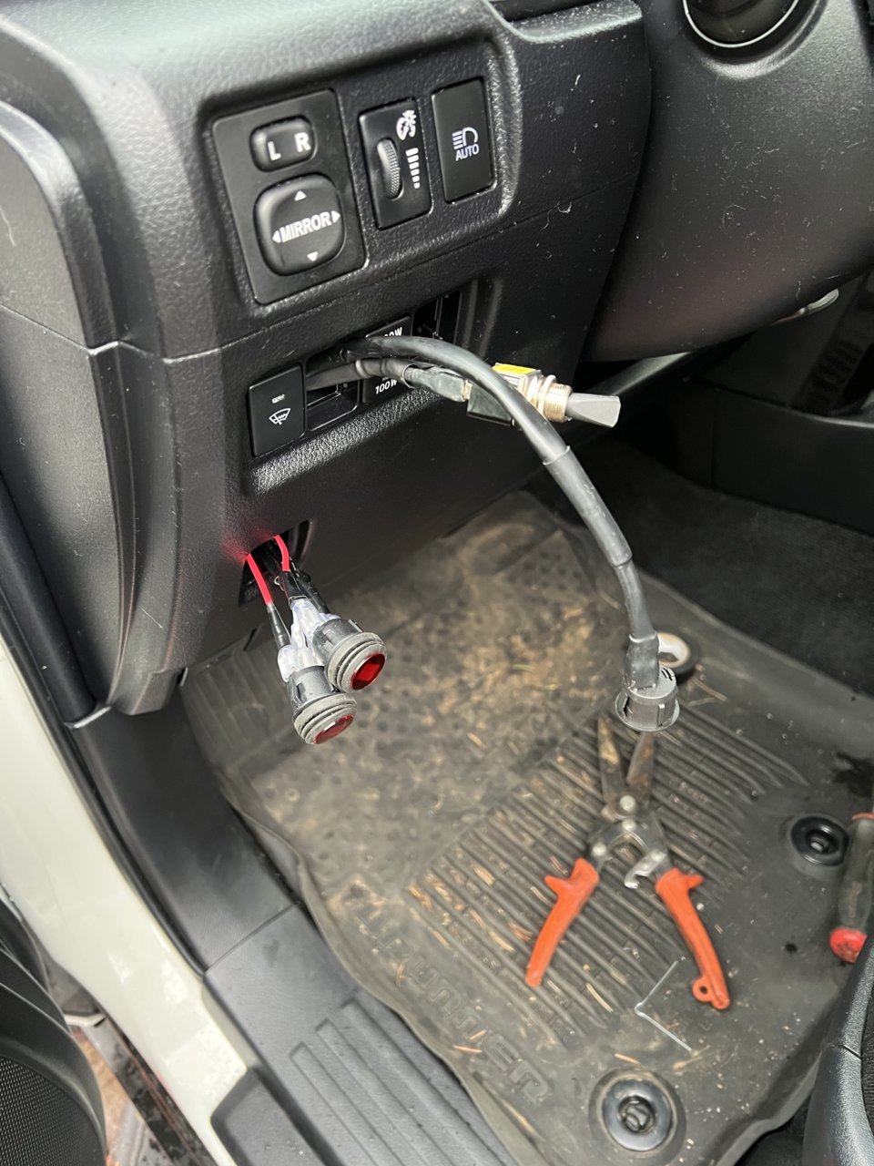

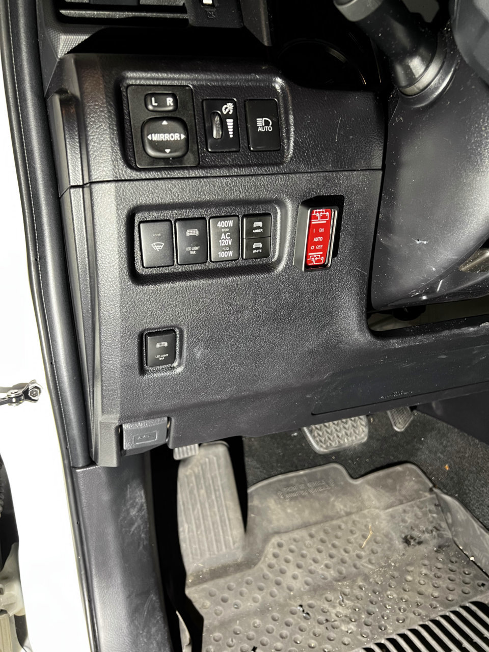

    Ran the wiring through the firewall and used these switches from CaliRaised for the clean OEM look. Had some issues with the buttons not clicking on/off and this was solved by adding 1-2 wraps of electrical tape around the switch. My big complain was that the switches did not come with diagrams and the videos that were on the website were not very helpful. Maybe I didn’t look hard enough? 7AE9F3DB-36F8-499D-A52D-4A304CBAA2EB.jpg8BCBBCE6-DF58-4CEE-8B14-A9F79BB92ED8.jpg

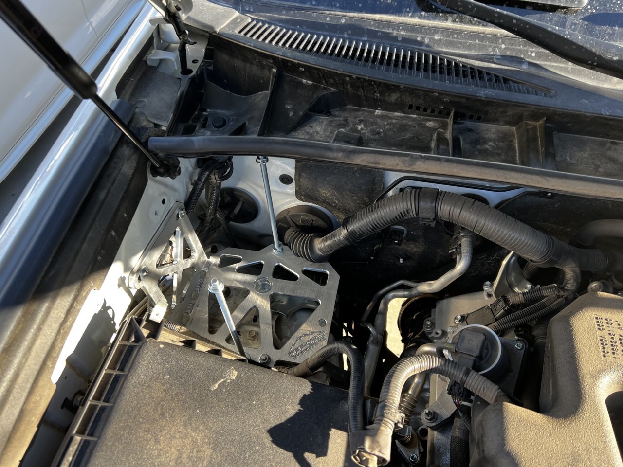

    Offgrid engineering dual battery kit just came it…looking forward to this install.

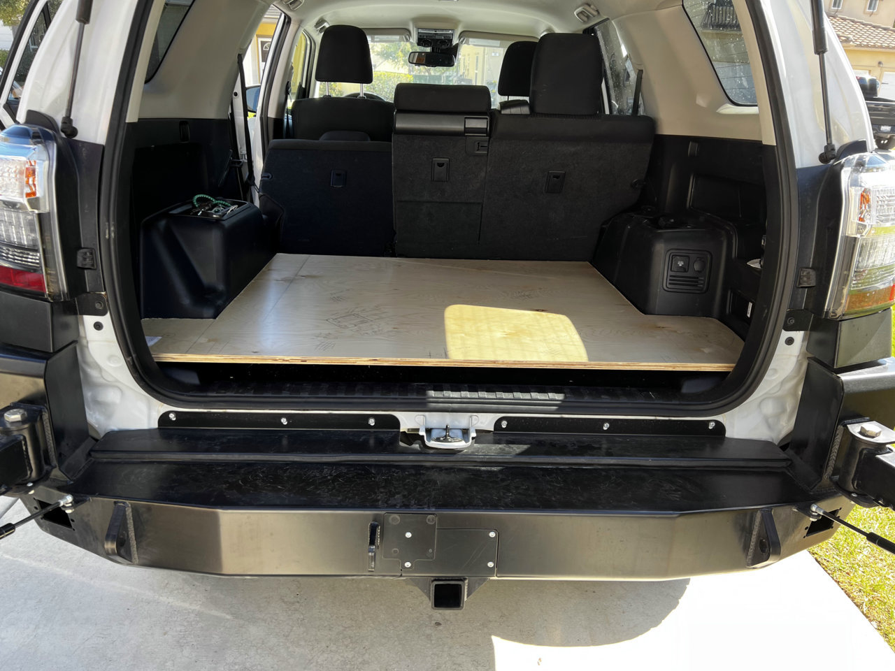

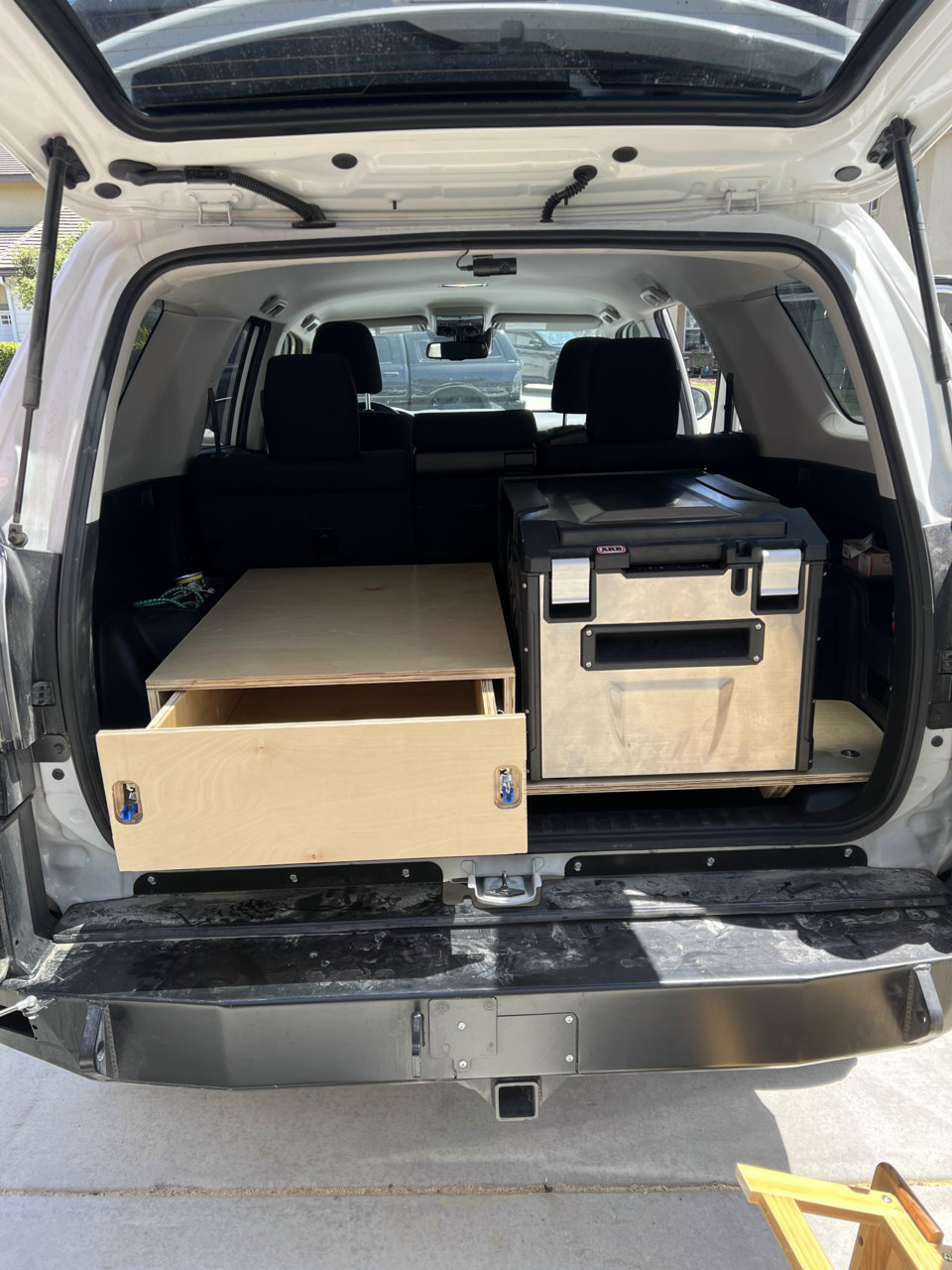

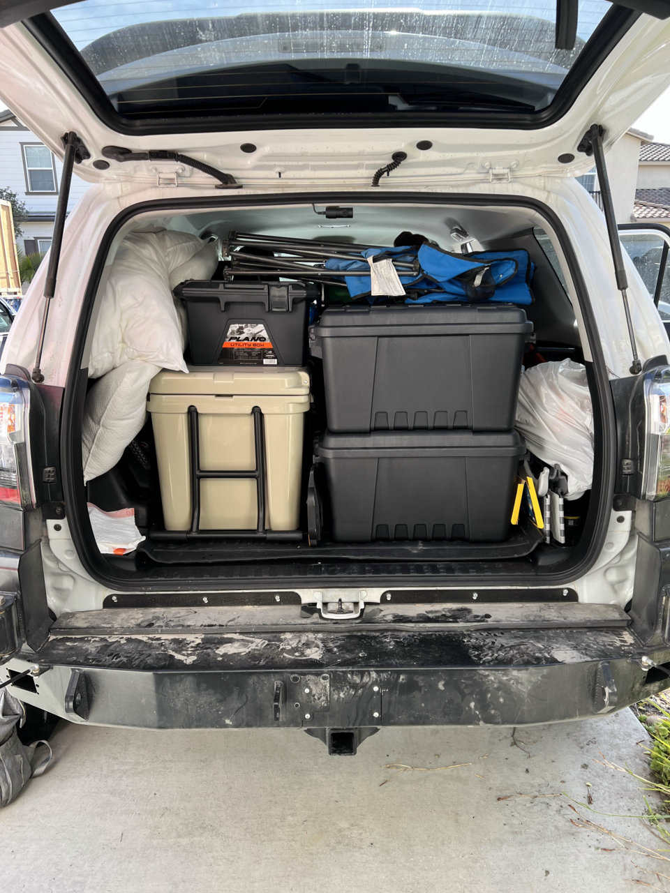

    Ive been working on storage for a few trips now. Started off with this and decided i wanted some drawers so I started doin some research and found some inspiration.
    I started off with this as a platform and used the 4 existing anchor points to bolt it down. I used longer bolts so that there was no drilling involved and it would keep this from sliding around. Might be hard to see but there are 3 supports that run underneath to accommodate the height difference around the wheel wells.
    I think i could have gone with thinner wood to shave a bit of weight off but maybe ill do that in the future. I contemplated getting a slide out rail for the fridge and deciding i didn't need that and i didn't want to have to dig behind the seats if anything ended up falling behind the fridge. I am trying to figure out a way to make the fridge a little easier to remove. right now its currently bolted down on 2 rails. 1 towards the front and 1 towards the rear. I had to install it by lifting the back end of the deck and reaching the nuts underneath that way.

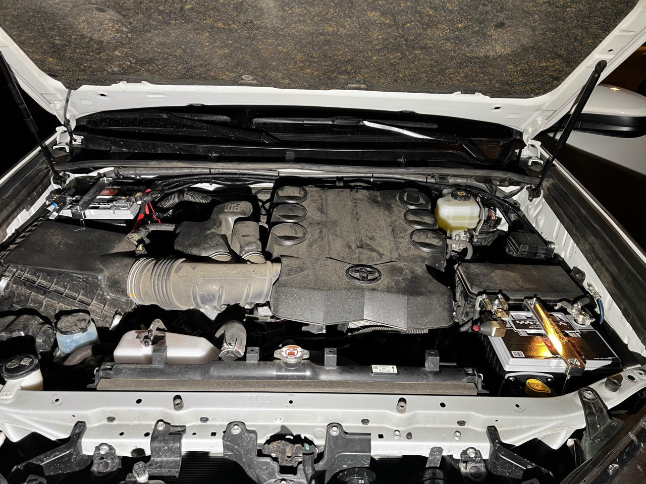

    Dual batteries are in and I have transferred all of my extras to it. Including: winch, lights, and constant power to rear outlet.
