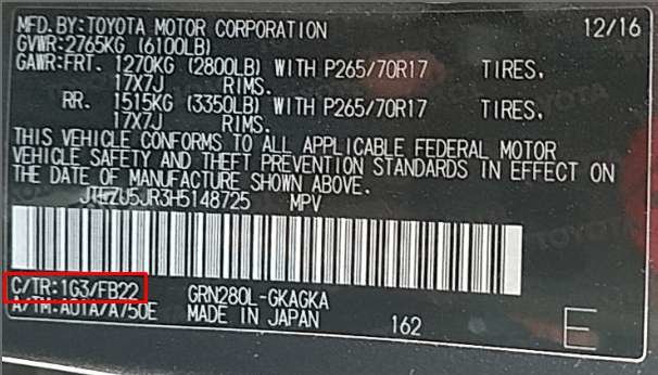

    It's on your vin label on the inside of the drivers door.
    It's the basic configuration of the truck.
    I googled Tacoma vin and this came up, I can tell by the vin and tire size its a 4runner lol.
