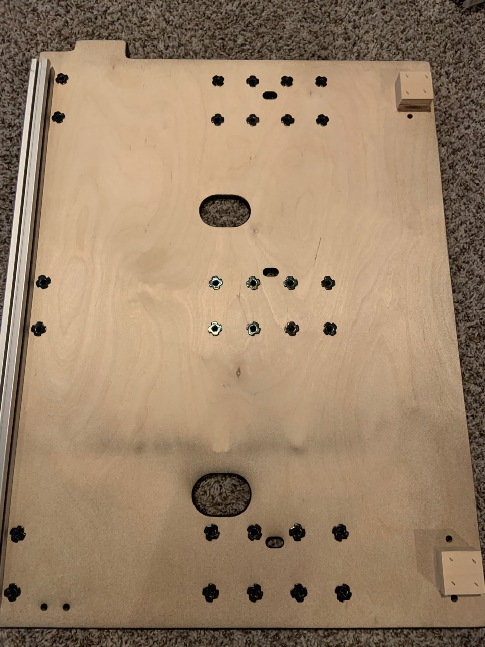

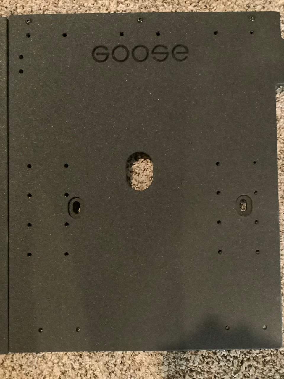

    In all of my searching, I didn't really find anyone talking in-depth about the Goose Gear rear seat delete for the 3rd Gen Tacoma. Also, a lot of pictures I found were from the observer's point of view outside of the truck and in low-light. So, here are some thoughts and photos.
    Firstly, while it may seem expensive--almost $1400--I think the price is worth it, albeit just barely. Obviously this is a niche product and therefore Goose Gear's market segment is incredibly small. Also, the R&D that went into this must have cost a small fortune in terms of labor, prototyping, waste material, etc. So, for those who think, "it's just marine grade plywood and bedliner," while you're not wrong it is an incredibly designed product. With that being said, if you can make your own and you don't mind the "homemade" look, you can certainly achieve something like this for much cheaper.
    The whole kit was very well packed. Actually, I'm kind of surprised that Goose Gear doesn't ship direct-to-home with how light and maneuverable the whole package is. I was expecting a pallet, but the boxes actually fit in the back of my 5 ft. bed with no problem. The box had seen a little abuse, but the parts came out totally unscathed.
    I have a good amount of appreciation for the locking hatches. There is almost no tolerance between the panel and the door which speaks to the quality of the design and manufacturing. Just as well, the locks and the latching mechanisms on the hatches are of very quality. I once saw a thread asking why there was latches on the doors, and my response to that is that any amount of security I can add is worth the cost. While this won't stop a determined thief with an axe or a crowbar, it will at least act as a deterrent. Personally, if I was going to steal something out of a vehicle, I would go for the glovebox and the center console... maybe look under the seats. I'm not taking the risk of breaking into the locked hatches of the seat delete if the truck is parked in an open area.
    The various 1/4-20 threaded inserts that are scattered through out the panel are a nice touch. Personally, I think there could be more, but I'll take what I can get. I also appreciate the ability to use the car seat mounting points that come on the Taco from the factory. In my mind, the more flexibility I have to mount something the better.
    Finally, the hardware came nicely packaged. A quick note is that the shorthand is easily understood and welcome. Originally, I had mistakenly ordered the kit for the non-power window and only after double checking did I realize my mistake. Because I didn't get a shipping manifest nor a receipt from Goose Gear, I relied upon the integrity of the dealer who sold it to me. Once I saw the hardware package labeled "T. 60 PWR BW," I was reasonably confident in the right kit being ordered.

    For the people that have this seat delete, are all those small homes in the panels fitted with threaded inserts to screw on accessories and attachments?
    CenCal805 likes this.
  12. Feb 24, 2023 at 3:31 PM
    CenCal805
    CenCal805 Well-Known Member
    Dec 29, 2015
    #173422
    536
    California
    2016 Tacoma TRD OR AC
    I have the access cab version and yes, the small holes are threaded. I've used several for fridge tie downs and tie down points for cargo.
