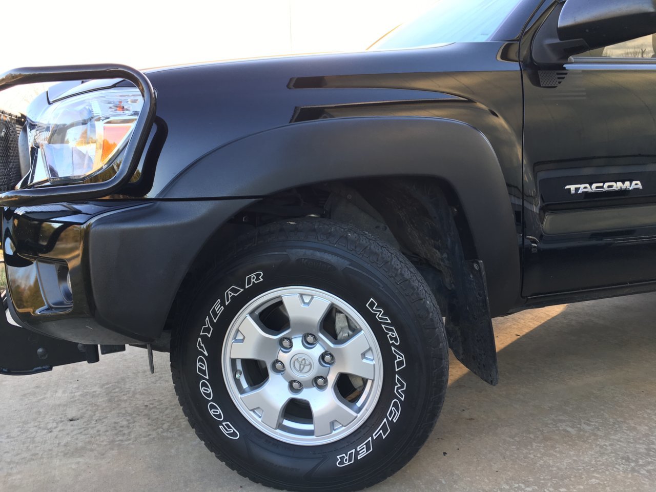

    If you're looking for beefy, don't go with the Goodyear. They are not that aggressive.
    3EBB162E-8C2B-4ACB-9542-F148C4872BFA.jpg 40C02308-D204-4418-9EC3-2BB9012404E7.jpg

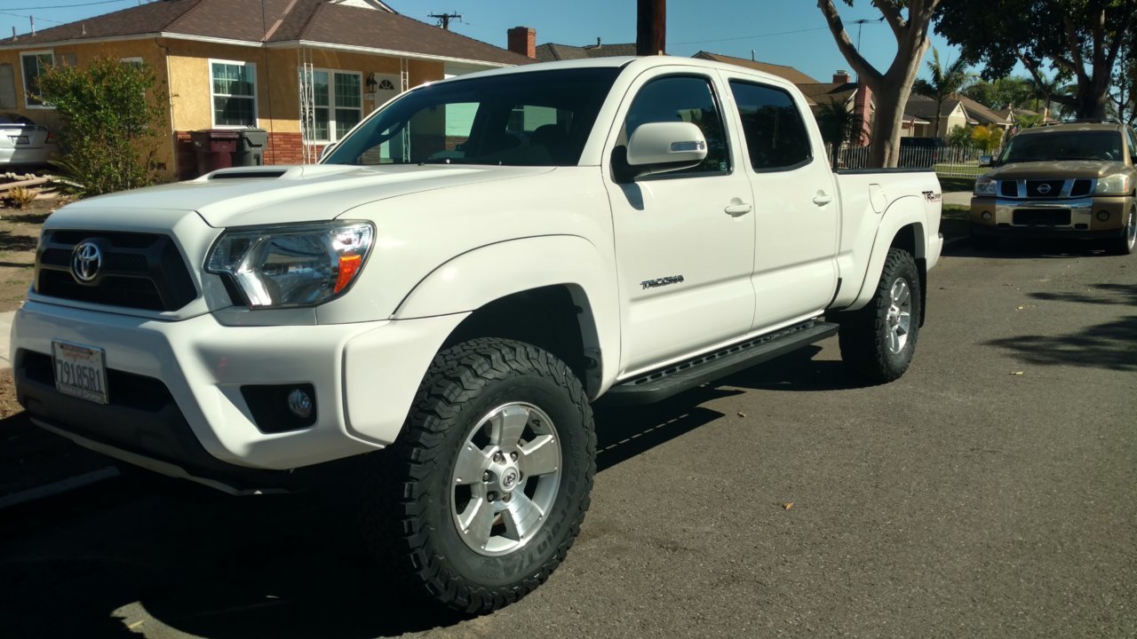

    So here it is, installed 285/70R17 BFgoodrich ko2s on the stock wheels with a 2.5" leveling kit on front and because I got some wheel rubbing on the control arm at full turns I had to put on some 1.25" wheel spacers, got rid of the problem. I did have to remove the front mudflaps theIMG_20180329_083046088.jpg IMG_20180327_142827562_HDR.jpg

    Very Nice! What’s the width on the sports? I know they are 17’s but not sure if x 7’s or 7.5’s! And I know I know I can search for that before someone scolds me for asking! Lol

    Man, I know the Goodyears work ok, but you are right, they don't look beefy. AT3W's are prob my next set.

    They are okay. I wouldn’t have them if they weren’t on the truck when I bought it. I’m leaning towards Firestone destination mt2’s for my next set.
