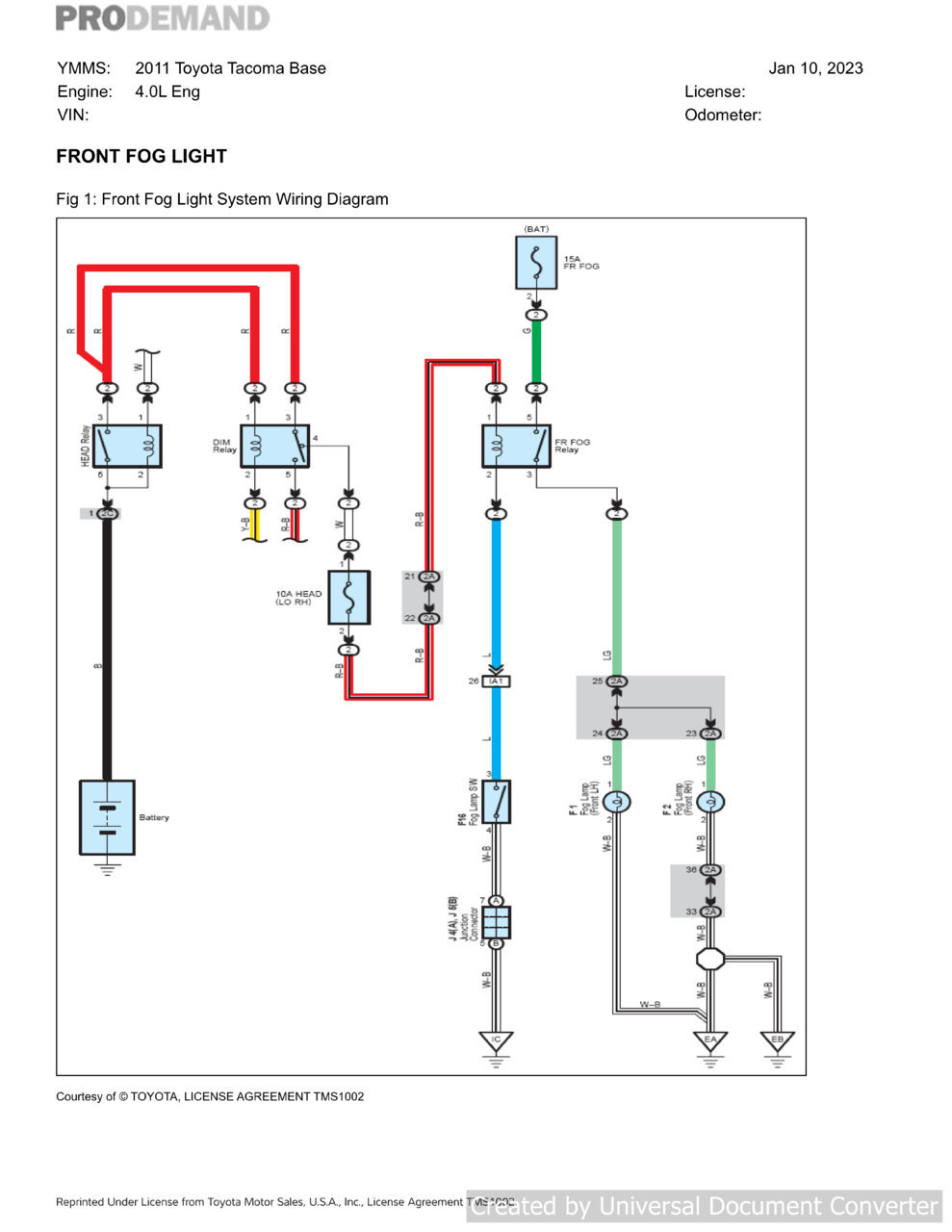

    Need to check pins 1 and 5 of the FR FOG Relay for power with the headlights on low beam and Pin 2 for ground with the Fog Light Switch on.

    Sooo I checked the relay and had no click or anything. I then thought maybe I needed a new switch, so I ordered one. When I went to pop out the old switch I discovered that it WAS NEVER HOOKED UP THE HARNESS IN THE FIRST PLACE!!!! I plugged it back in and the fogs work just fine. So I guess I get to return a switch now. Thanks for the help ya'll. Never would have guessed that the stupid switch was just not hooked up.
