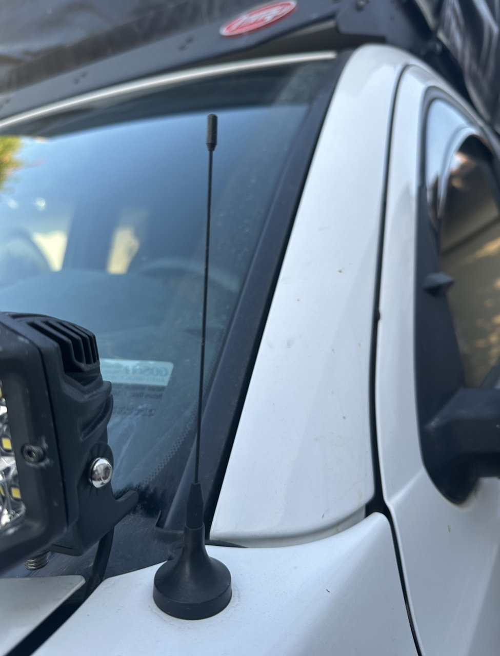

    What kind of mount are you using in that picture? Looks very low profile and clean.

    For the type of use you are talking about, get a 1/4 wave GMRS mag mount antenna, short and sweet. It fits on the fender right next to the A pillar.
    …and don’t use a drill for the final size of a antenna mount hole in a car roof- use it for the pilot hole only and then use a sheet metal knockout punch- they cut a very clean hole without cracking the paint around it.
