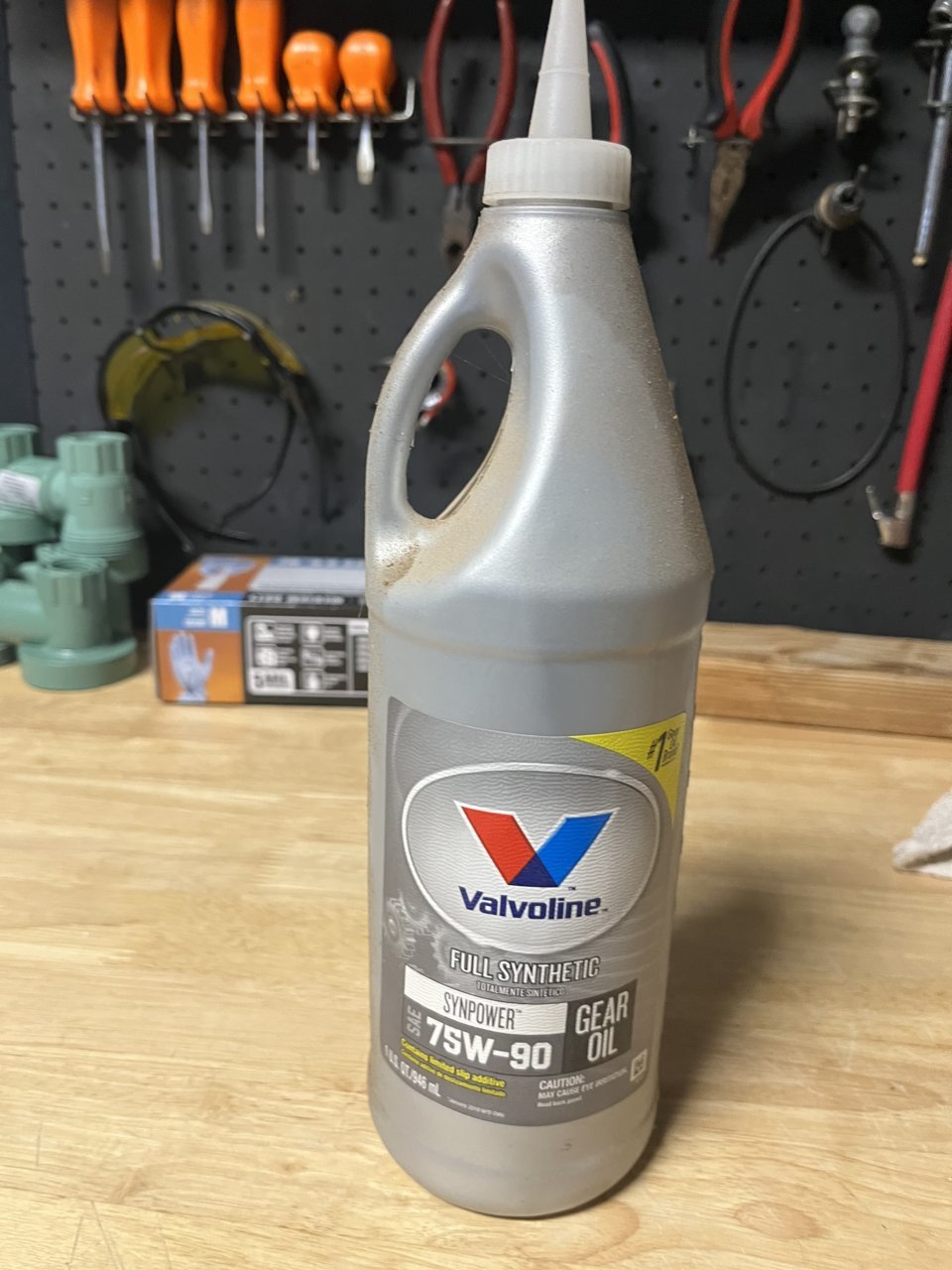

    I've been running this stuff for the last couple years, 30,000. No problems yet but I will report back if any arise.

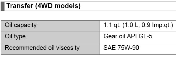

    There are literally millions of 1st gens and 2nd gens running GL5 in the transfer case with no issues (OK maybe 20,000 1st gens still running). From the 2015 Tacoma owner's manual:
    Really the lower viscosity is the reason Toyota changed to the LF fluid for 3rd gens (and 5th gen 4Runners) - Toyota is doing it to eck out the last 0.1 mpg. However, looks like there's some shift actuator timing changes that causes problems in the winter if you use normal viscosity oil.
    Toyota switched to WS ATF in the transfer case in the 2022+ Tundra. 4th gen will likely get the same.
