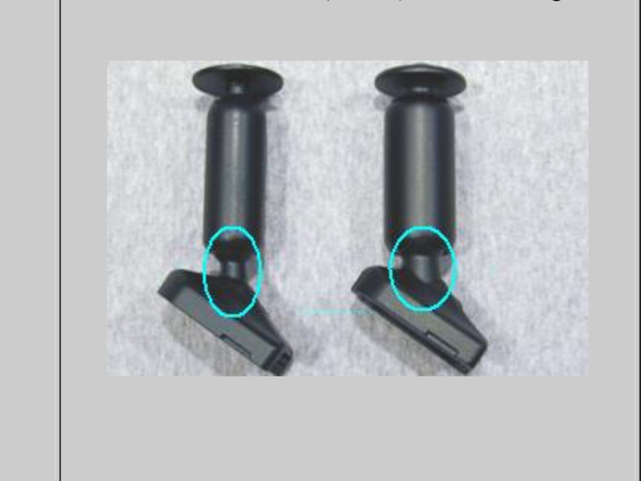

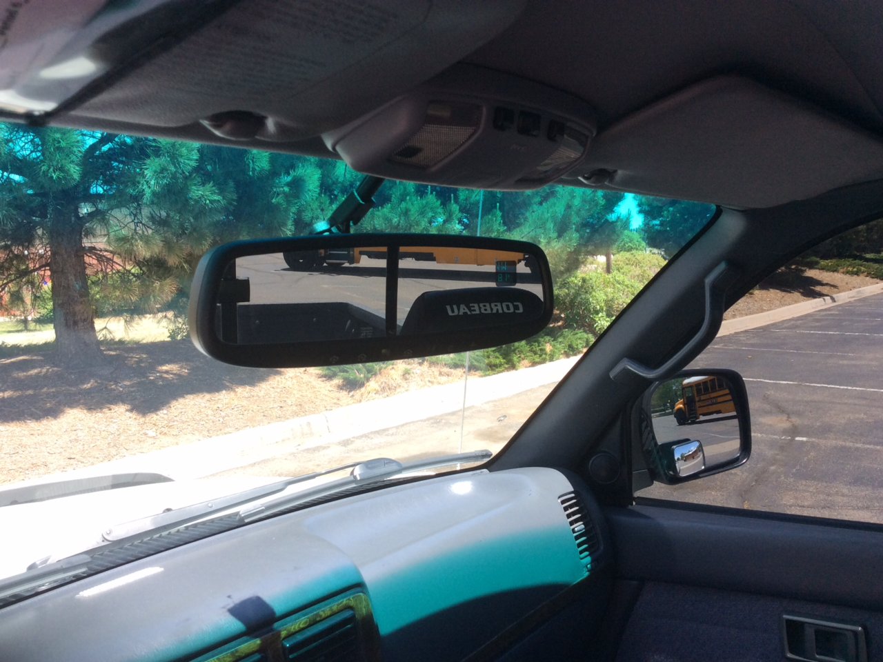

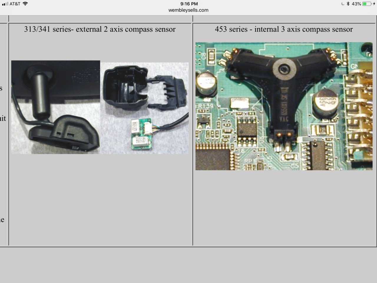

    So here is my 453 mirror of choice for a swap, it’s a newer model and is still
    made today for the newer cars and trucks and some Newer Tacomas I believe.
    These Gentex mirrors may look the same at first glance but are far from that.
    I had a Gentex 177 and this newer 453 model is soooo much better!!!!
    I believe all Gentex mirrors are 10.5” across

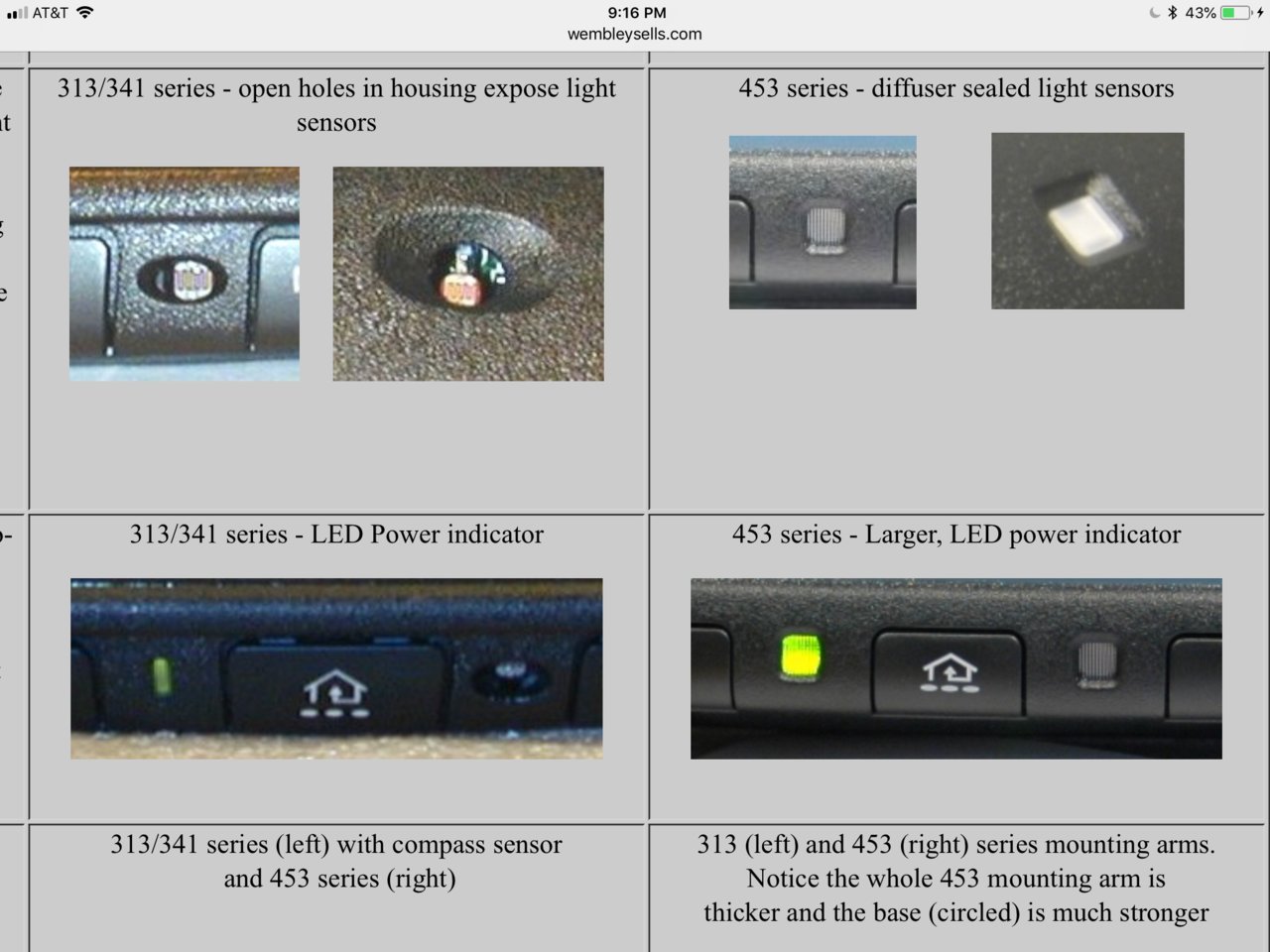

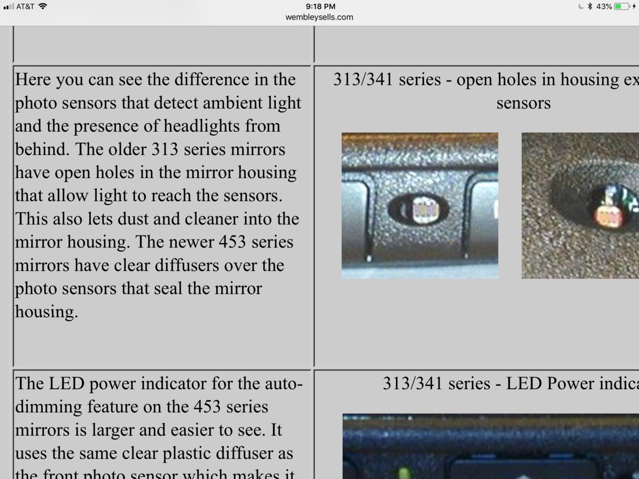

    Below is a comparison of the new style Gentex and the older style.

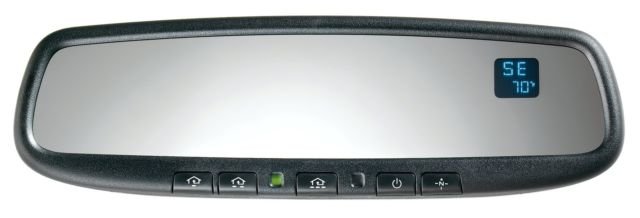

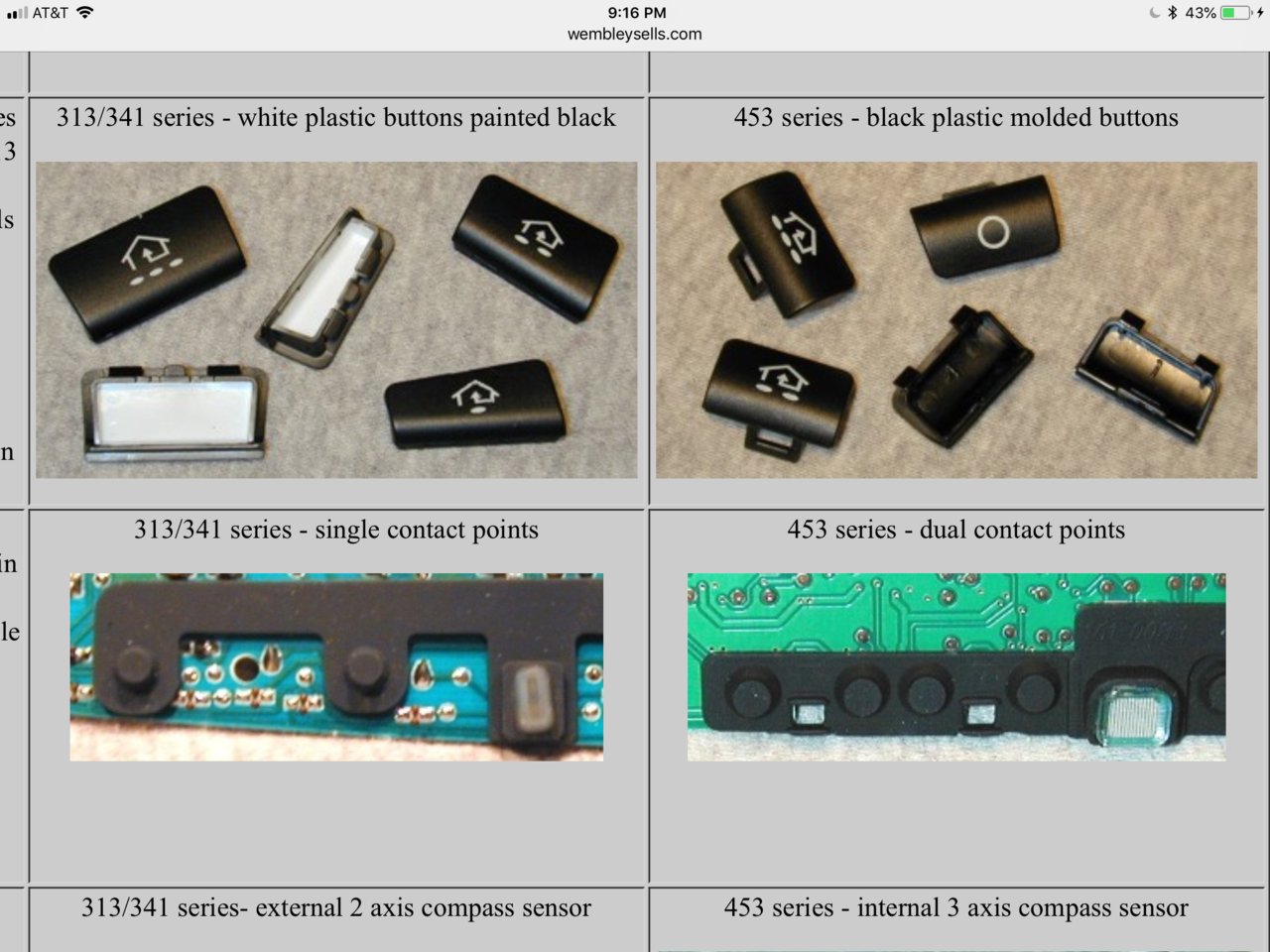

    The 453 plus are
    1) faster auto dimming (rear light glare)
    2) outside temperature
    3) built in compass
    4) 3 homelink buttons
    A) Garage door1, B) Garage door2, C) Community Gate
    Plus of the newer model

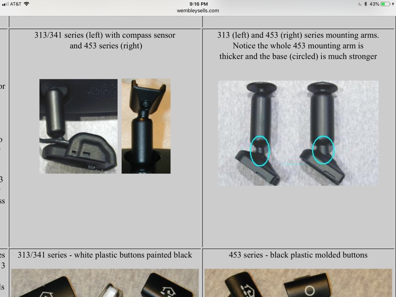

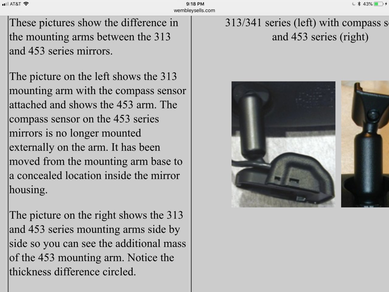

    • Sturdier mirror housing.
    • Sealed photo sensors.
    • Bigger, easily visible power indicator.
    • Heavy duty mounting arm.

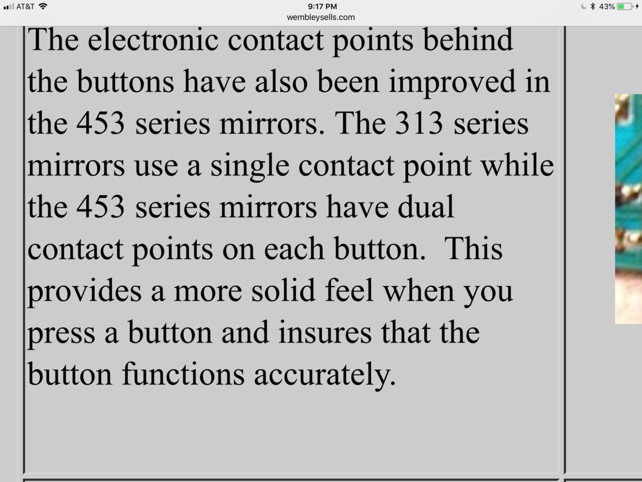

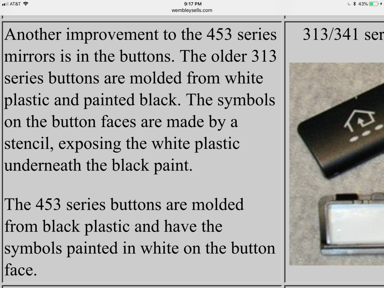

    • Improved buttons - molded from black plastic, dual contact points, more solid feel.

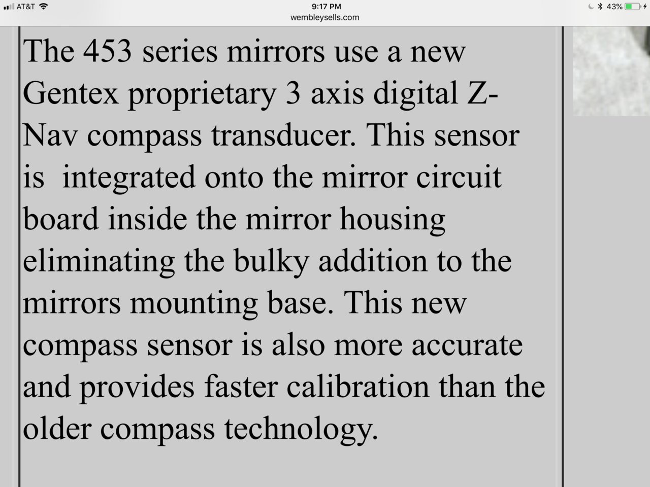

    • Internal compass sensor with Z-Nav compass technology providing faster, more accurate heading indication and calibration.
    • Faster, more even dimming.
    This model is one of the newer versions of Gentex 453.
    It will fit into the 1st gen tacoma without any issues.
    The newer model has an internal compass, not outside exposed.

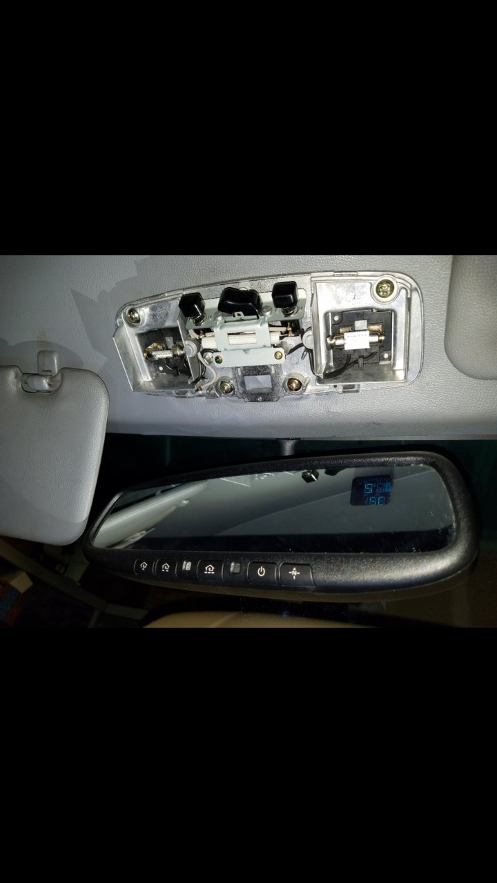

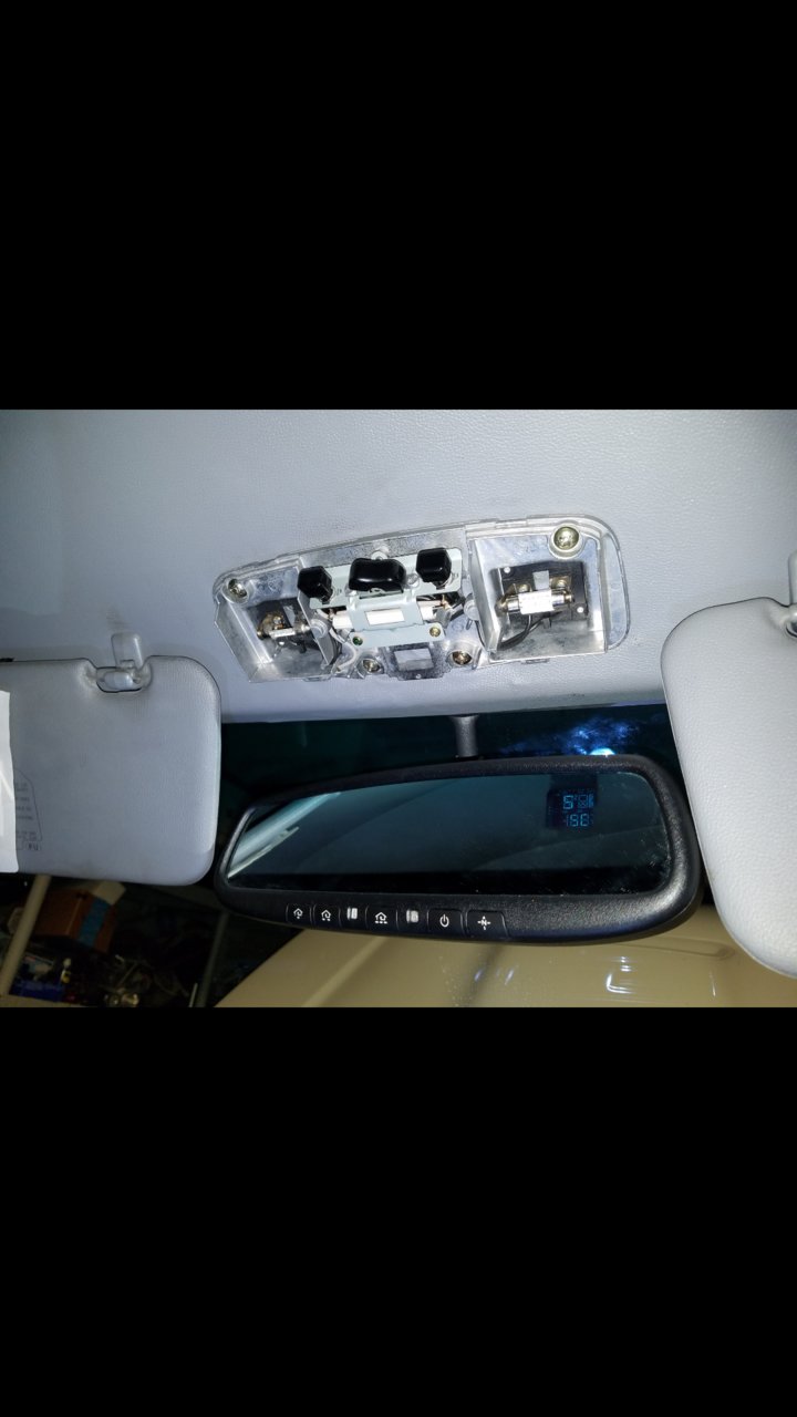

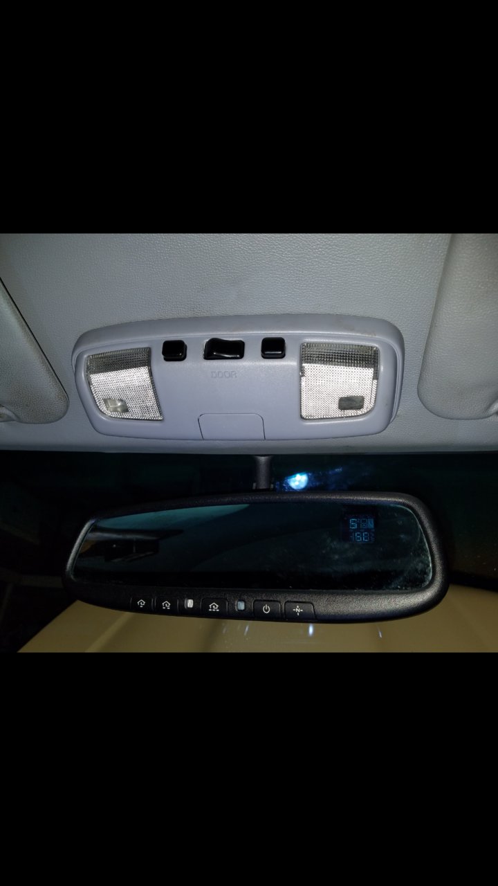

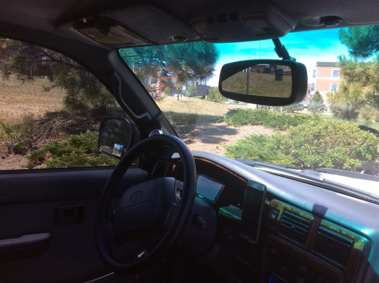

    I did install a 4Runner dual map light as shown a few years ago
    The installation is as follows.

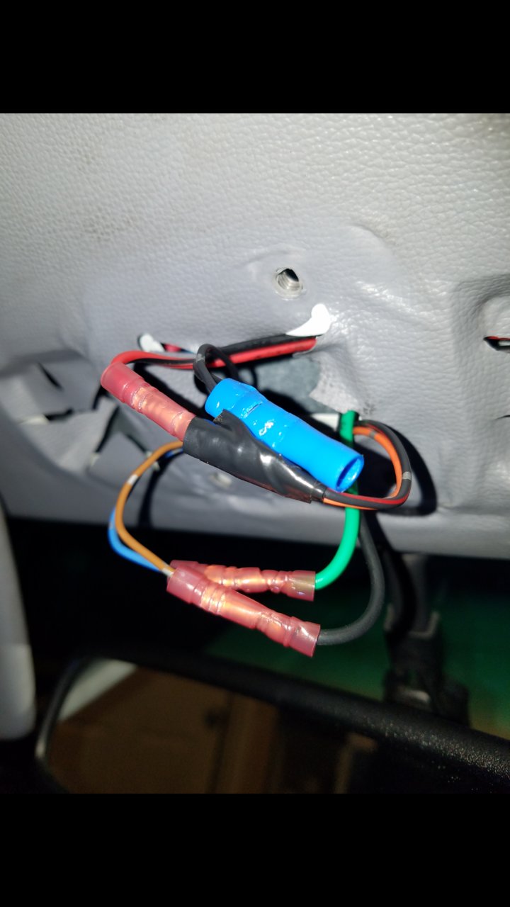

    Make sure the key is out of the ignition and there’s no power to the accessories so no shorts happen during installation.
    The mirror will use a steel wedge to attach to the windshield.
    You will need to run the wires from the mirror in between the headliner to the map light area.
    Leave a bit extra wire for the final adjustment and location for setting the mirror.
    Run two wires to the front of the radiator or bumper by license plate area for the temp sensor on the passenger side through the fire wall.
    I installed my temp sensor next to the license plate as far forward as possible.
    I might look at installation later in the passenger side mirror away from all the engine heat.
    Run two wire +- to the right side pillar and down under to the cigarette lighter power access .
    You will need to remove the plastic pillar panel. The grap bolts might be hard to remove.
    Get an extra large handle screws driver new if possible for a better bit unless there is a bolt used, they used a screw on the earlier trucks and a bolts later. They used some type of glue
    on these, so some might be tough. DONT strip the screw head.
    Ground the neg wire
    Splice the hot wire.
    You are useing the acc power so the mirror will come on and off with the ignition key and the battery will not get drained by the mirror, so don’t use the map light power.
    You will probably need a thin solid steel wire to fish the wires through the headliner to the pillar from the map light location.
    Remove the map light and make your connection at this point for the mirror wires to the power and temp wires.
    Use butt connectors and tape them off, make sure all connections are making strong contact.

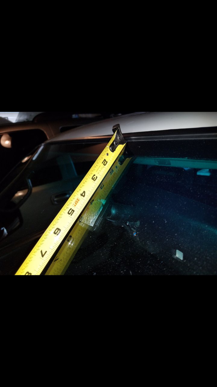

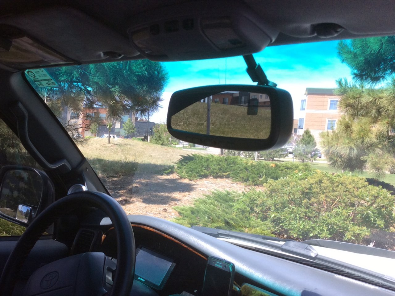

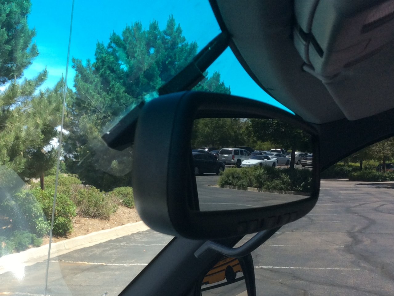

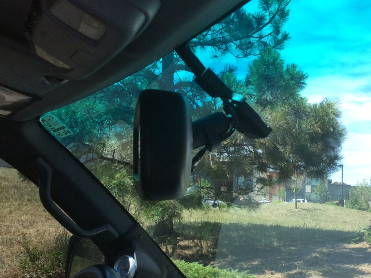

    The wedge needs to be about 4 3/4 to 5” measured from the outside glass trim down as shown
    The wedge has to be placed just perfectly with the mirror at the correct angle for the driver
    so the visors doesn’t hit the mirror.
    This will take a few tries but there is a sweet spot and the visors will not hit the mirror.
    If you are having issues with this or getting the wedge to glue to the shield
    Go to your local windshield companies and most will install it for free.
    I had an issue with the glue and SAFELITE installed the wedge with the mirror, centered it for free for me. I gave the guy a 10.00 tip because it was perfect.
    Lastly cut and fit the plastic wire cover that slips under the headliner(the tabs do) to the mirror slot.
    You have 5 wires
    1) Orange is 12v acc power.
    2) Black/red strip, power for homelink, you can wire these together to run on just ACC
    3) Black solid is ground
    4) Brown
    5) Blue both are for the temp sensor non polorized I believe

    I’m surprised how close the visors are to the mirror, they aren’t even close to hitting in my truck. Maybe it’s a single cab thing?
  3. Jun 7, 2018 at 10:20 PM
    1997tacomav6
    1997tacomav6 [OP] V6 5sp,RegCab,TVS1320 Supercharger,Haltech, 800k
    Oct 5, 2013
    #113940
    10,362
    John
    Denver
    97 reg cab, v6 5sp 300hp supercharged, Methonal Injection, 800,001 plus miles, Original Owner
    V6 5sp,RegCab,TVS1320 Supercharger, 56mm pulley, methanol injected Haltech ECU, AC Tvs1320 supercharger,(MUST DO) every 125,000- 150,000 needs rebuild Projector headlights HID 5 speed manual Amsoil for all drive train Smaller 56mm custom pulley, (MUST DO) 2004 DESNO fuel injectors, zero ping ping, 2004 side door mirrors Dick Cepek Rims, Michelin tires LTX, ATM Pathfinders Dynopro ATM ( that last 100,000 miles) Now running Dynopro ATM mud and snow tires KN cold air intake Cat back dual exhaust with ss exhaust tip, Raised exhaust tail pipe to 2" below body line Optima*dry cell battery,red top Alpine sirius radio, 200 watt amp, focal is165 split door pod speakers Focal door speakers Subwoffer behind seat Viper alarm, Electric Locks Dark tinted windows, bucket seats corbeau lg1 Tacoma Rubber floor mats TRD fender extenders, Bilstien shocks, King shocks JBA UCA trailer iv hitch, electric brake control, Drilled slotted brakes, High carbon steel (MUST DO) EBS green stuff 7000 series pads(MUST DO) TRD engine oil cap TRD stick shift, Marlin crawl shift kit. Rear sliding window 2002 4Runner functional hood scoop cut into Tacoma hood, 4Runner dual overhead map light Gentex Auto dim + Compass + Temp, garage,rearview mirror Snow Methonal kit stage 2 Custom 3 core aluminum radiator Linex bed liner Haltech stand alone ECU, Intake supercharger gauge. Stainless steel brake lines, Custom leather wrapped steering wheel, Haltech stand-alone ECU,
    Mmm it might be how far down the wedge is placed or how high, all the Gentex are 10.5” across

    Mine is to high and the visors hit my mirror.

    With The location of the wedge I have shown here, neither visor hits the mirror. I’m guess it might also depend on the length of the mirror mounting arm too, not sure, but I had no issues with the older Gentex 177 or this model Gentex 453. The mirror body’s and mounting arm are almost the same.
