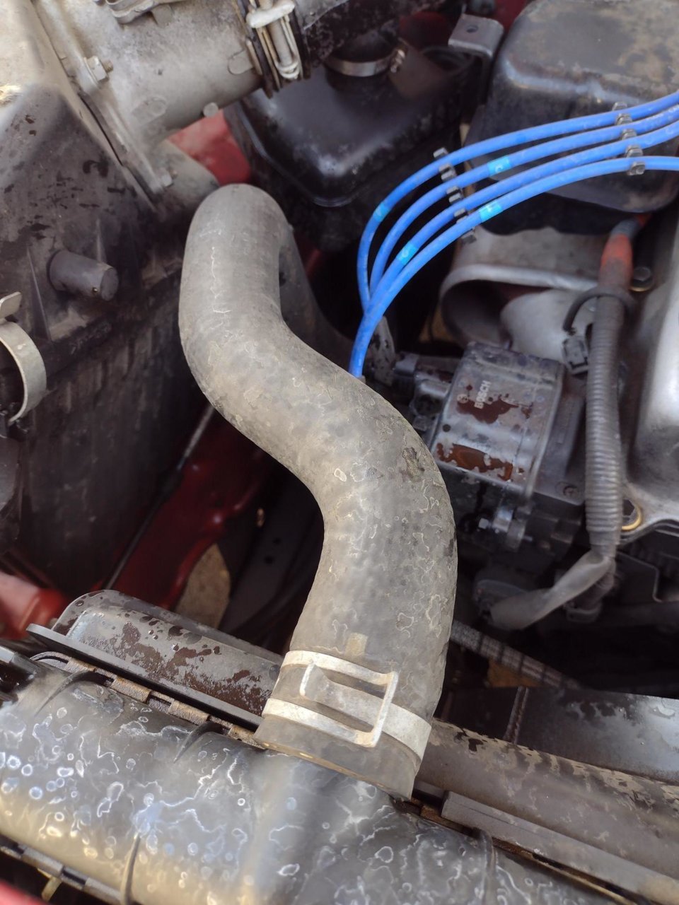

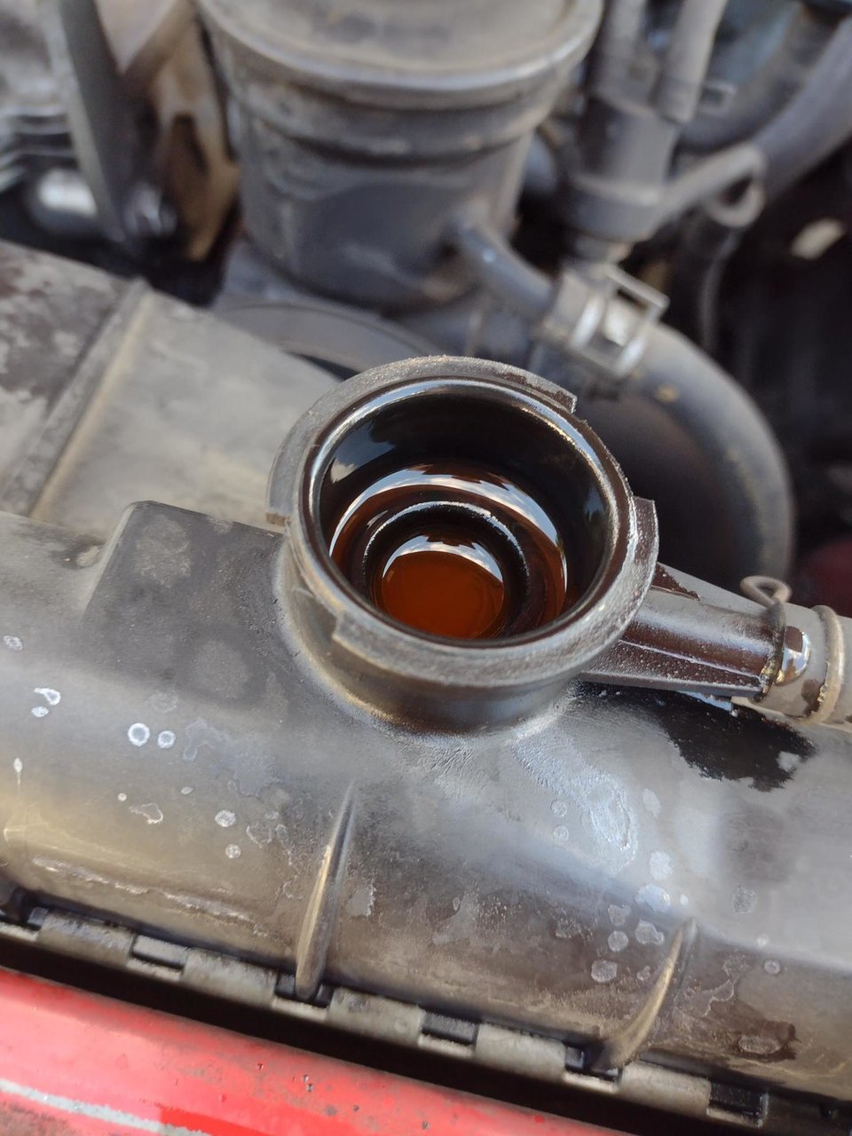

    FINAL UPDATE: Drove to NAPPA and found out:
    1) There is a hairline crack at the top of the radiator (see photo).
    2) Return hose was still ice cold, which means thermostat frozen shut.
    3) It was not "snowin' and blowin' antifreeze, just small leaks at the top & bottom.

    IF it was a bad hose....always at the clamp....it would just drip down.
    With it being sprayed....most likely there is a small crack around the hot hose area on the plastic part of the radiator...
    that's where they get the most heat stress.
    ON 2.4/2.7 this is a super easy job.
    I would recommend putting in a new thermostat at the same time.
    If that was sticking, that could of accelerated the failure.
    these radiator hoses are the devil....they can leak in between the plys right at the clamp.....again they'll just continue to drip after you cut off the engine...
    That top hot hose I replace it every three years.
    These plastic hybrid radiators are complete junk.....kinda like that starter cartridge you get with a printer...
    Probably one of denso's best sellers....they're half or a third the price of a real one....
    avg life is 5 or 6 years. If you use their red coolant, they've got you locked in...
    Reminds me of the plastic water by-pass pipes they start using on the early 2000's model....
    Reason so many of these are sitting in barns.....waiting on a head gasket.....

    After looking at that again.....the leak could be from anywhere.
    check that cap and around that hose....
    Most likely tho, its leaking on the crimp right below the top return hose.....
    Its that crimp is the reason I dump on these so bad....
    with most here trading these off every few years.....probably no big deal....
