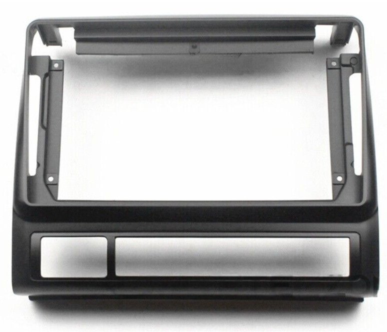

  16. Apr 4, 2023 at 9:23 PM
    #16
    kiwinni
    kiwinni New Member
    Mar 26, 2023
    #421089
    4
    Hey City Taco, I couldn't find the Awsafe 9" on Amazon but found some on eBay. Are these the ones you are using?

  19. Apr 5, 2023 at 3:44 AM
    #19
    CITY TACO
    CITY TACO [OP] Well-Known Member
    Apr 18, 2011
    #55128
    174
    Greater New Brunswick
    15 TRD Barcelona Red
    Kiwinni yes that is the one I tried but when I went to install it in the truck it didn’t work as these plates sit up higher so where it clips into the dash with it attached to the radio it sits down about 1/2 an inch. I tried taking the four dash screws off to push it up but the main body of the radio hits the top of the dash.
    Oh well $20 down the tubes, I stopped off at a junk yard and got one out of a wreck for $30 and am going to try that.
    Nudavinci64 should work unless you have a JBL already and installing a non JBL or vice versa then the audio wouldn’t work. Does your steering wheel control work and backup camera? Had this problem when I went to put the old radio back in and missed a connection on the back of the radio.
