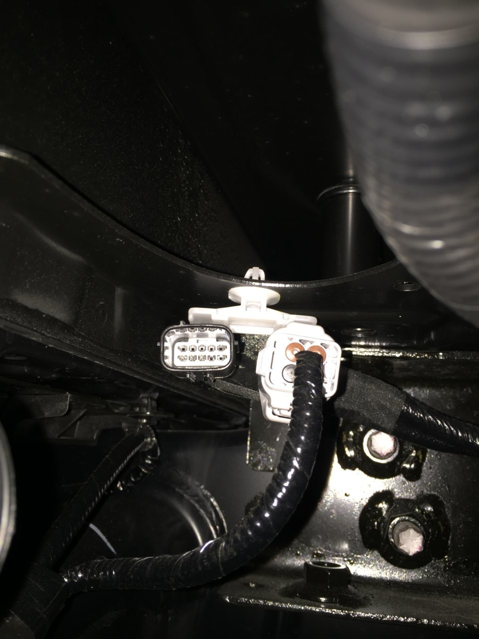

    Have the same question about the mysterious empty plug on drivers side behind rear bumper. Picture is attached. Have a 2019 Tacoma 4cyl 5-speed Auto no tow package. Only want to tow 14' aluminum boat and jet ski short distances. Can and have the ability to install the after market hitch and wiring harness but dang, would be so sweet to plug and play a pigtail from that plug (if that's what its there for) to an OEM connector on the bumper (replaces the plastic plug that's there now).

    in that picture theres 7 open pins in the harness ...im guess thats what its for

    That's what I'm thinking too, but haven't found any sort of firm confirmation. Also haven't found the male end for the pictured connector.
    Here are the parts that go from the 4-pin/7-ping bumper connector to that connector but as stated above, just need the male end of that connector.
    I will test out that empty connector using multi-meter and report back here.
    https://www.etrailer.com/Custom-Fit-Vehicle-Wiring/Hopkins/HM40975-11998.html
