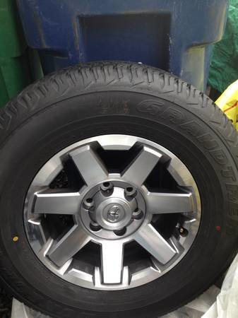

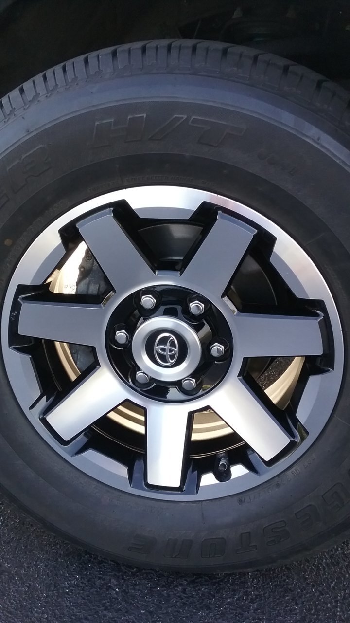

    EDIT: This thread is the official place to post 4Runner TRD OR Trail rim pix and info for the 2nd gen 6 lug Taco. The 3rd gen guys have their own thread with lots of information and pictures. We do too now.
    Post up. :thumbsup:
    Size = 17x7.5
    Offset = 15 mm
    Back spacing = 4.25"
    Weight = 29.2 lbs
    There are 2 versions of this rim. An all silver version and one with the black painted areas between the spokes, lug area and center cap.
    Silver: '14 FJ Cruiser and '14-'16 4Runner Trail Edition
    Silver/black: '17+ 4Runner TRD OR
    The OE 2nd gen sensors will fit fine. I recommend a TPMS service kit to avoid potential leaks from reusing the existing seals. They can be had for about $6 a piece at the dealer. I'm sure there are other sources and options as well.

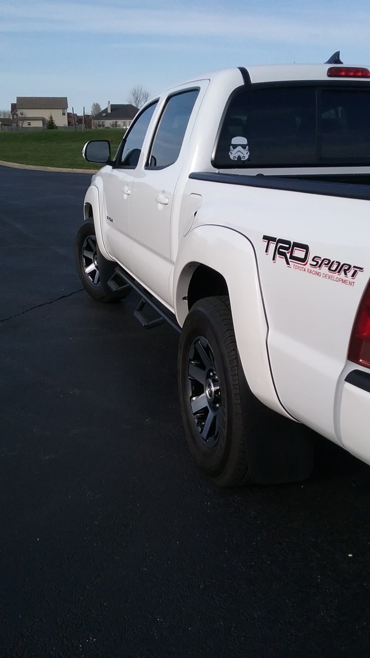

    Have same size tires .. they rubbed.

    What wheel were you running? I know the 4R Trail rim has 15 mms more negative off set. Hoping that will help.
    And you're saying you rubbed on the mudgaurds?

    they're FNs.. 17 x 8.5 -6 .. now I have Ray 10s 17 x 8.5 -10
    both rubbed .. im pretty sure i could have fixed it with a proper alignment but i opt'd for a CMC.

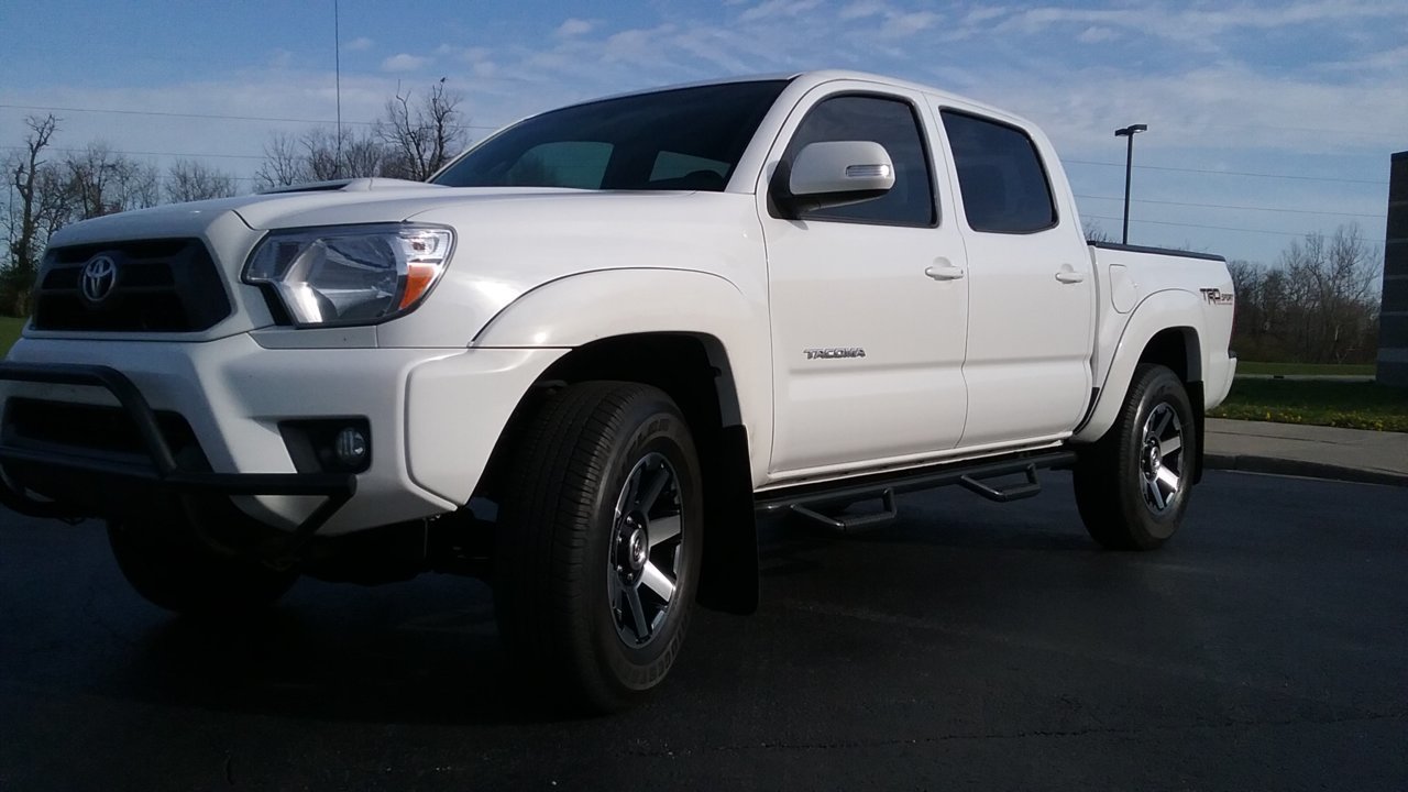

    Zero rubbing with the 265/70/17s. The front mudgaurds were my only concern. I knew the rest would be fine. Liking the additional -15 mm of offset. Tires sit flush now.
    I needed new tires anyway. These wheels/tires only had 5k miles on them and were in new condition. I paid a couple of hundred less for this setup than I would've new tires only.
    Thank you to Tire Discounters for swapping over my sensors and taking my old tires in on trade in lieu of charging me for the service.
    Sorry for the poor lighting and the dirty rig.
    My stockers will have Duratracs on them by the fall for winter use and any light offroading.
