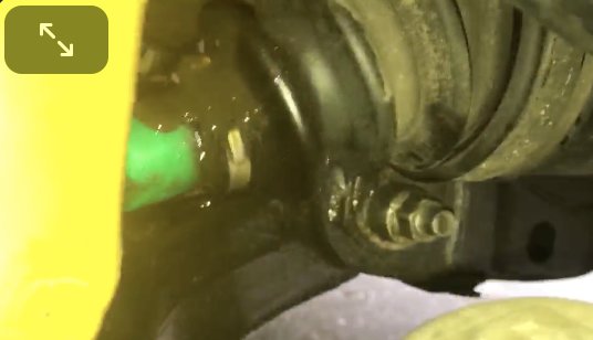

    I recently lifted my truck and noticed that within 24 hours of the lift, my CV boots were leaking grease. I cleaned them off and it seemed that the boots just slid up due to the higher angle and I hadn't had any problems since that time (around 3 weeks ago). Yesterday I was parked on a steep drive and went to move my truck. Once I did, I noticed pretty decent sized puddles of liquid that dripped along the path that my truck took. I looked under the truck and this is what I saw on the passenger CV boot:

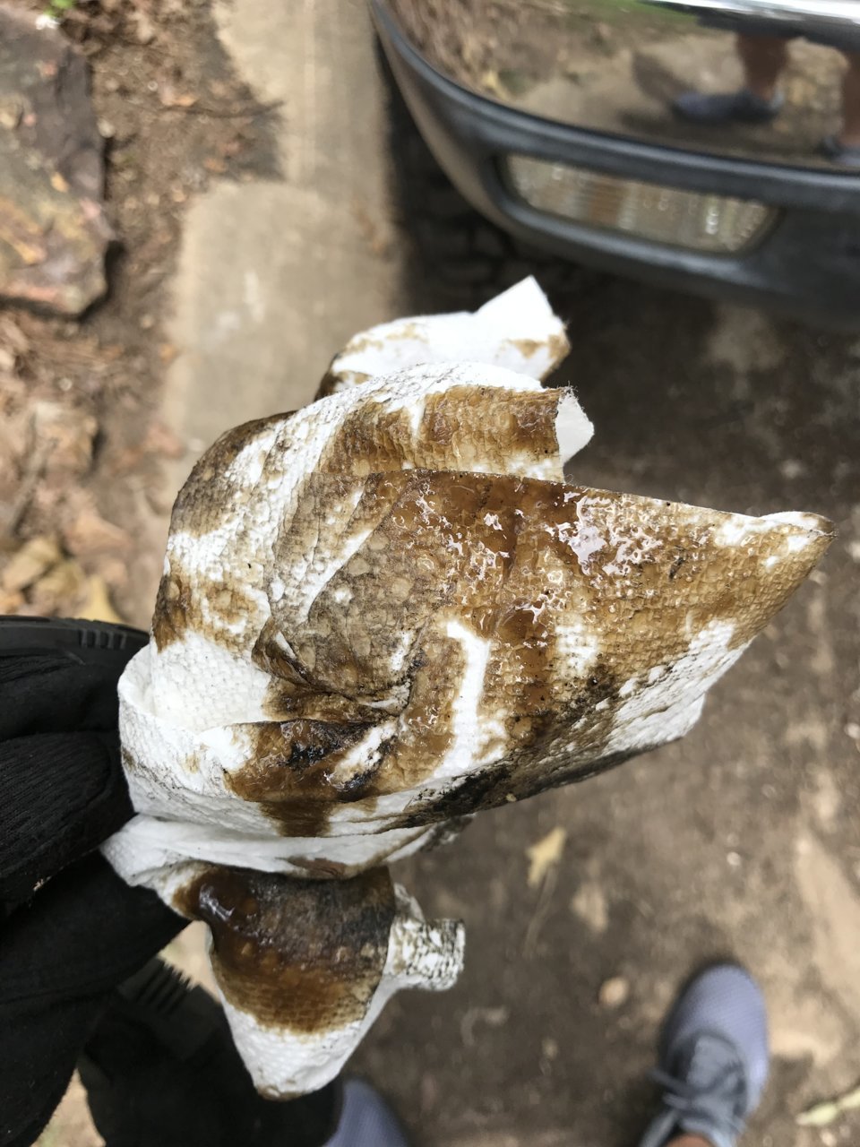

    It looked pretty thin, so I took a paper towel to it and it seems to be diff oil:IMG_5317.jpg I have a few questions.

    Hmm, upon closer look at the pics, looks like it's leaking out of the boot. If it were the axle seal, it would be leaking past the black inner part of the axle that holds the tulip/tripod joint.
    You could always re-clamp the boot. I like to use band clamps. You'll need to get a tool for it, but it's worth it IMO. You can really tighten those suckers down.

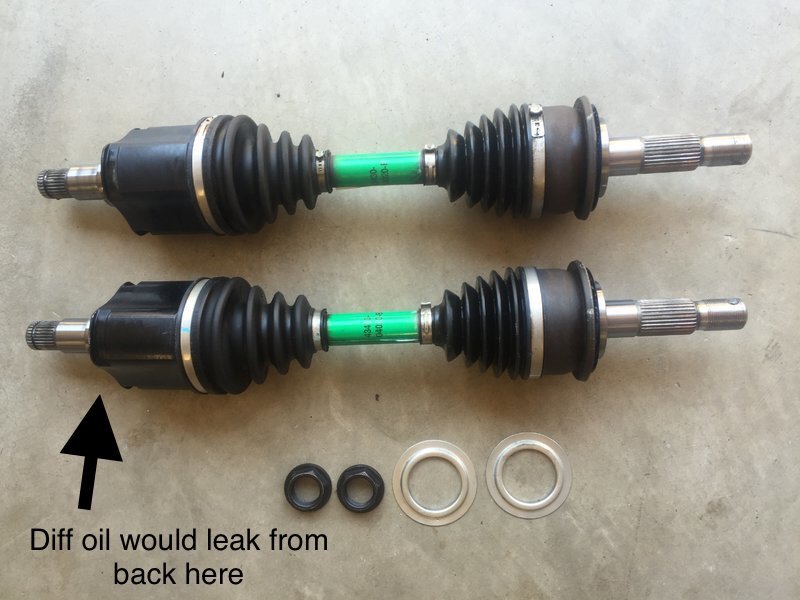

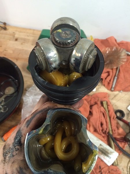

    Correct, the CV has its own grease cavities. The only time oil will leak out will be in between the diff and the tripod joint, where the actual splined part goes in.
    Here's a pic of the grease part. It sits in its own chamber and does not come in contact with the diff parts. The backside of the lower piece (which holds the tulip joint) in the picture below has the splines that go into the diff. That is where oil would leak from if you had an axle seal leak.
