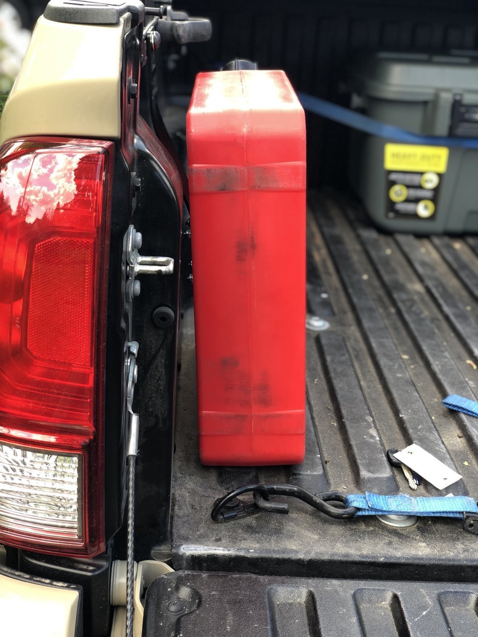

    This is what I ended up doing. It is not super pretty, don't judge.
    https://www.amazon.ca/dp/B07JB74JJS/ref=pe_3034960_236394800_TE_dp_1
    Those D rings are a bit big, but you can still open the compartment if you want.
    I got the rubber straps from Princess Auto, made of the finest Chinesium. $3.50 each. I may cut the ends off to make them look neater.
    So far can has not moved a centimetre, but I might try to restrain it vertically at some point.
    It is a 25 litre can, I carry it mainly to help out other people but it would give me another 166 km of range if I ever needed it.

    Just loop the upper strap through the handle and across the front, and back to the back side.

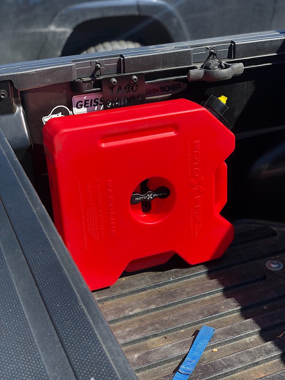

    I have just one small Rotopax mounted but they make bigger tanks and dual mounts.

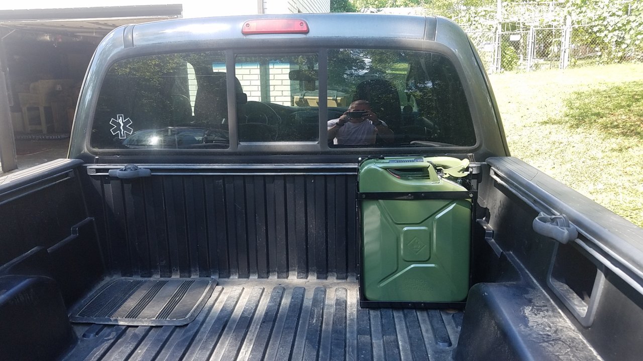

    I ghetto fab'd mine and so far have been pleased. I keep it back there 24/7 unless I'm going through a car wash (not that it would hurt anyway) and cycle the fuel every 3 months while adding a small amount of Seafoam or other stabilizer each time.

    That's not ghetto at all to me! Looks very clean and sturdy.

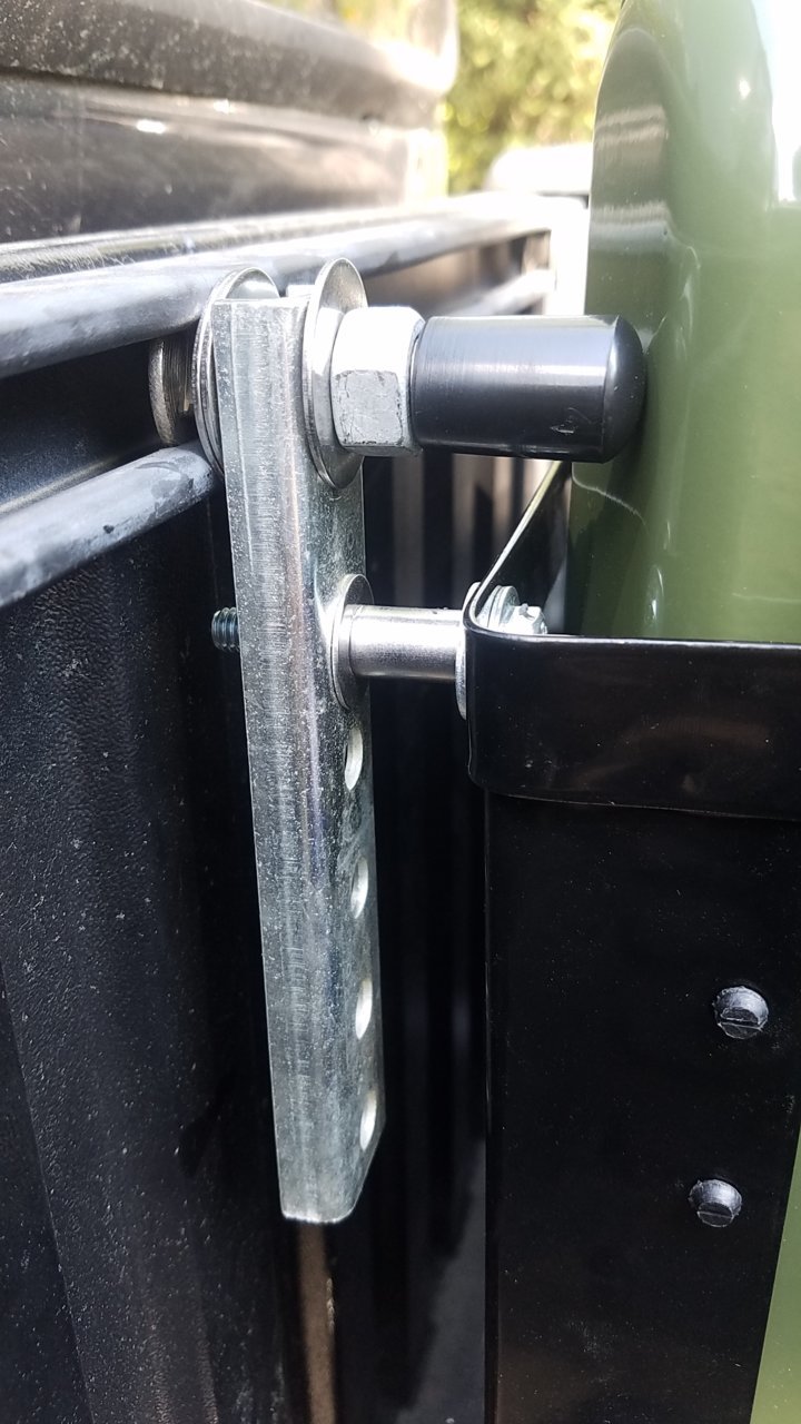

    I used the Rotopax mount and made my own bracket.BA0049D1-111C-490F-AFC2-487D0717BB8E.jpg

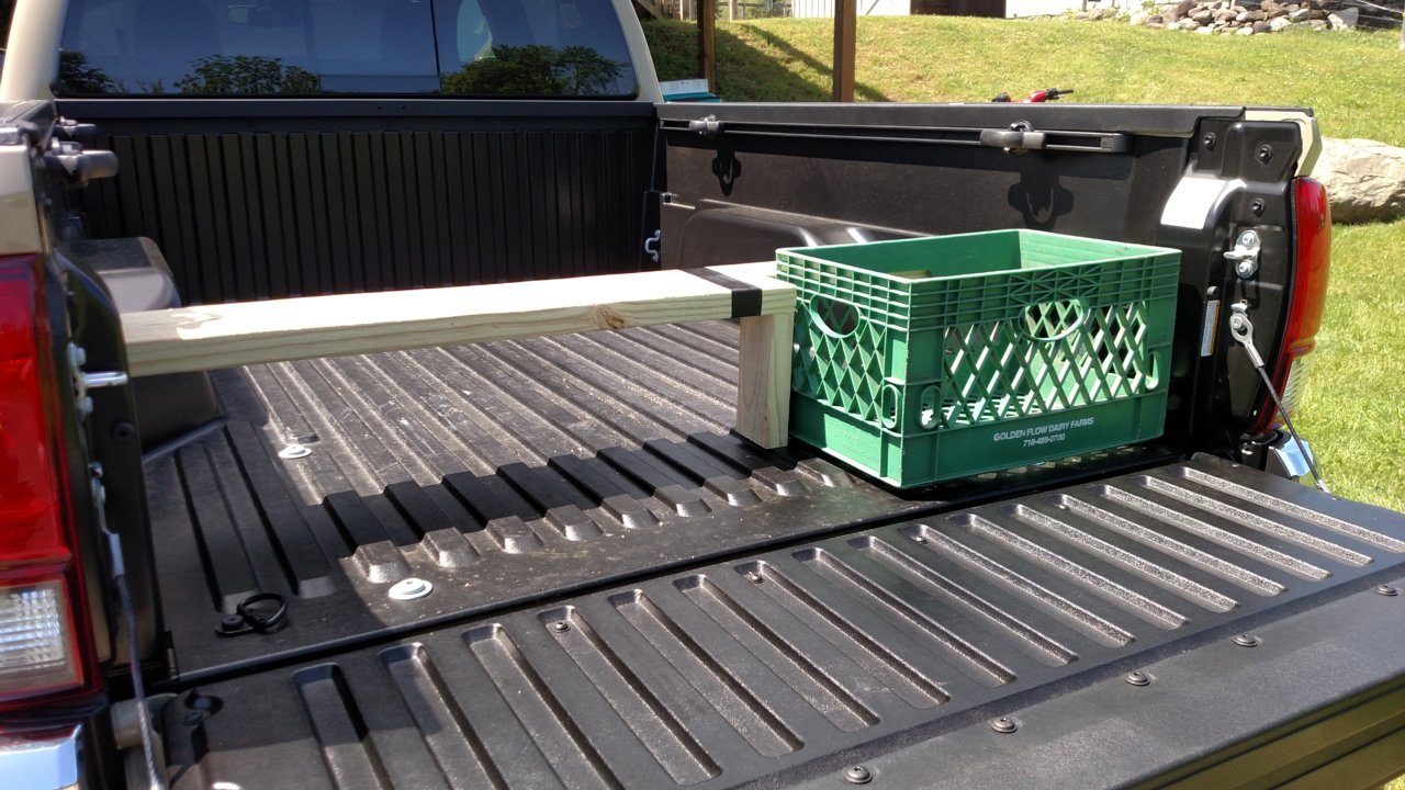

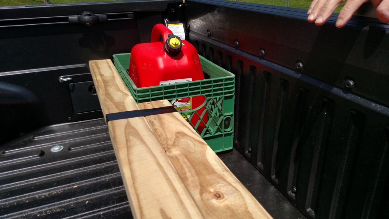

    Another one.. I like this setup for picking up fuel for the lawnmowers or dropping off waste oil..
    Basically, 1 full 2x4, then the one closest to the tailgate cut to the size of your favorite milk crate, screw a vertical leg to it..
    Then, install cargo!
    IMG_20190527_142506678.jpg Both horizontal pieces need to be fastened to each other either temporarily or permanently. Use screws, bungee cord or duct tape. I choose to do it temporarily because sometimes I need 2 full 2x4's across for other jobs. I can switch quickly this way.

    Perfect set up ... I’ll have to figure out your mounting solution...nice job

    I used stainless steel. Works great. Use it mostly for refueling the lawn mower.

    Is that the Smittybuilt jerry can mount? I've heard mixed reviews on whether it's worth it or not with regards to build quality. Your thoughts?
